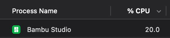

Why is Bambu Studio taking 20%+ CPU cycles while being "dormant"?
This is very suspect to me. Why should this app be taking any cycles when not in proper use, slicing etc? I understand every dormant app will take some resources, but for instance a big heavy app like Fusion 360 is only taking 0.6% CPU cycles? This is on an iMac M1
photo_2026-10-11 21.16.34
Anyone had a similar experience?
The networking module likes to crash on Linux and Mac. Likely that has gone into some kind of blocking loop. Usually you will get the “App has stopped responding” error after a while. You can use the advanced process explorer tools to investigate further.

Tongue-in-cheek conspiracies aside.. you do know that the Networking tool is a separate process right? and that wasn’t eating up CPU cycles..
Studio, LAN-only, idle, 0 to 0.1% CPU here.
Fusion, idle, 0 to 0.4%

Is that with you freshly opening Studio though?
0 to 0.1% CPU within 5 seconds of the last activity, whether freshly opened or opened and active for hours.
The exception is having the Device tab displayed— it is never idle, constantly monitoring temperatures and printer status, or trying to, if the printer is off. Then CPU usage is 7.5-8%.
I would expect CPU usage to be higher in cloud mode.
@Ikraus is on Windows.
Bambu Studio uses some proprietary networking module to talk to the printer, and it has issues on POSIX systems. It will mysteriously crash, hang, or hog the CPU sometimes.
