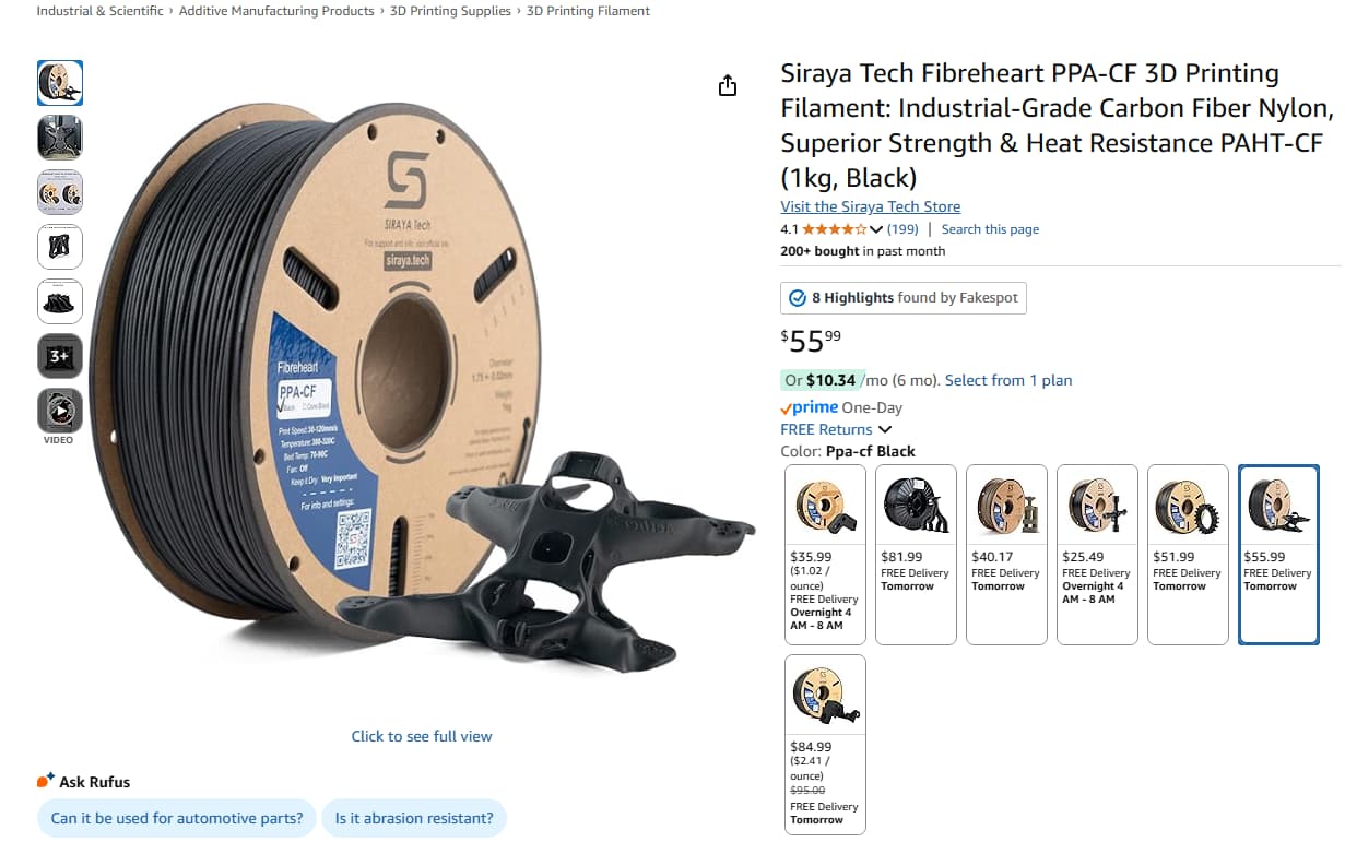

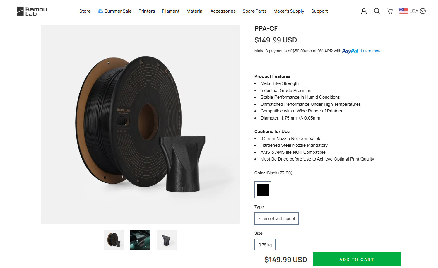

$150 for 0.75kg versus $56/kg from others. Gram for gram, that’s nearly 4x as expensive! Am I overlooking something? Is there something special about it? What, if anything, makes it worth the price?

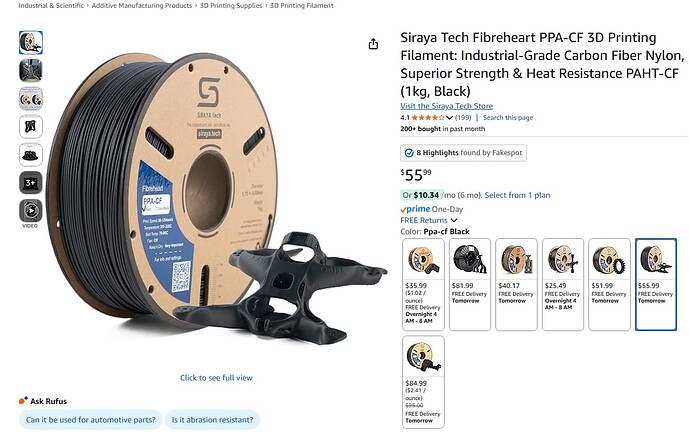

I love Sarayatech filaments but I bet thats just paht-cf. Bambu sells it for $50 for .5 kilo. So, double lol

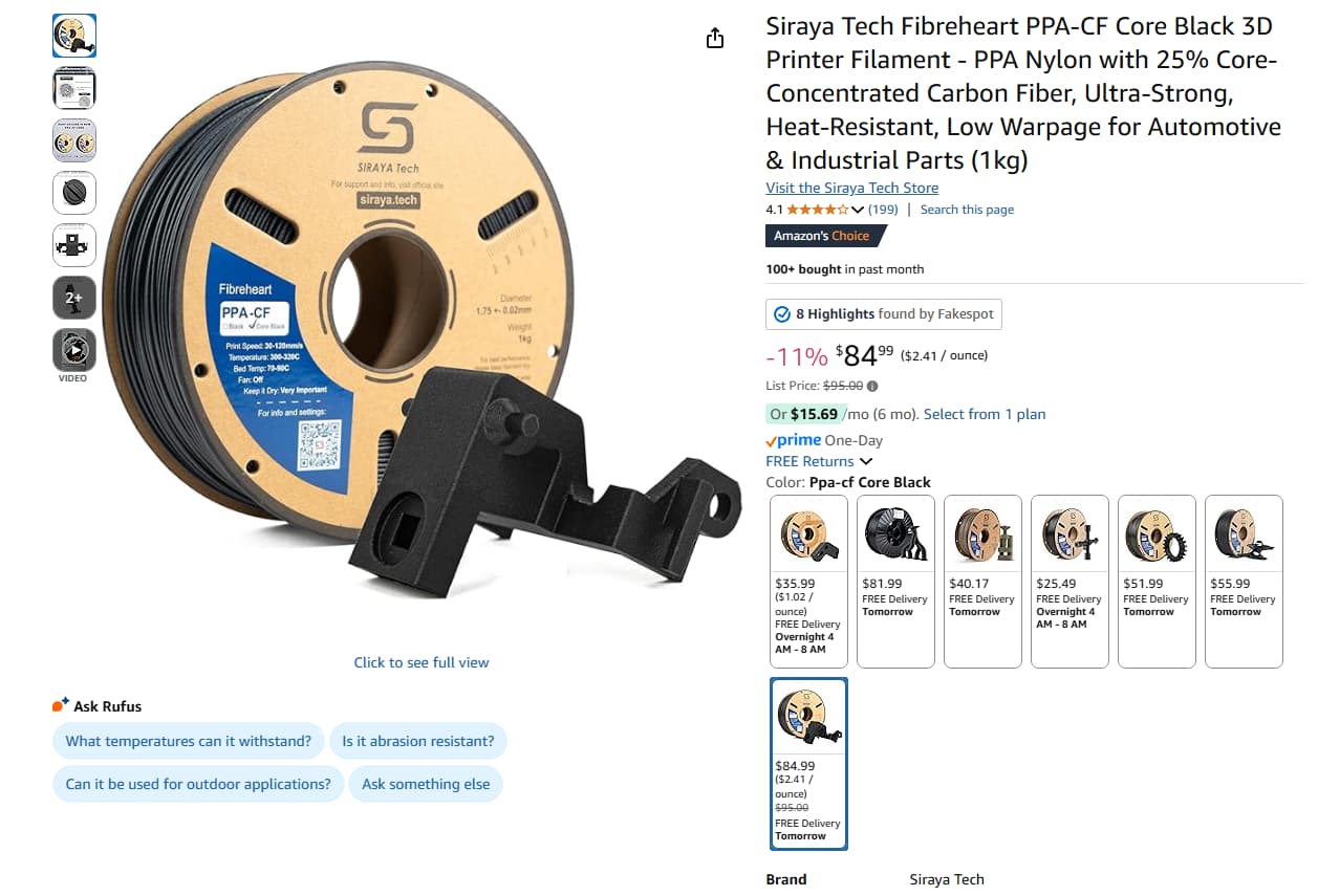

Yeah, I hate the ambiguity of that listing. OK, how about this then?
Surely that would be PPA-CF, not PAHT-CF, right? So, that would put the Bambulab price at 2.32x as much, gram for gram, as compared to Syratech’s premium core version.

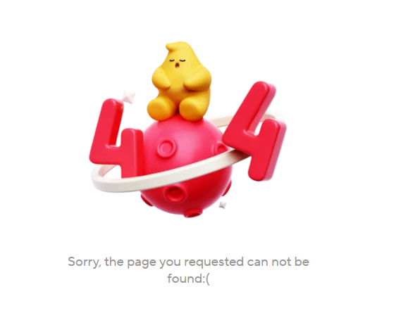

Are you outside the US? For some reason your aliexpress links never resolve for me. I always get:
Screenshot 2025-06-12 122533
and even weirder, when I do my own search on aliexpress for ppa-cf, it only shows me creality ppa-cf, no bambulab. Strange, isn’t it?
Ya im in Canada. Siraya PAHT is PPA. They used to call it PAHT (Nylon High Temp) before bambu came out with PPA, they renamed it after. You can check the TDS and its PPA based.

If it’s made with Polyphthalamide it’s ppa, if it’s made with polyamide it’s pa or paht depending on which polyamide they use.
The siraya tech stuff is made with Polyphthalamide, so it is a true PPA. It’s very good stuff btw. No warping and really stiff, unlike pa-cf
