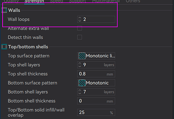

  3. If this is your model. Consider thickening the walls. 3 layers is too thin to get perfection, 5 or more layers is best.
  4. Assuming you have access to the model and can increase the number of walls, do the following steps next:
    – Increase wall loops. This will create more solid walls.
    – Change the default print order from inner/outer to outer/inner. This will lay down the outside layer first giving the filament more time to set up before the next pass.

  2. Increased the wall thickness in my model from 1.5mm to 2mm. Reason i did that is because i thought with an 0.4 nozzle and 2 walls per side i need 4*0.4–> 1.6mm minimum. I does not have much effect in the end. Think because if the Arachne wall generator.
  3. I did already change print order from outer to inner. has some effect but not solve it all.
