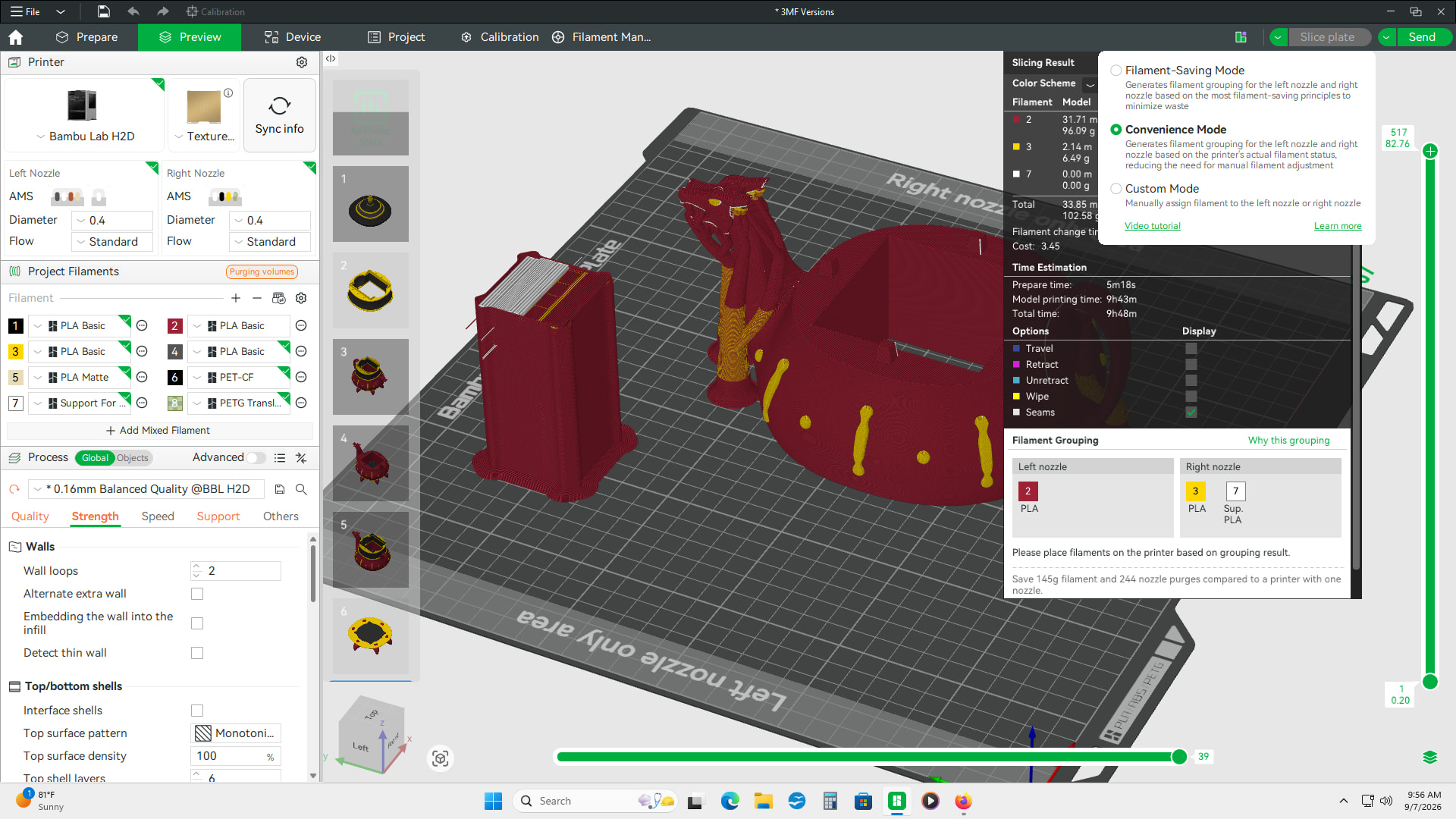

Why is the filament positions ALWAYS wrong nozzle

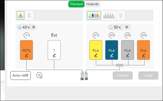

OK, I’ve an H2D, 2 AMS2 and an HT. One AMS2 on each nozzle and the HT on the Left Nozzle.
I sync the filaments, and they show properly. Then I slice. But ALWAYS the filament setup is BACKwards to what is in the machine. I put the support filament in the right AMS and the main material in the left and It will inevitably swap positions. If I happen to swap places, it does the exact opposite. I select convenience mode and it works correctly with ZERO alterations to the material used or the time consumed. (2 color print) It drives me insane. Makes zero sense that the slicer won’t look at where the filaments are and PROPERLY slice under the filament savings mode. Stupid software. Rant off.

BS dude, BS, Left is left, right is right, I have 2500 hours on the printer. AMS with the support is on the left nozzle plain white pla is on the RIght nozzle. It shows in the slicer exactly how it is properly set up at the machine. I have to go in and reslice using convenience mode to get it to slice with the correct placement (what it reads from the machine btw) it is entirely the slicer programming.

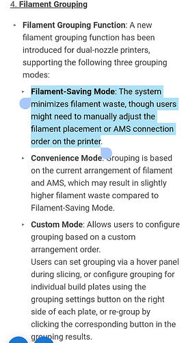

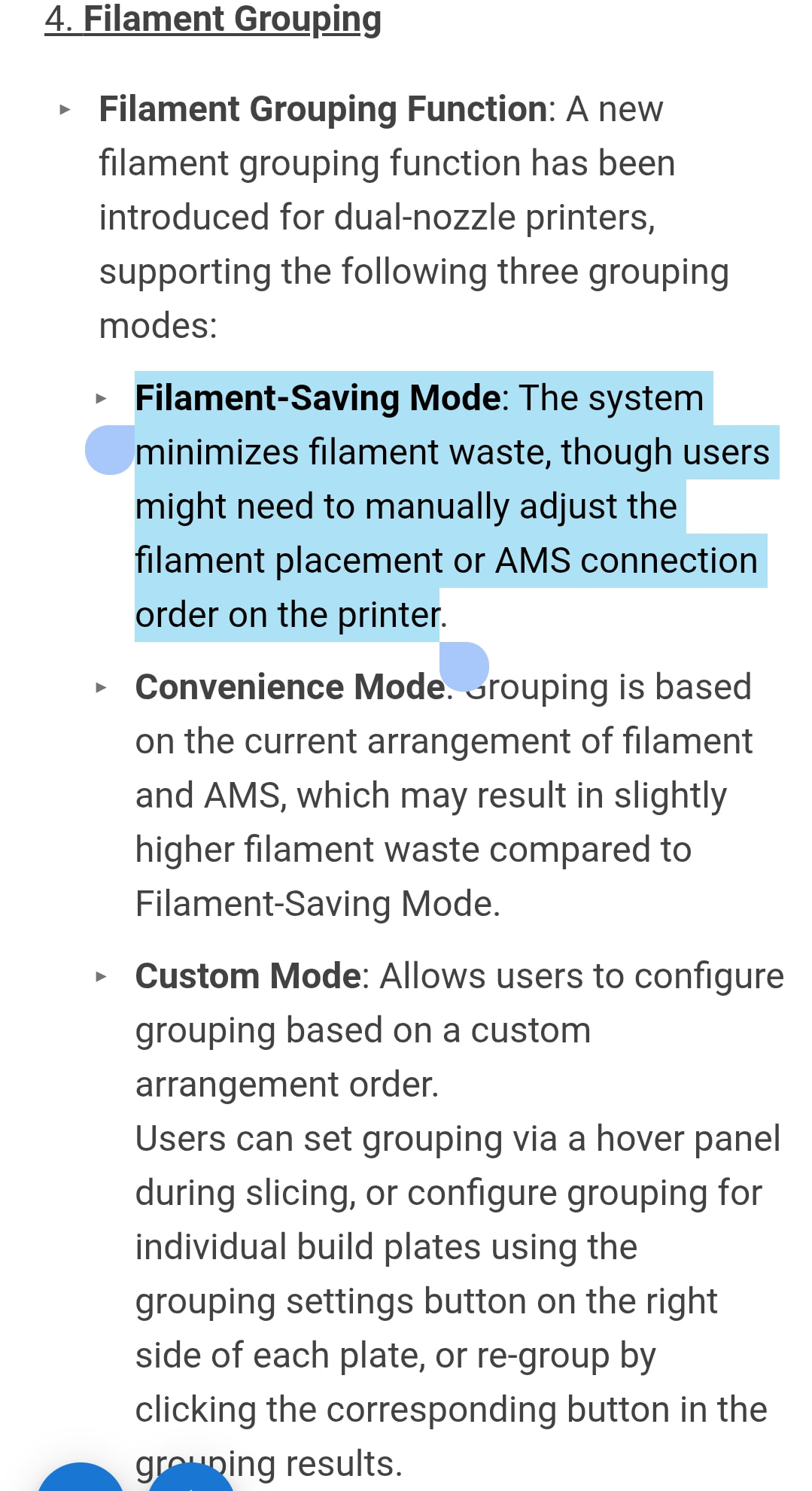

Well, I guess, this happens when using Filament Saving Mode while slicing. As mentioned by @J.lifer, using Convenience Mode the issue is fixed. So the slicer does exactly what it is supposed to do and the little window showing the options states exactly so - using Filament saving mode you have to place the filament accordingly, using Convenience Mode the slicer uses the configuration of the printer.

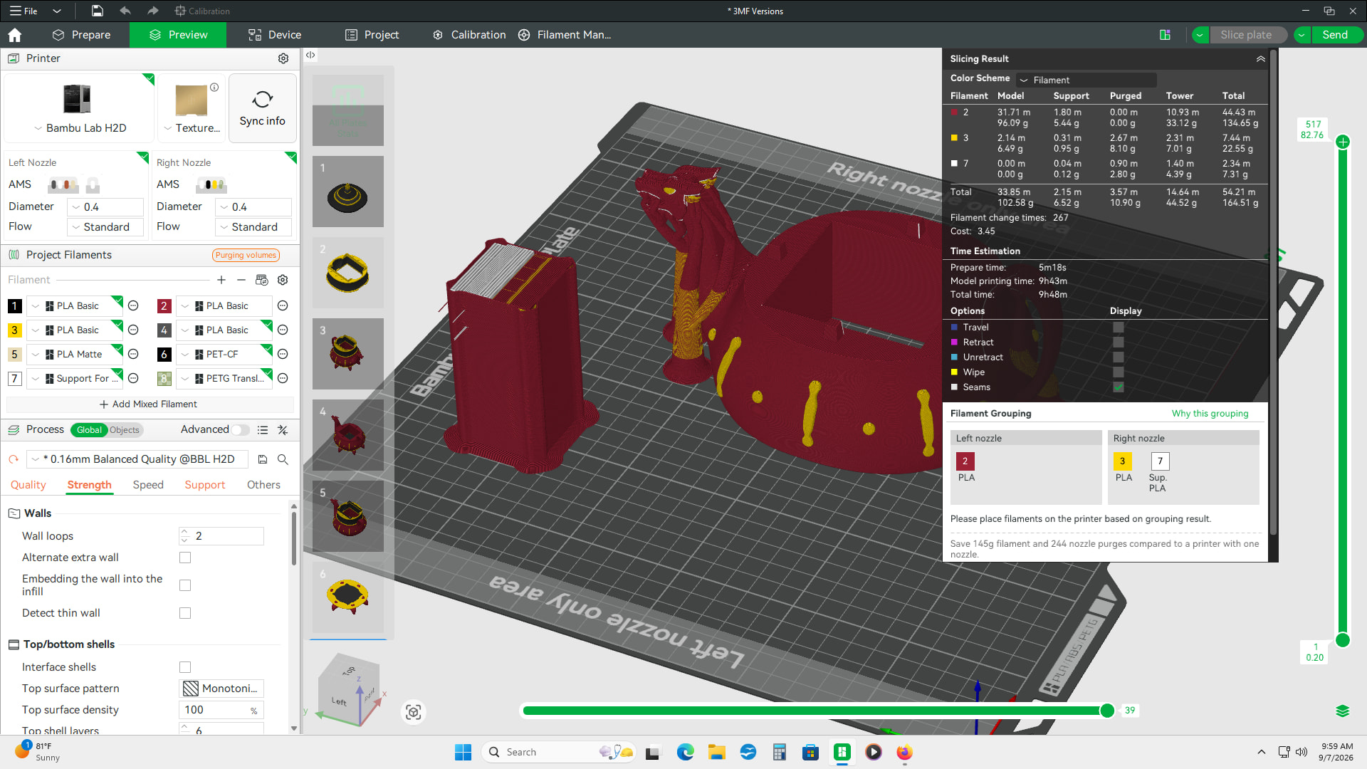

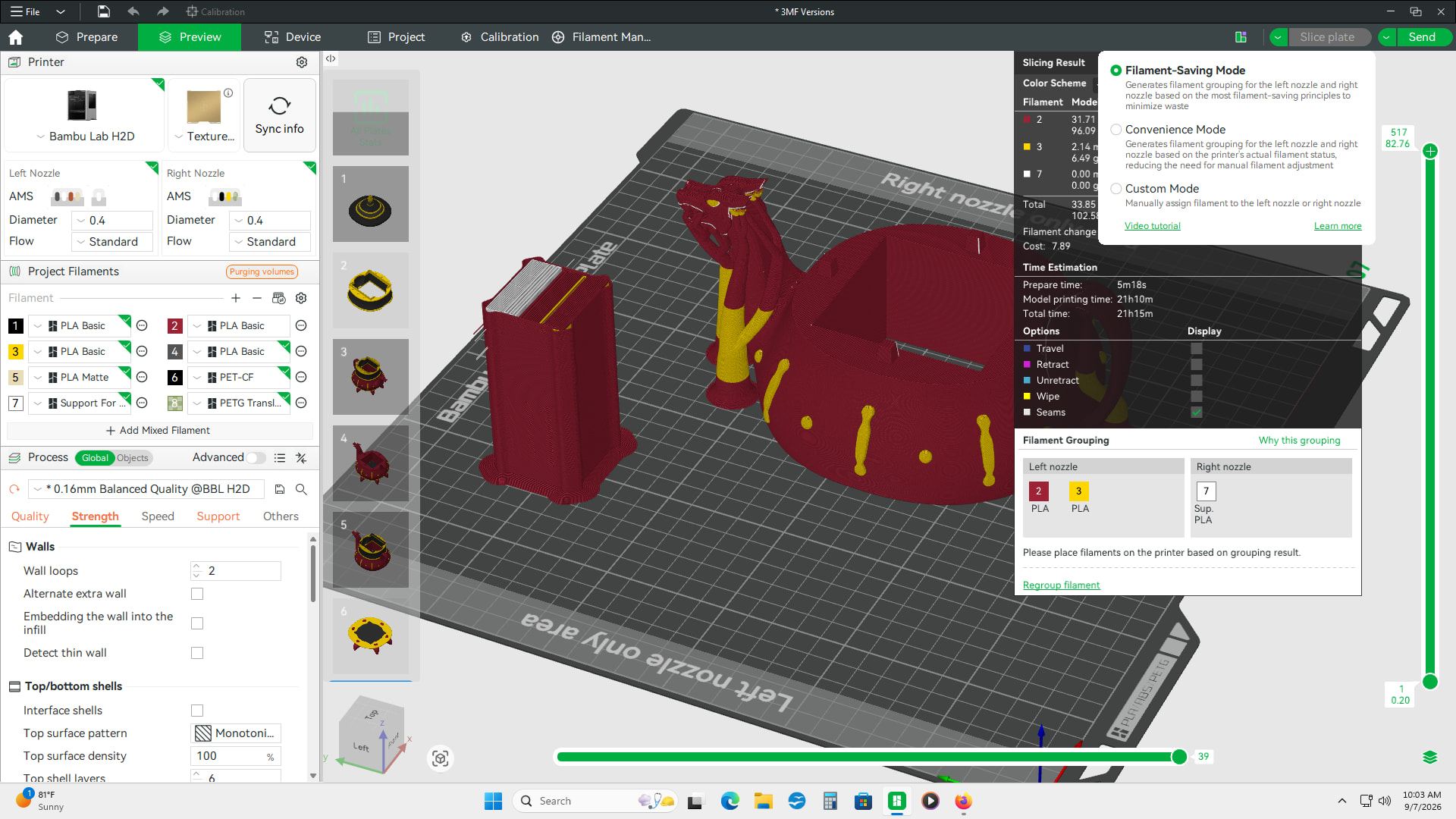

OK, PROOF. First two screen shots are of Convenience Mode. Three filaments. Total used combined is 164.5grams and Sub 10 hour print.

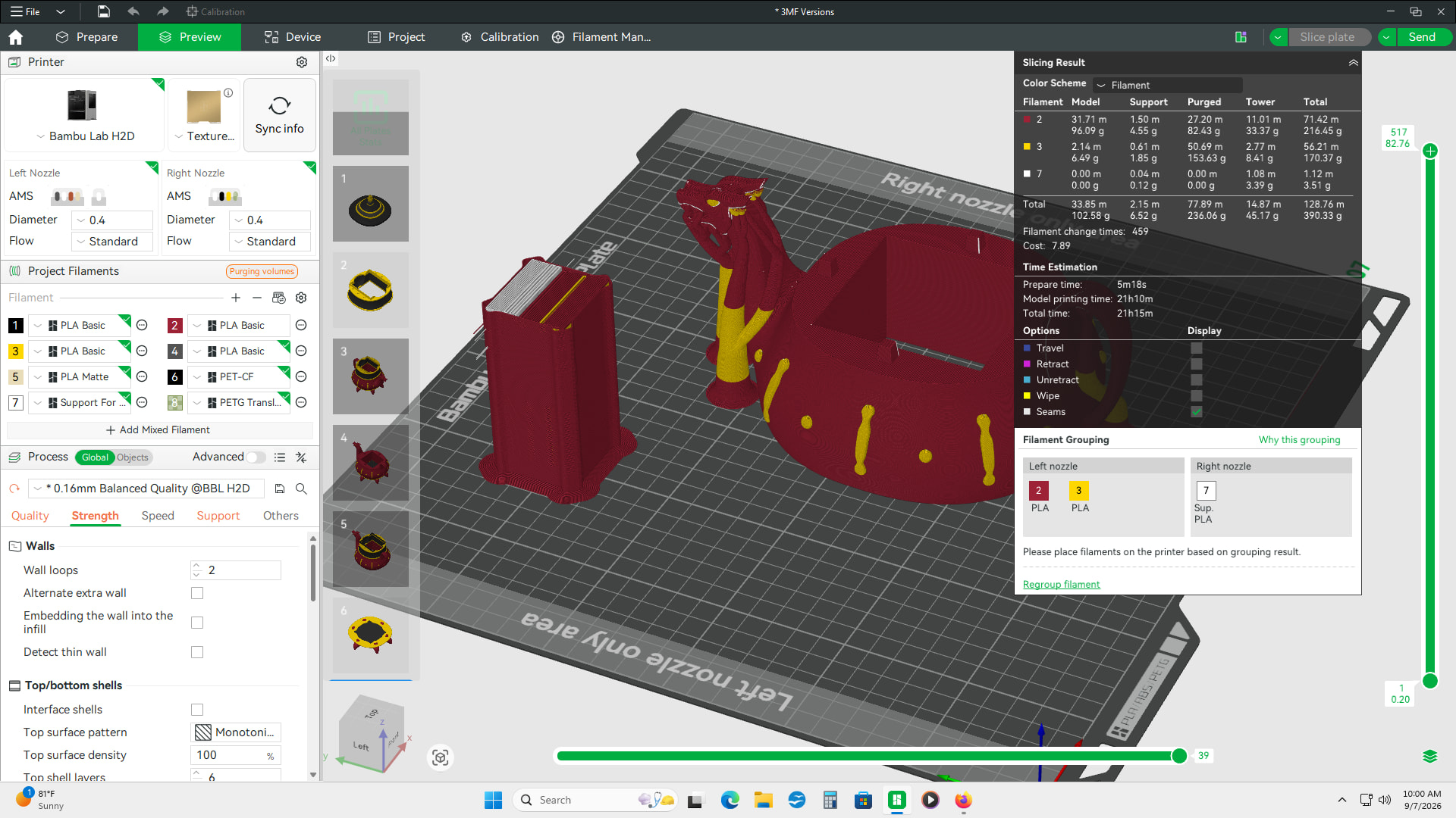

Next is the standard Filament Savings slice
And these two are the supposed filament savings. OVER 21 Hours of print time and 390 gr of filament. That is almost double the filament. and well over 2x the time used. And on this set of models, it happens every slice. STUPID
It is a worthless slice that is not only sub par, it is a disaster
Okay, so there is a bug in the filament savings calculation - but do you agree that the filament savings explanation (it expects you to rearrange filaments in the AMS units) now makes sense, or is there a separate issue there as well?

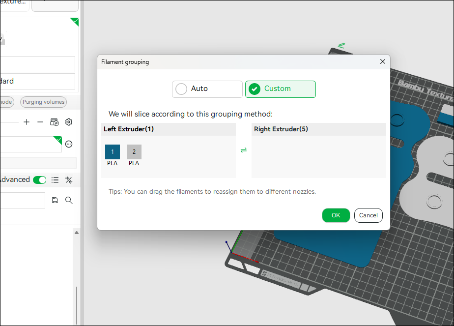

On my H2C, PLA grey and blue on the right nozzle:
Go to custom mode and boom they are auto stuck on the left nozzle lol

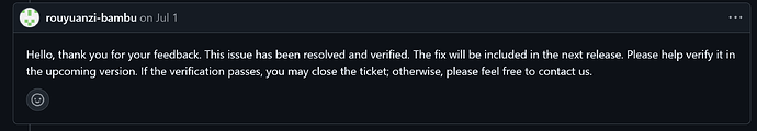

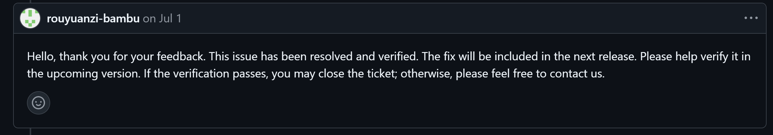

First of all, thank you so much for providing the screenshots - they really helped clarify what’s going on. With that information, I was able to track down the issue on GitHub right away. It turns out to be a bug in the current Slicer software. The bug has already been logged and assigned to a Bambu team member.
Bambu has already released a fix for the H2C devices. For the H2D, the issue remains unresolved, as it was only recently reported.
According to Bambu, the fix is supposed to be included in the next release: Unfortunately, the person who reported the problem hasn’t responded, which is, of course, the worst-case scenario. Quote from a Bambu programmer:
