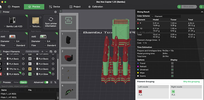

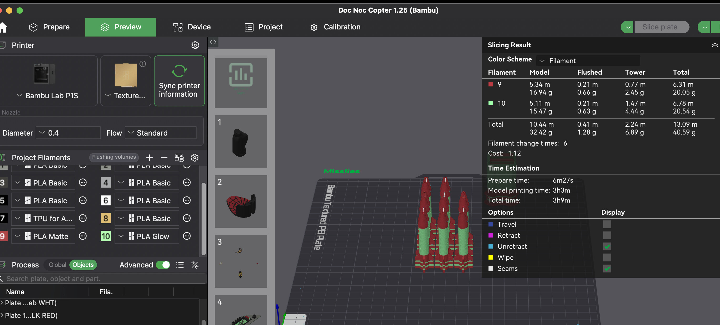

Here’s 2 screenshots of the Helicopter’s magnetic missiles. Everything I’ve shown are things I’m constantly reprinting for Helicopter sales.
P1S 3h9m
H2D 3h19m

Just looking at it, there looks like a purge tower in the H2D slicer window.
I did a multi model, two color print last night and did so without a purge tower by feeding both extruders separately. Turned out great.
Both have a prime tower. The p1s screenshot has the prime tower behind the shaded window. Even though the H2D is dual headed using a prime tower is recommended and the default. Of course it can be disabled and still print well as is done when printing by object.

It’s just a difference in different profiles. The speed H2D can reach is much higher than any other bambu machines. It’s just the default profile that lean towards quality and safety more instead of pure speed.
How do you know that? What in the settings can I change to bring it to P1S speeds?
Sorry, I’ll have to see it to believe it. The top acceleration of the H2D is slower at 8,000 which is the only number that really stands out to me in it speed tab settings.
you can set it to 20000 (maximum), or 10000 to match p1s by default
