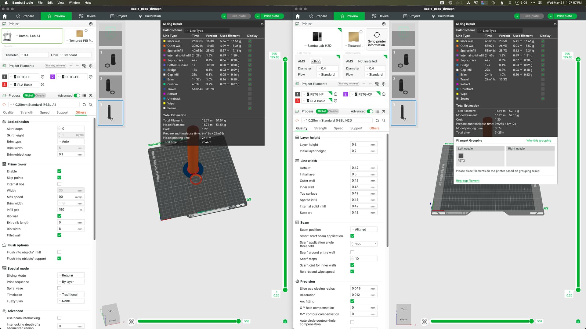

I was about to print something today and decided to compare printing it with the A1 vs the H2D, because surely my H2D will be at least a little bit faster. But in the slicer, I’m seeing the H2D come in at 40 minutes longer to print - 24% longer than the A1.
Both are using PETG, 0.4mm nozzle, 0.20 Standard profile. I went over the settings of the profiles and they are mostly the same, except the H2D has a few settings which in theory should make it faster.

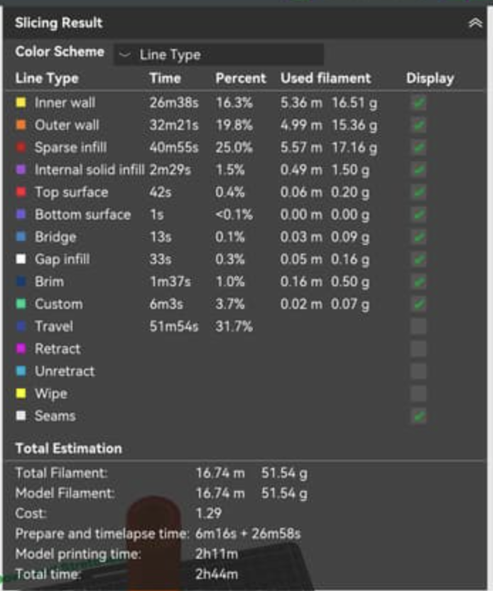

For reference here again are the slicer’s time/filament usage estimates (from my original screenshot).
A1:
H2D:
We see here that walls and infill are a lot slower on the H2D, but travel time is much faster on it (or better said, less time is spent on it). The A1 burns 31% of it’s time on Travel, the H2D only 13%.
Looking at the profiles for each of them, these were the differences:
Speed & Acceleration Differences
H2D A1
Sparse Infill Speed 350 mm/s 270 mm/s
Travel Speed 1000 mm/s 700 mm/s
Normal Printing Accel. 8000 mm/s² 6000 mm/s²
Elephant Foot Comp. 0.15 mm 0.075 mm
Precision Settings
H2D A1
Elephant Foot Compensation 0.15 mm 0.075 mm
Advanced Settings
H2D A1
Smooth Coefficient 4 80
Everything else — including wall setup, shell configuration, infill type/density, prime tower, flush settings, line widths , seam options , precision (except elephant foot) , ironing , and wall generator — is identical between the two profiles.

The problem is with PETG HF mainly as with PLA Basic its faster on H2D. This comes down to higher hot end temp (for faster printing) + longer layer time (for better quality), left is H2D right is A1.
Screenshot 2025-05-22 at 4.13.30 PM
What you can do is tick off “slow down for better layer cooling” on the PETG HF filament profile, and you will get faster print speed on H2D compared to A1. You will have to test to see if the quality suffers.
This is mainly due to the thin wall tall item, if it was a bigger print you would not run into this issue.
I personally would print it with the stock settings, but this gives you an insight to what is going on. Hope this answers you question.
TLDR: H2D is optimized to print fast but with good quality. On some specific prints (thin walls with PETG HF) it will be slower, but overall should be faster with better quality walls.
Good digging here, it’s appreciated. It was mostly curiosity. Anyone following along at home, ticking this off changes the print time from 3h26m to 1h51m.
