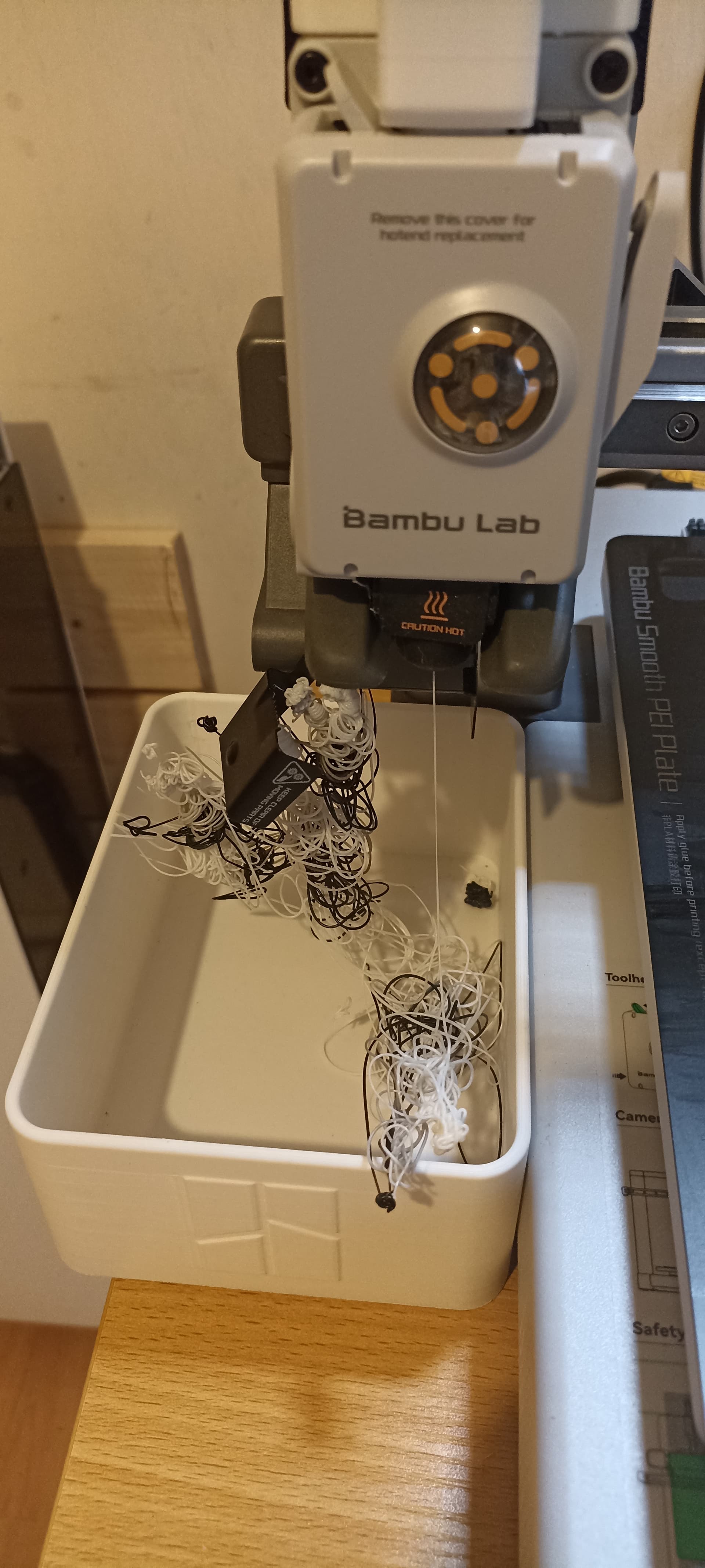

However with multi-color prints I noticed that the poop chute cart always hangs on one side. Even if I try to slot it onto the little pin when the toolhead is NOT in the poop chute position, it may lock in place but once there is a filament change, it just drops and it still always hangs on one side. As a result, filament poop always builds a massive spaghetti tower instead of being reduce to little beads and getting flung aside.
Is this a mechanical issue? How do I repair it?
There should be 2 screws attaching it and the wiper to the part with the switch that actuates it, is yours not screwed in?
Also a plastic bit it should lock into:
Try tightening the screw after you lock in onto the plastic notch
Definitely not attached properly. It; not supposed to flop around like that.
Thanks, I did not notice the screw. I tightened it and now it seems to hold. Even a bit too well, as many bits of poop get trapped in the poop chute. Maybe I should tighten it a bit less :stuck_out_tongue:

Something still does not sound right. Nothing should be getting trapped.
