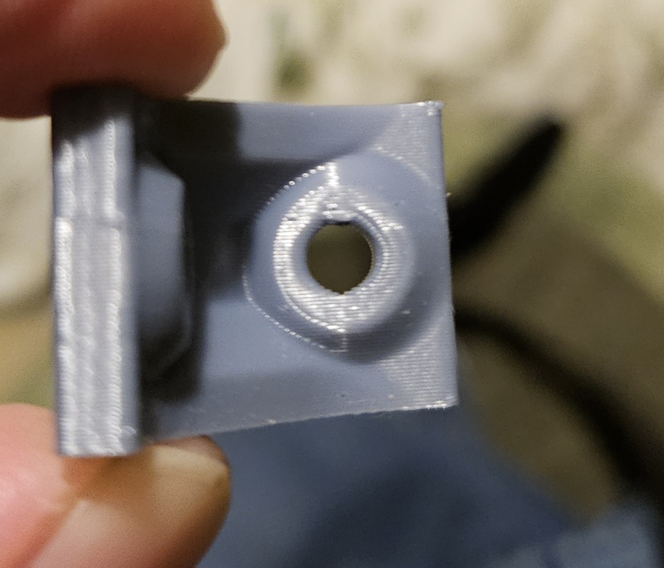

I don’t have a picture. The holes look a little weird, so are not for aesthetics. The benefit of it is if you make the hole the right diameter plus a little tolerance, the screw will fit in the hole.
This is what the hole looks like
The only solution (if you want to call it that) is make the hole at the top is a bit of a teardrop. I haven’t tried it but I believe it was Makers Muse on YouTube did a video.

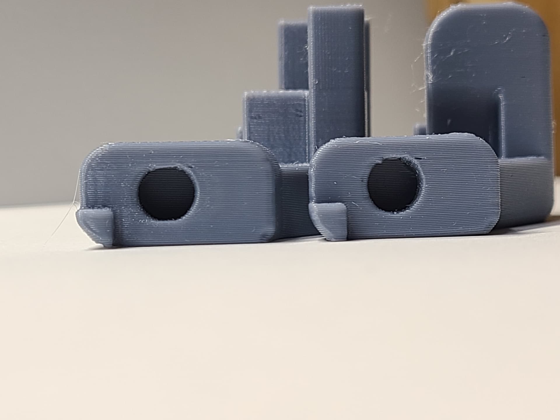

I wanted a hole that was round and didn’t want to have an irregular shape like the technique I showed above. Since the technique above is making the height one layer higher at the top and bottom, I just made the ellipse higher by 0.4, two layers higher than the width.
It did a good job. I made the hole a little smaller than the one in the left because it was too loose for my application, and added 0.4 to the height.
