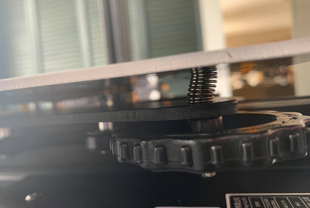

Oh yeah, the relics where you had to sweet‑talk the machine and manually level the bed before every single print.
spoilerized because this will give someone PTSD
The startup dance is fine, lol, don’t make us go back to this
I do edit the “mech mode sweep” out of my gcode startup routines though, and do calibrations manually every now and then. not because of time, but I really am unsettled by the noise and how it travels thru the entire building lol
Officially Traumatized again.
The hellish days of trying to manually level a 300x300 bed of a cr-10 before every print. I am glad that day is over.

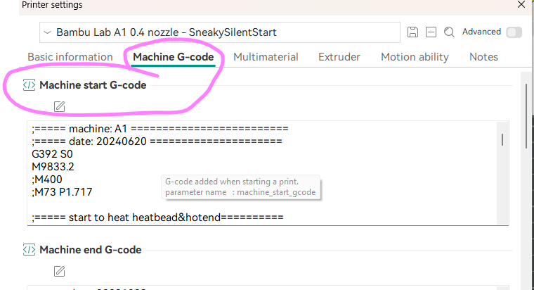

this does exist, its right here
Rip out everything you dont care about, click save, itll force you to create a new profile. now youve got a default profile and a “fast” profile
I don’t understand why the quick input shaper check isn’t an optional switch on the UI.
It should be an optional thing since all it does is not update the input shaper but just verify the resonate frequency (and scare your neighbours with huge loud noise).
Having to remember to switch custom gcode profiles really annoys me.
