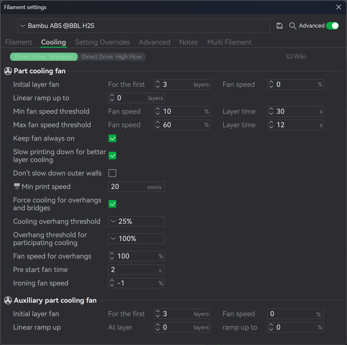

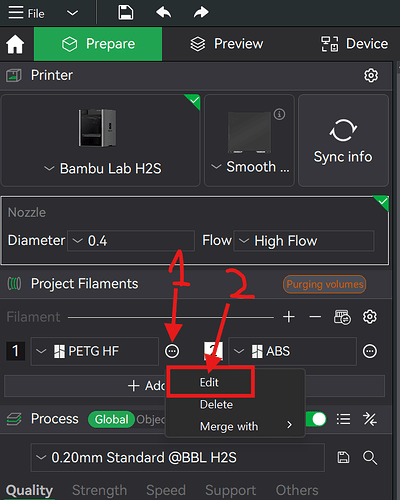

You will need to check the filament settings. Under Filament Settings → Cooling tab, you can adjust the cooling fan speed per layer, and manual fan settings can be automatically overridden during printing (for overhang, specific temperatures, layer levels, etc.).

Bambu Lab printers prioritize the cooling rules that the printer controls automatically Even if the user manually changes the fan speed, the printer will override these manual settings whenever the cooling rules defined in the print profile require cooling control—for example, running the fan on specific layers, when the temperature is too high, or when the temperature is too low.
These cooling rules cannot be changed mid-print, so they must be configured before sending the job to the printer. (You can adjust them under Filament Settings → Cooling.)
