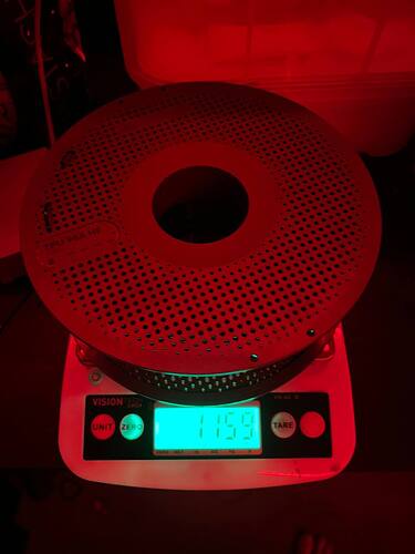

I did go ahead and use part of this tpu 95a hf roll out of the box, resulting in more seam defects and web-like stringing. Making mag covers for old film cameras incase you wonder what these are.
-For reference the retraction is set to 1.8 as part of my own adjustments to the BL default profile seeing as it was zero before and basically gave anything I made a wig.
Left- TPU HF direct from BL no drying, just opened and put it in the printer
Right- TPU HF that was dried for ~12 hours
notice the stringing difference
Seam Defects on wet filament
No seam defect on the dried filament
Fresh roll only opened and used to make the defect print, roll prints from a separate dry box not the shoddy holder on the back.
weight BEFORE and AFTER 6 hours in a 75C forced air dryer
In conclusion any and all TPU from BL should be dried before use especially seeing as this is only my second roll opened from them and it is just as wet as the last one. will post weight after 6 more hours of drying. and make sure you set some kind of retraction since the default TPU-HF profile for BL filaments lacks a retraction.
After 12 hours ended up losing 4 grams total
