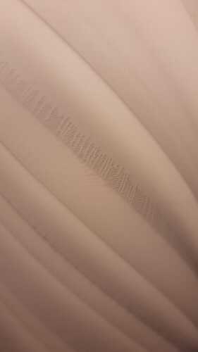

I’m trying to print a lamp but there are some weird artifacts ruining the aesthetics.
This is the overall design. Its a cylinder with some ripples:
In normal mode, 1 wall, 1mm line width, there are some ripples after the seam, that cause diagonal lines. You can see this on that test print:
In vase mode, 1mm line width there are some ugly diagonal lines as well. They appear always at the same spot, but the amount differs slightly from print to print as you can see on the picture:
I’ve tried following things already:
  • full calibration of the machine
  • changing the feet to the soft anti vibration feet
  • readjusting the belt tension as described on the bambu wiki
  • cleaning the rods
  • full calibration of the filament
What am I missing???
Thank you
i’ve the same problem on p1p. Tried everything but nothing…
I might have found the issue, but I don’t know what might have caused it, since I changed so many things.
First, in Orca slicer, there is a new feature for vase mode called smooth spiral. I turned it on and some lines disappeared.
Since I used a PolyLite PLA I tried another PLA filament from Bambu and it printed flawlessly. So I have to assume that the issue is caused by the filament. On my Polylite spool i had a printed brim with a rippled border to protect my AMS. I removed the brim, in case that this might cause problems at transporting the filament to the extruder.
Then I adapted the Max volumentric speed from 15 to 22 mm3/s, since this is the setting the bambu PLA came with.
And in addition to that I made a pressure advance calibration, just in case i failed in the first place.
In the first test prints, it printed flawlessly. Now I’m going to print a full scale print of my lamp and post the results here as soon as its done.

Have you cleaned the rods and readjusted the belt tension? At what speeds are you printing?
Yes, I have cleaned the rods and adjusted the tension of the belts. I am printing at normal speed with bamboo filament defaults. i saw in a youtube video that this problem could be due to a misaligned xy-axis… i will check

I think I finally solved it. I retensioned the belt for a couple of times, thoroughly lubed the screw rods that move the plate and run a full calibration each time.
the artifacts seem to get better each time till they finally completely disappeared
