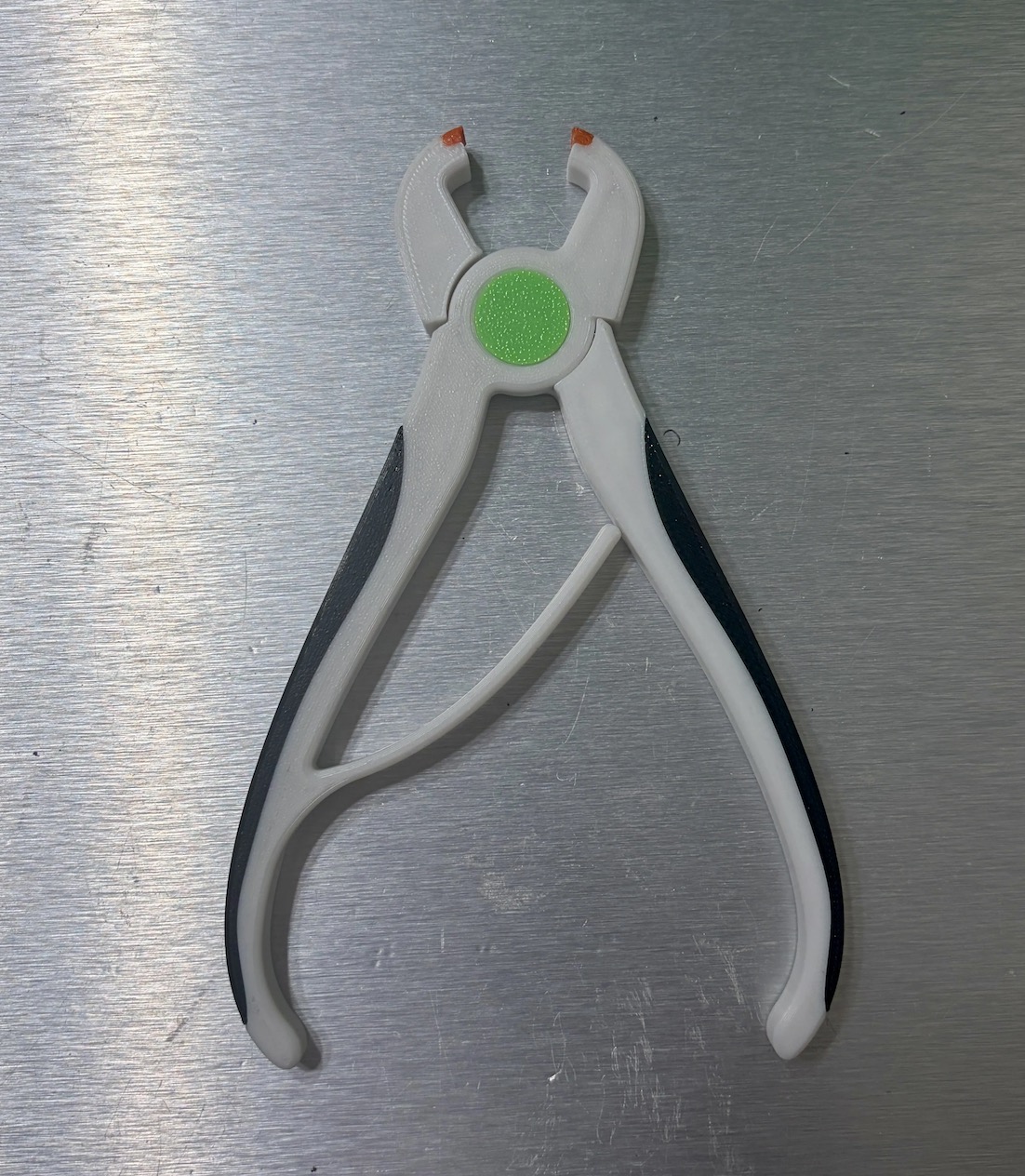

I can’t use fibre filament (GF, CF etc) on things that will be handled a lot.
You can overmould with TPU for grips etc, thats what I do.
