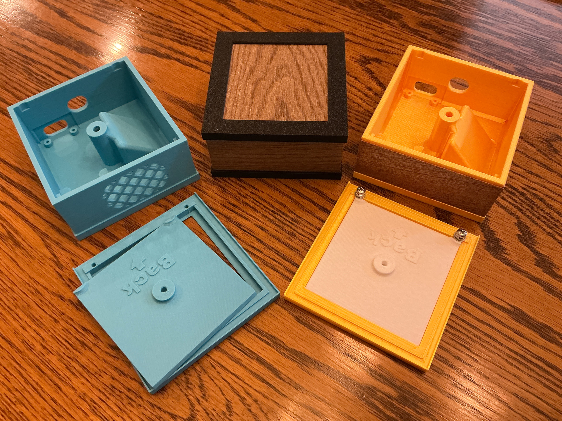

I’ve added wood texture to 3D prints for different purposes and it can look pretty cool. But I’m working on a gift print where I wanted real wood and the quality kind of look that brings. So far it’s looking good. Plastic and wood can make a nice combo. Plus, with all the specialty filaments available as well as a wide variety of woods available in thin veneers, this could be a fun side to 3D printing.
The woods are available in very thin, about 0.5mm thicknesses. It’s easy to not only print recesses, but also print templates to give perfectly-shaped inlays. The project I’m working on now has wood bits on 4 sides to accentuate the design.
I made a fixture to hold the sheets while varnishing. I’m finishing first then will cut to shape and stick down using special double-stick adhesive sheet. Here’s a shot while applying varnish and another testing how the gold silk+ looks next to it to see if they work together. The first shot has the veneer with the left side just a single coat of varnish. It’s clear gloss with no stain for this one and it does help the grain pop. The shot with the plastic is just one coat of varnish.
Anyway, possibly something that might fit with other prints. I got a pretty big assortment of veneers in different woods for about $25. The hardest part was picking the right wood and I narrowed it down to five different woods before settling on this one for trim on a music box.

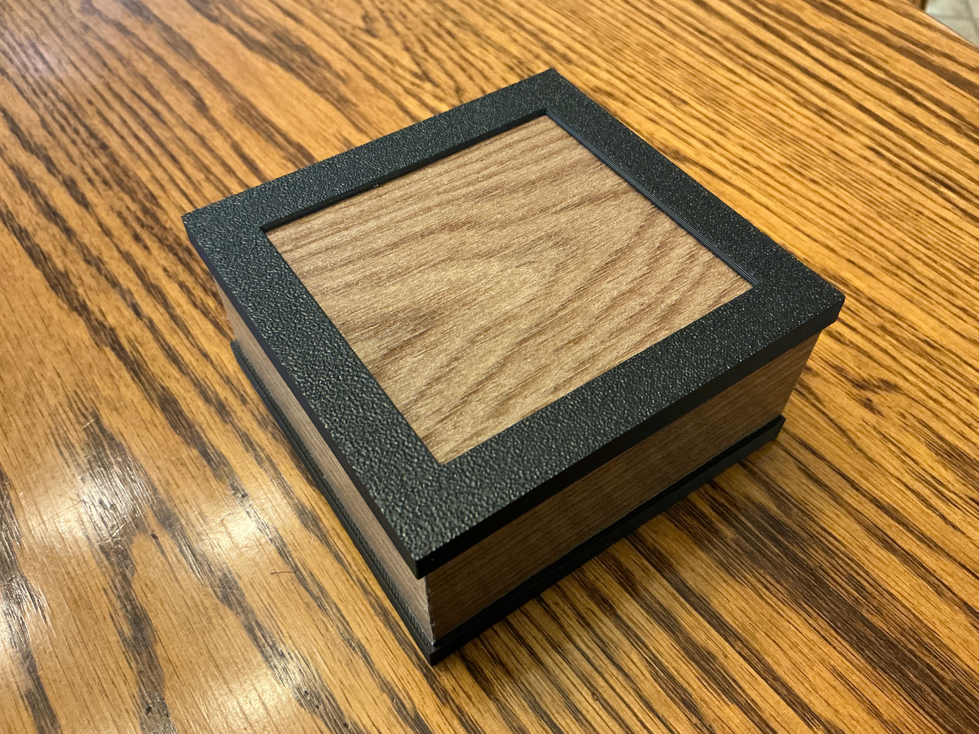

Here’s the final print. The combination of wood and plastic looks like it can really enhance the look of models but is a different look for 3D prints I think. The 3M 468MP double-sided adhesive works great. Not repositionable though. Once you stick it down the wood will only peel back off as splinters and chunks.
@Blyzzard - Wood-filled filament is pretty homogenous stuff. You can print wood grain textures and they can look pretty good, but this puts the wood choice for color/texture in end user hands. I’m not a fan of the gold/mahogany version but the black/walnut version looks pretty good to me. With choices so open, I think better for any builders to choose for themselves.
Plus real wood just has a presence that printed wood doesn’t. I did a wood textured back for an animated halloween door knocker last year (photo below) and it looks good I think in that application but IMO real wood looks better.
But there’s probably some better ways to add wood. Accent or main feature, dealing with edges, etc. Not perfect but I think there is potential.
