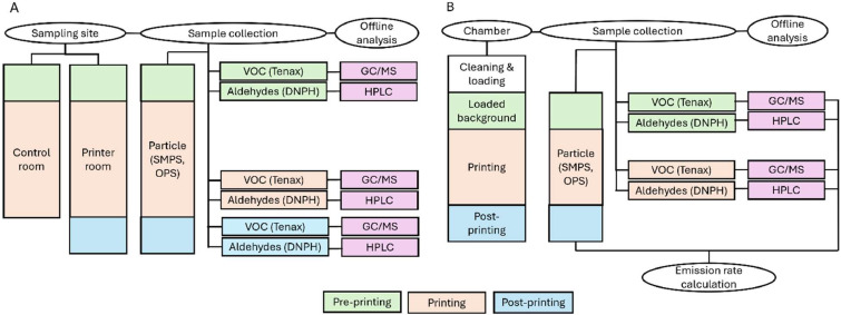

This study says “yes, 3D printers decrease indoor air quality. But not enough to really be worth worrying about”.
