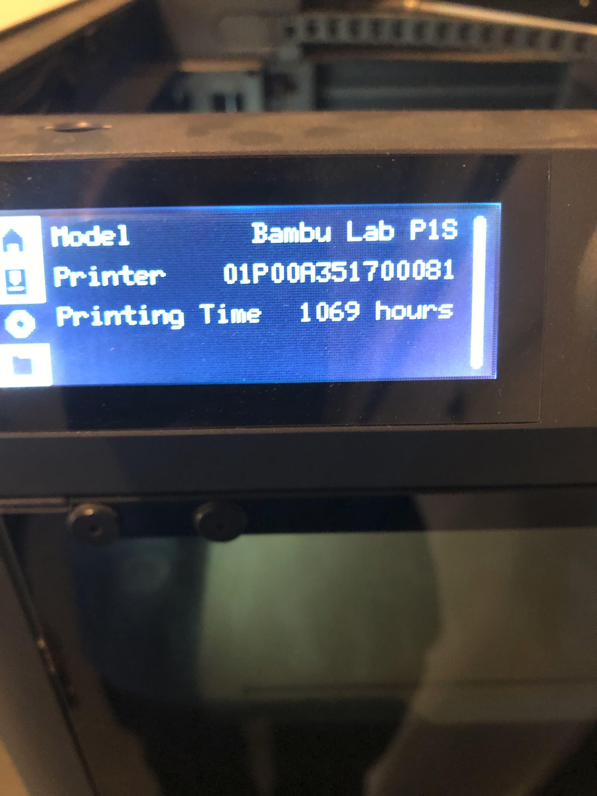

i have a bambu labs P1s with just over 1000 hrs on it.
at the 800 hr mark it has been giving me the x and y belt tension error codes
as well as violently chattering around the print area.
I replaced the tool head control board and ribbon cables as well as the board on the back of the tool head, the problem went away for awhile. hard resetting seems to clear it for a while. but now its back worse than before.
Circles are ovals and it layer shifts around the bed. i dont seem to be able to post a video but i would say its trying to do corners at full acceleration.
