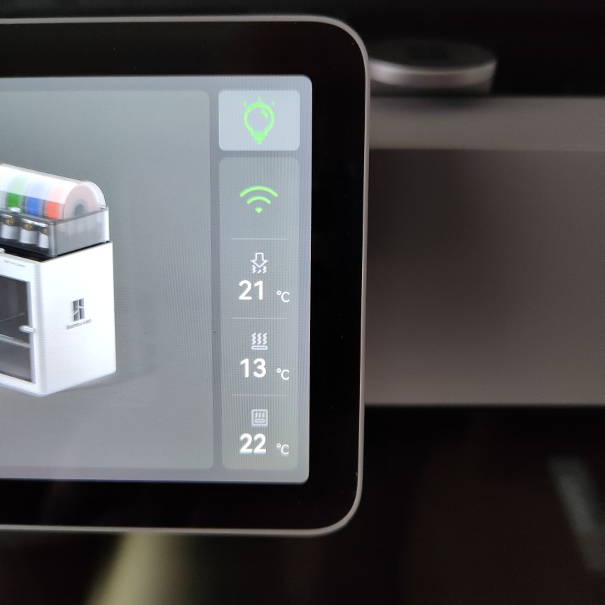

Hello,
I recently saw that my bed temp reading is lower than chamber and nozzle temp.
Nozzle: 21 C
Bed: 13 C
Chamber: 22 C
Needless to say that in the last few hours did not print.
I think everything was fine before the last firmware update? Does anyone else have this problem?
Best regards, Peter

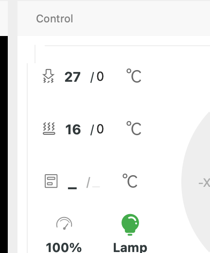

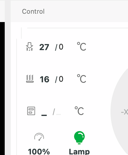

I see the same on both my P1Ps, too. This is a screensnip from Bambu Studio on my Mac with the printer at ambient printer after not being used overnight.

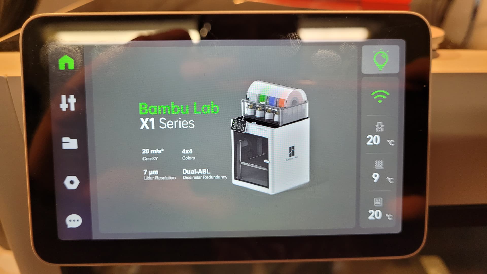

My P1P has been standing for 18 hours - no problem here X1C is printing so will check what happens later - All machines running on latest firmware
