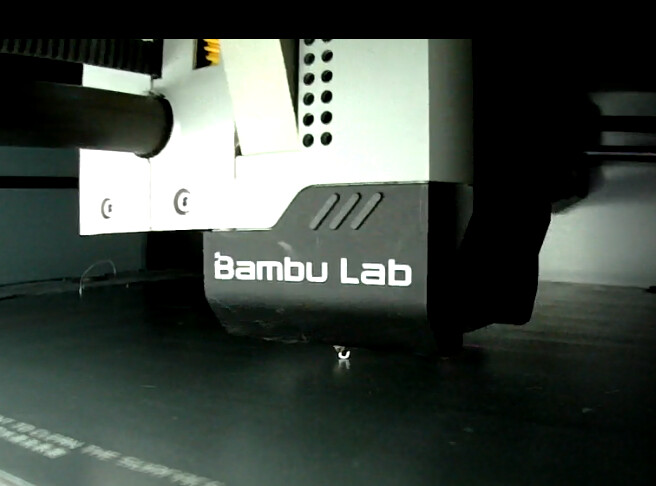

On mine it’s the ooze. It oozes a little after wiping, then has some filament sticking out of the hotend, then the leveling starts, so it smashes this bit of filament between the nozzle and bed, thus then the 0 for Z is too high because of the sandwiched filament.

I grabbed a pic, just happened.

Forgot to switch plate so got an IRL test just now. I installed the correct plate and resumed. I did see a similar ooze as the picture above but the nozzle was 140°C so it (being PETG) was punched to abidance at first knock.

It’s like it’s not the temp, but the extruder slightly pushing some out? At 140 PLA shouldn’t be oozing yet iirc.
