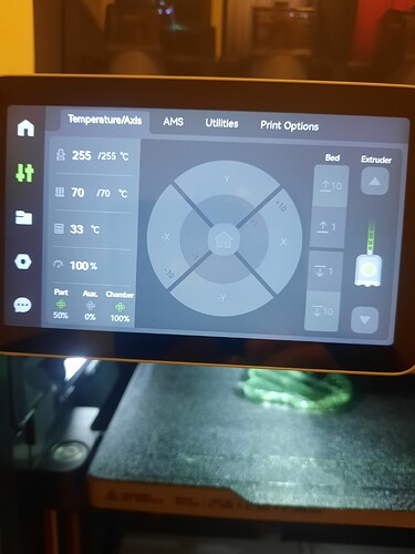

After my earlier reply I decided f*ck it and I’m doing my first print with PETG on my X1C
And for the record with my front door open, part fan at 80%, aux fan off, chamber fan at 100%
I’m trying a beautiful translucent silk green by Tronxy
As for your issues with printing PLA I’d really like to see you get it sorted or help you in any way possible

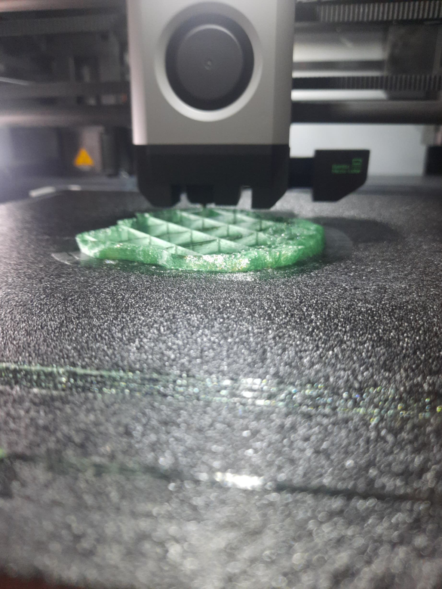

This Tronxy PETG is more runny than a 3 year old with a colds nose, same color too lol
But so far so good
Its nice to see my part cooling fan automatically ramps up from 40%-100% for overhangs

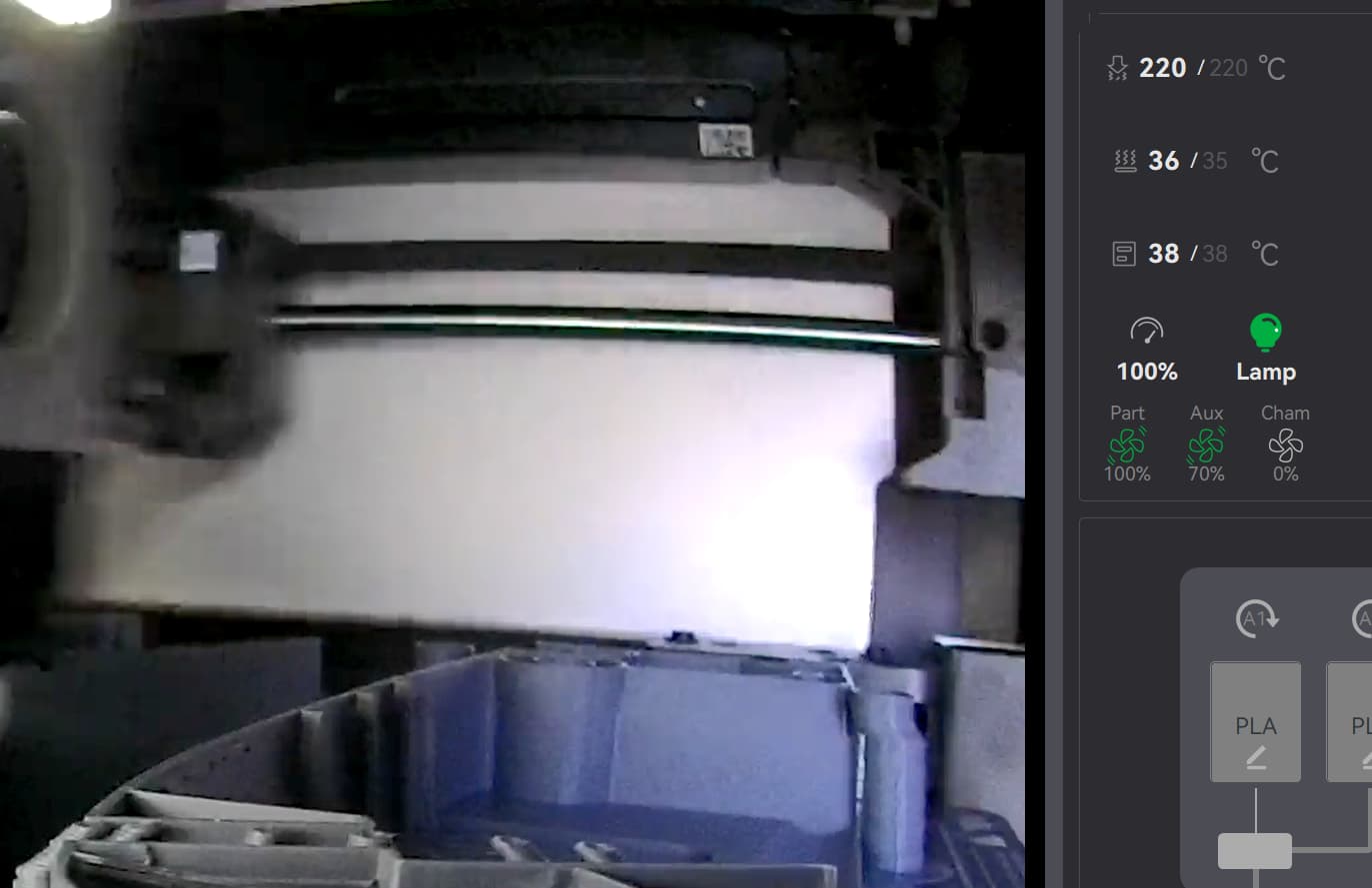

It’s not creeping up in the filament, the heatbreak itself gets hot (>55ºC) which makes the filament plastic so it bulges instead of going through the nozzle. The problem is that when the air in the chamber gets warm, heatbreak no longer cools enough as all it has is chamber air.

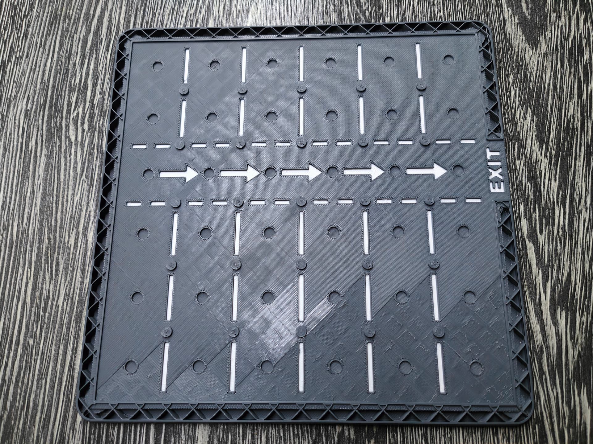

Was printing now for 3,5h a game called rush hour. Printed the plate for the game and everything was fine but than started again to not purge the filament. Enclosure was closed. I stopted the print and load/reload filament and than it printed again. You can see on the pic, where the layers are missing. :pensive:

chamber temps don’t seem to go over 38 max
