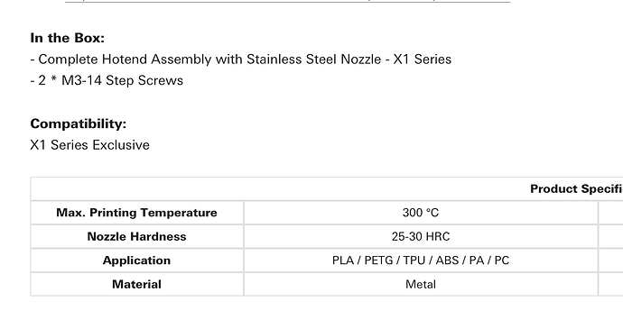

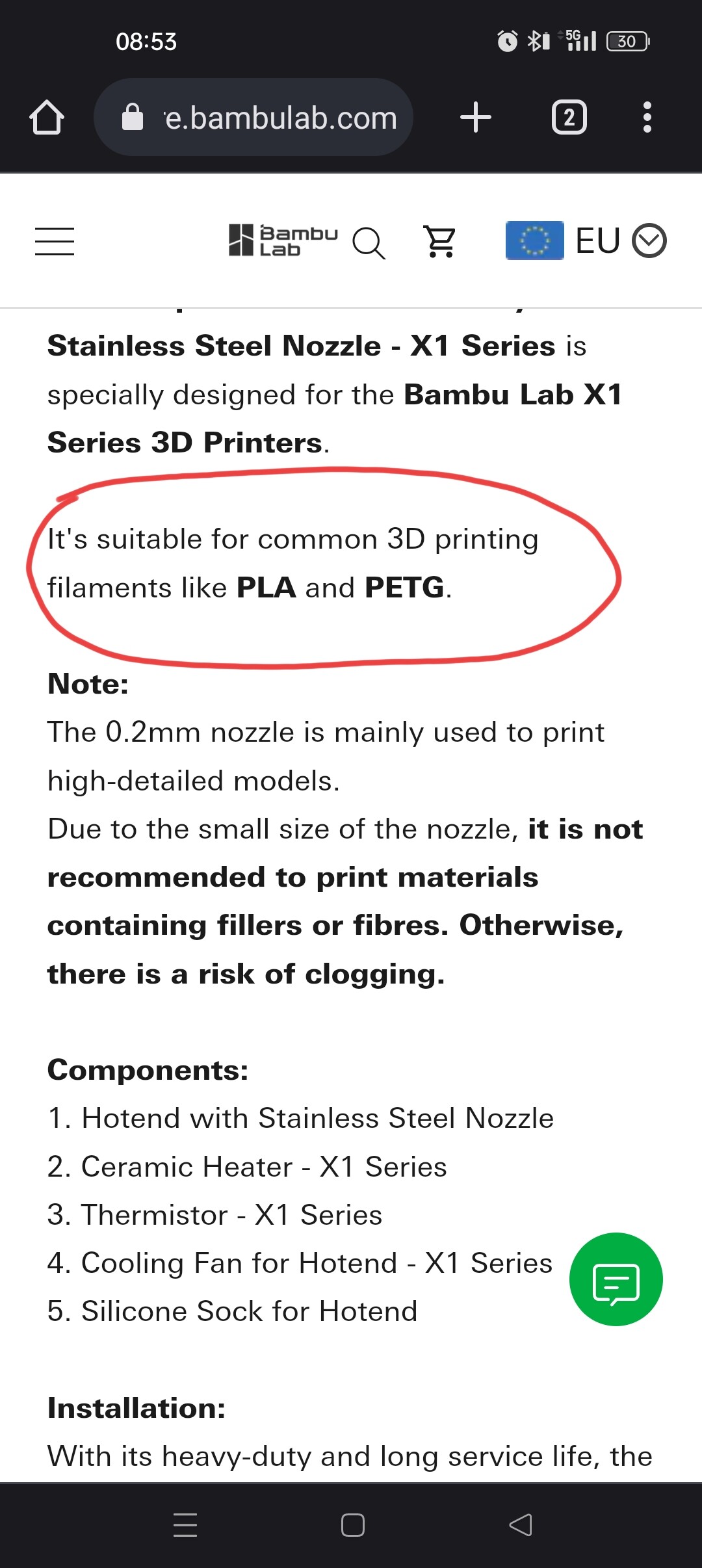

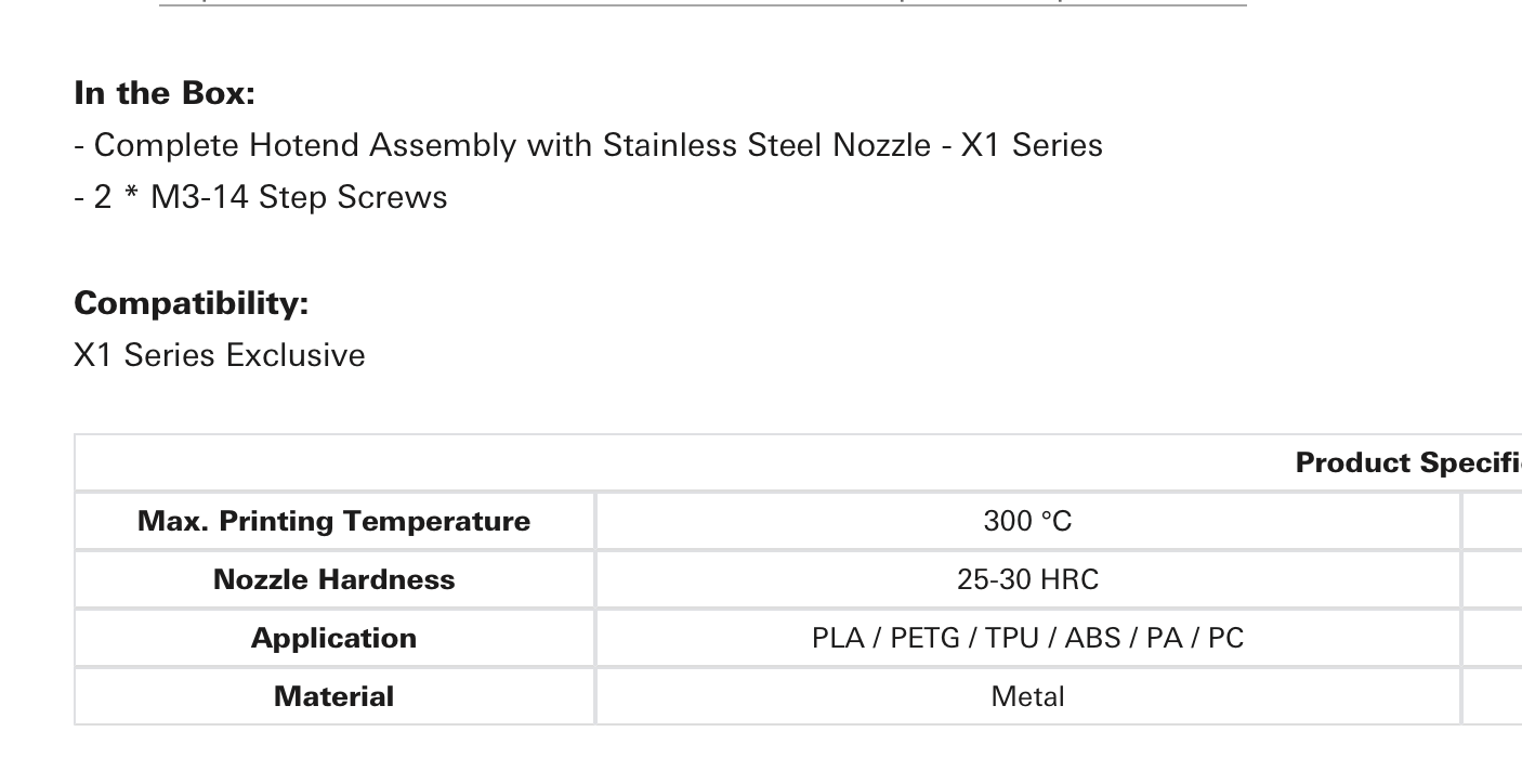

Is the stainless steel nozzle really recommended for PLA? Or is the P1P (which only has a stainless steel nozzle) only recommended to print non abrasive filaments like PLA and ABS?
Look at bambu’s hp. Stainless steel PLA/PETG, hardened steel carbon nylon etc…
Link?

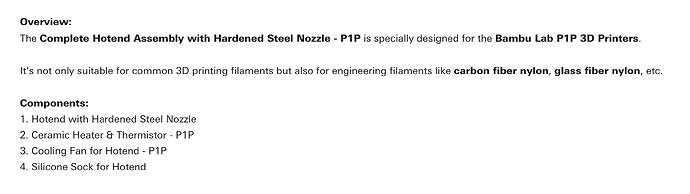

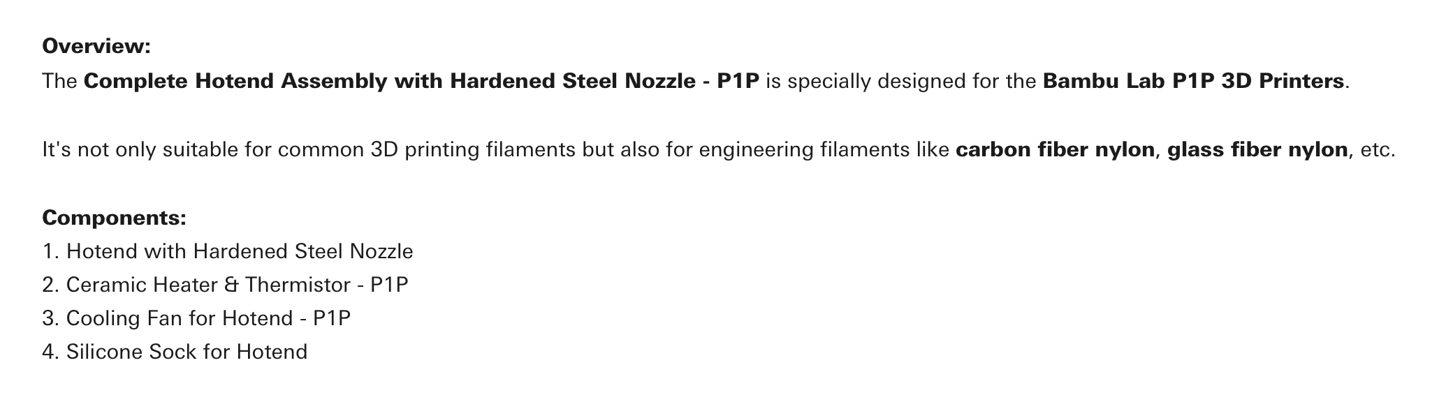

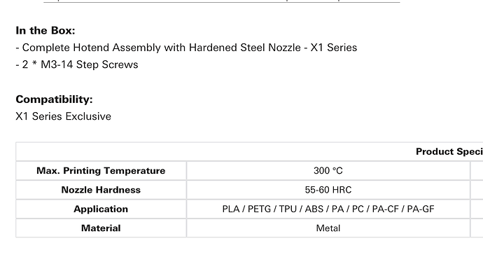

Hardened Steel:
Stainless Steel:
Right, because it’s only suitable for common 3d printing filaments. The hardened steel nozzle is suitable for common 3d printing filaments like PLA and PETG too, but also suited for abrasive filaments:
Doesn’t seem like the stainless steel nozzle is recommended over the hardened steel for PLA.

I was just trying to figure out if I needed to get a “recommended” nozzle, which is why I asked for the source of your information. It seemed to contradict the hardened steel nozzle product documentation.
I would think you’d be happy now since you don’t have to spend more money on another nozzle to solve your printing problem. :wink:
Who is printing with his Prusa MK3 or Ender 3 etc… with a hardened nozzle? Everyone using brass nozzle, copper or stainless steal. If you only printing pla, than it makes no sense to use a hardened steal nozzle.
The cost of the hardened steel nozzle is the same as the stainless and brass ones, I think the hardened steel nozzle will take much longer to wear out. :bulb:

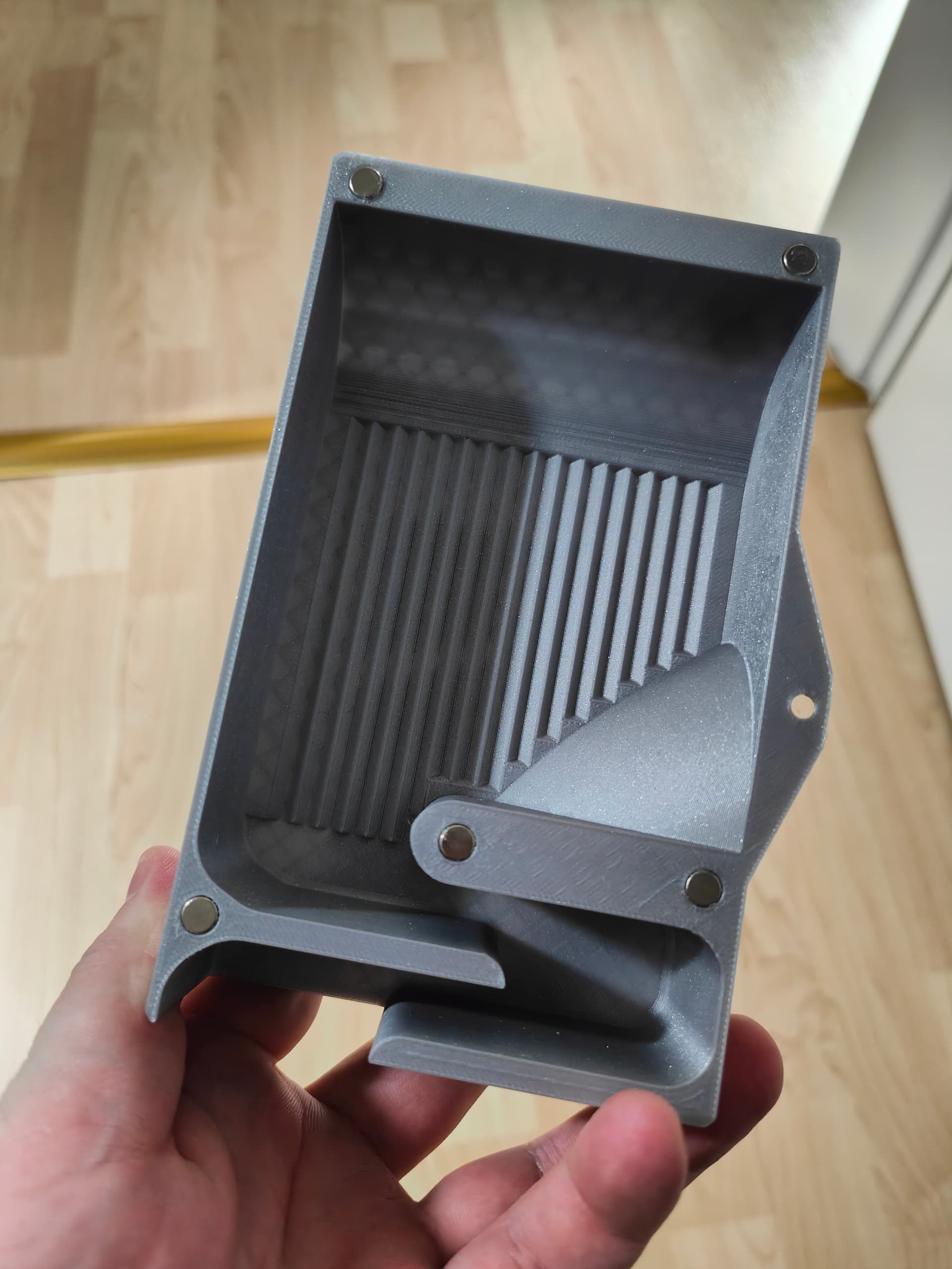

Hey, i use this muffler https://www.printables.com/model/350953-bambu-lab-chamber-fan-muffler i have never had heat creep or a plugged nozzle. I use it with PLA, PETG and ABS. When using PLA the db’s are around 51 and chamber temps are under 40c. My house temp is 71f.
HTHs
I forgot to say that inside it was lined with felt.
