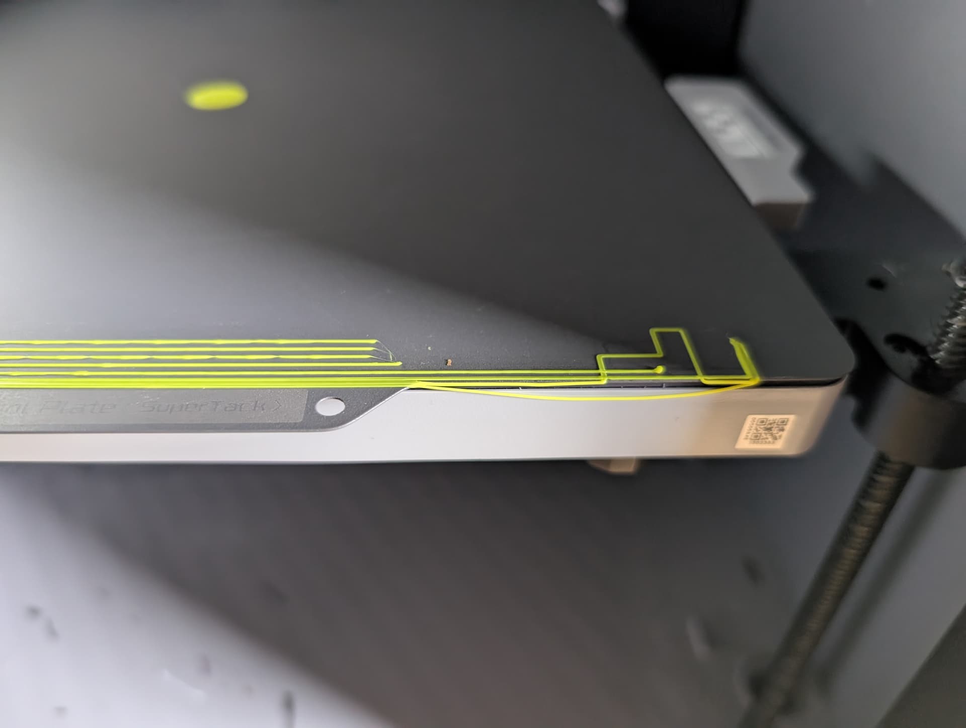

After the recent update to the X1C Firmware. The start code seems off just slightly in the y direction.
the shift is just enough to cause the filament to catch on the chute and stack up.
anyone else notice this or having a similar issue?

Unless there was an update today mine is fine. I would check for a bent nozzle.
Your nozzle could be bent.
Bent nozzle for the win! 123
I don’t know how it got bent but after I removed the silicon sock it was definitely bent.
