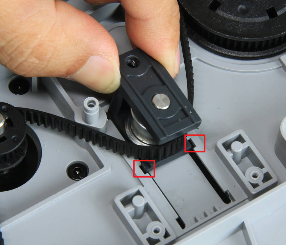

Here is the picture from the wiki for the z belt replacement. It looks very similar.

As well as the XY + Z maintenance guides for replacing them, I linked the XY previously, here’s for the Z:
