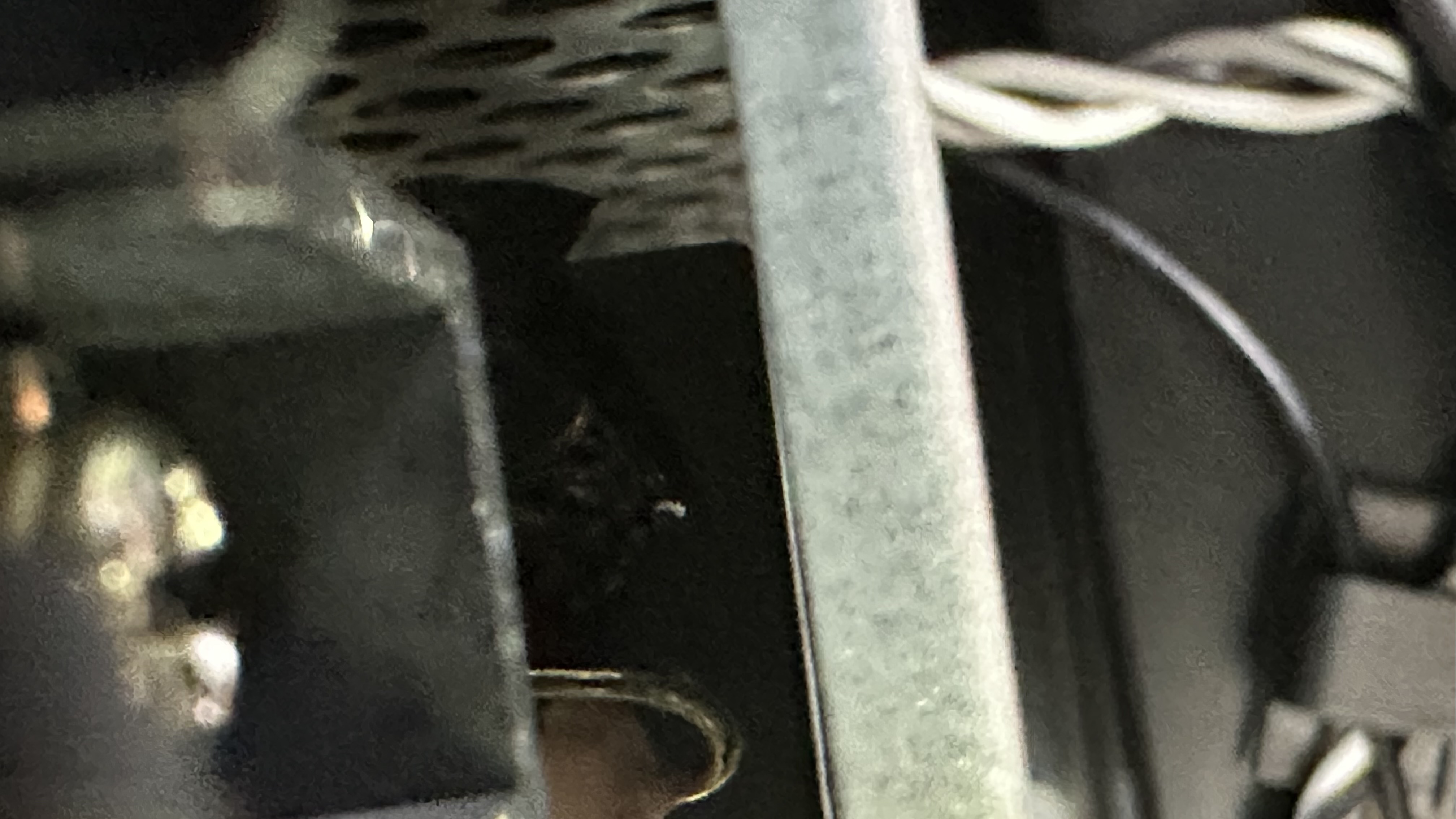

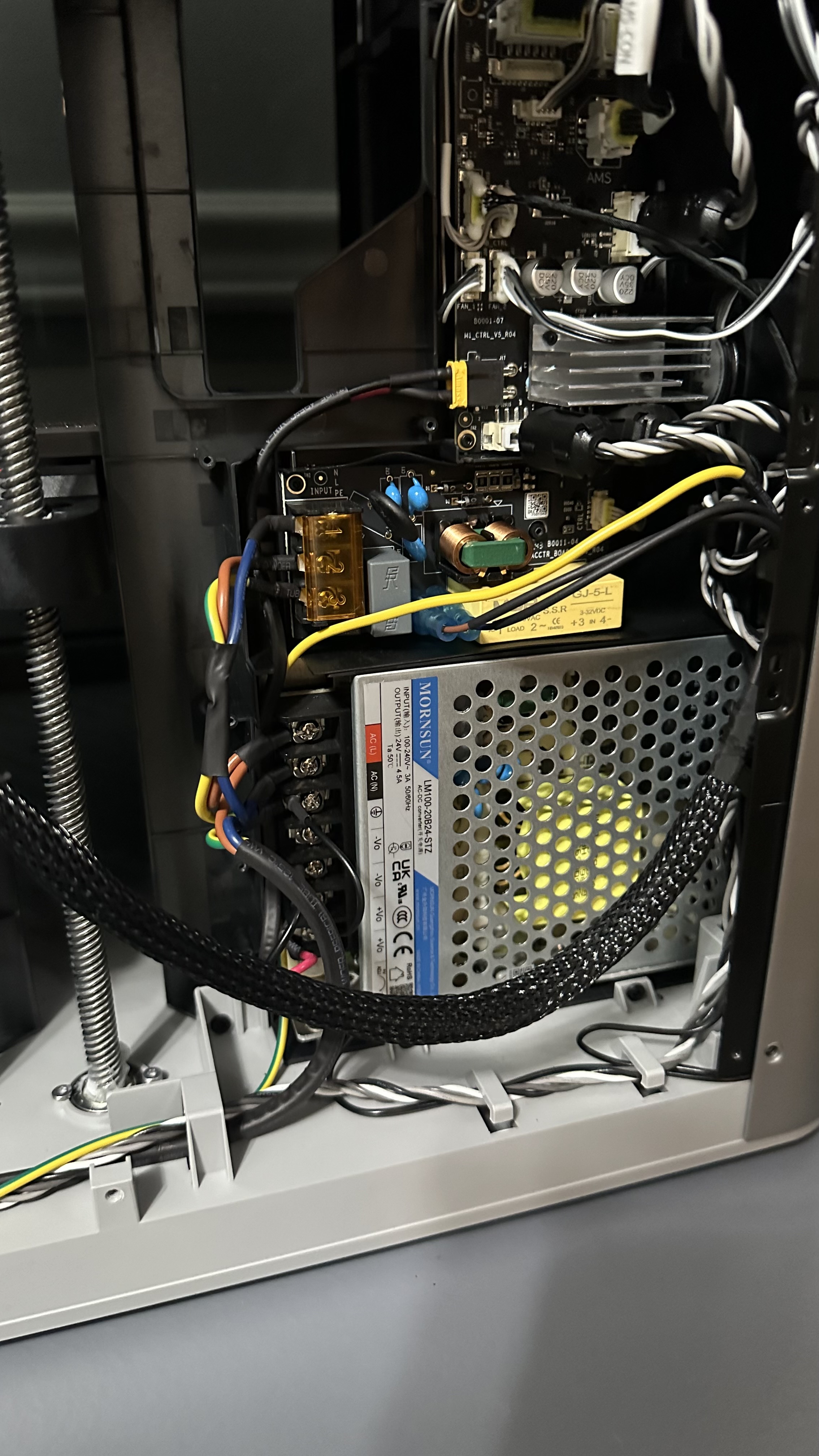

@Zane_Brown , I know this was a year ago but did you take any pictures?
I did, the only ones I could find on my phone were these two. One is just a shot of the power supply so I could Google the model # etc…
The second close up was of the capacitor that blew. I was looking for options, either replace the power supply or maybe solder in a new capacitor. Was cheap enough to buy a new power supply, found a site that sold them for $25USD so ordered two.
