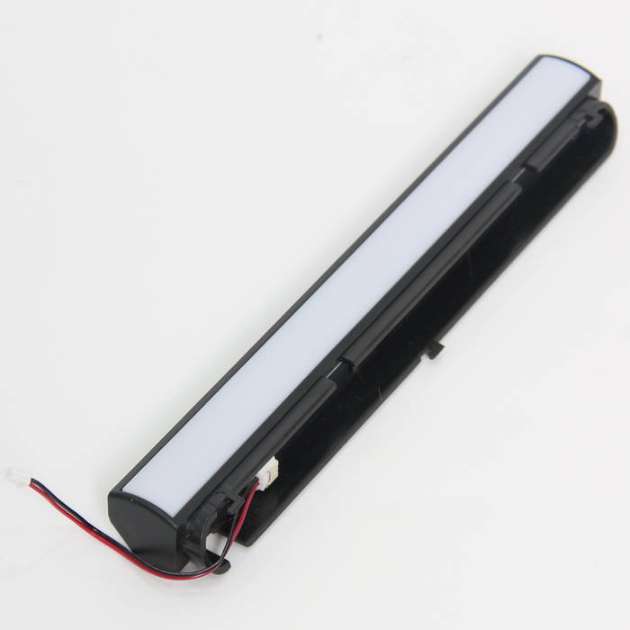

You need:
1x X1E front LED - #FAZ012. *I believe the side LED is the same as the X1C side LED except it doesn’t have the wire holder. I didn’t compare.

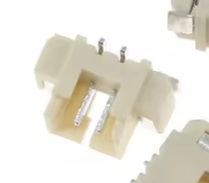

1x 1.25mm Connector Horizontal SMD Vertical/Right Angle Type Male JST Socket Connector

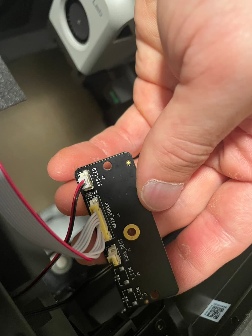

Procedure: Follow Bambulab Wiki for removal of front Cover Panel to get access to Power Buttons. Remove Power Button PCB. Solder the JST connector to SYS LED. Install by putting the slots into the slot holes of the chassis then slide right to lock. Put everything back together

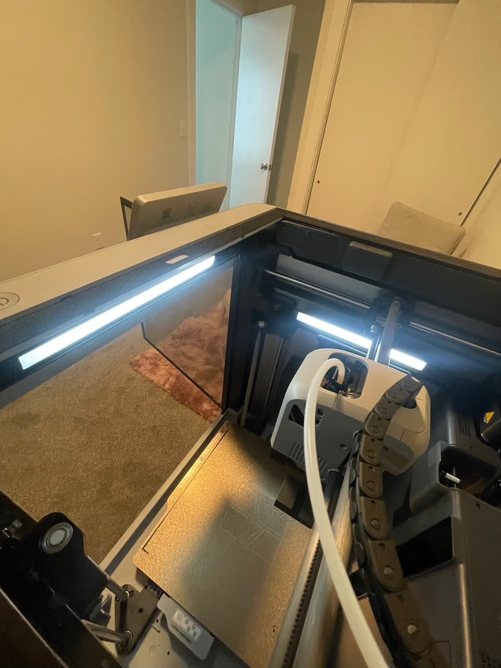

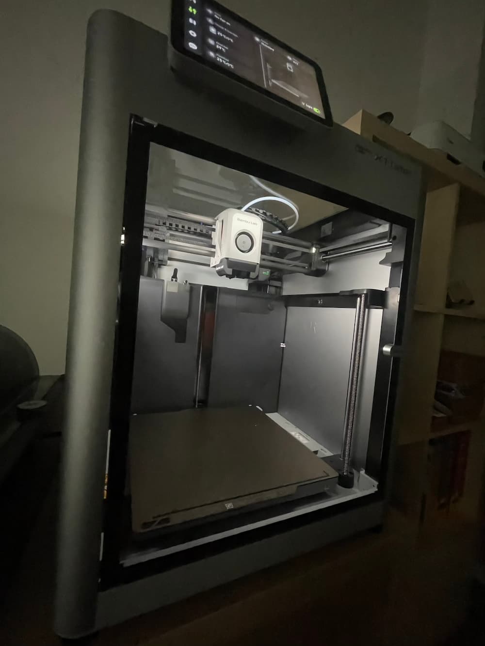

What you end up with is a fully OEM LED setup like the X1E. Still all controlled with the normal lighting function of the firmware.
Great upgrade!. Where did you buy the X1E LED?
I got it from Gigaparts. I guess I got the last one though.

I already soldered the JST connector and managed to get one OEM X1E front LED from https://www.congeriem.com/front-led-light-compatible-with-x1e.html. Still waiting for it to arrive though. Now thinking about the OEM internal chamber heater. It would be great upgrade! It would require one chamber heater and the control board. The only question besides de price, is how does it integrates to the firmware. Anyway, thanks for your MOD.

I have the Biqu LED bar. It was easy to install and I have it running in conjunction with the stock light (even though Biqu advises not to.) It’s been working fine that way for months.
Hi can you please send us a link where to get the 1x 1.25mm Connector Horizontal SMD Vertical/Right Angle Type Male JST Socket Connector or the amazon link

Edit: I soldered the JST connector on and it works. I’m now running 4 individual lights / strips off the system.
I’m in the process right now. For the longest time I’ve used the stock light with another Biqu light in the front of the case that comes with the little 3-4 JST connector extension board and I ran one additional Biqu strip under / inside the panda perch facing down on everything.
I messed up my front light trying to remove it from the black thing they had it in that magnetizes up under the front of the case because I didn’t like the angle of it/ angle of the lighting and I wanted to angle it myself. Once I messed it up I was googling just to see what other people have for lighting now since I haven’t checked in years and ran across this thread about adding the connector (never knew about or saw at all)
I wouldn’t listen to any threads online saying “I’d be careful and would not run multiple lights” in place of the stock light or with the stock light as well. I’ve ran 3 off the system itself with no extra power source for multiple years. Adding this JST will be 4 lights.

I’ve been running thr Biqu solution in my X1C for a year, no issues on my machine at all.
