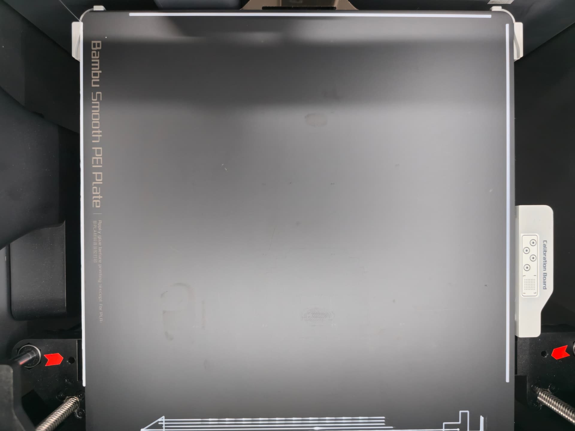

I started printing a couple CanFinity units, and they are large enough that they use almost the whole print bed (minus the exclusion area). However, on one of my X1’s, it seems that either the print head, or bed are off-set to the left a couple of MM.
I created a small model to test the alignment. This is on the X1C that is off-set:
20250613_061709
And this is the same file, in the same copy of BambuStudio on my second X1C (Yeah, pay no attention to the quality, that build plate needed a bath real bad!)
20250613_061803z
And it prints just fine here (As did the Canfinity units).

I think the printer references the front right corner for setting X and Y to zero. Maybe something is in the way there? Some waste filament or similar? You can watch the had referencing when it bumps in the front right corner twice, once front, once side.
Edit - Seems I somehow missed the post right above me that said the same thing. I slightly expanded on the idea so I will leave the post up for future reference.
Make sure that the problem printer can fully home in the front right corner. It seems to be setting the home point a little early. The printer doesn’t home with a switch, it uses sensorless homing which means it sets the homing point when it encounters resistance in that axis. A slightly shorter ptfe tube can cause this, or a small chunk of filament wedged in the corner. Take the top off and manually move the head to the right front corner. Often this will show what the problem is. Luckily you have more than one machine so you can compare them.
Just checked it, all clean. Was really hoping I’d find a little purge that got away from the chute (This has happened to me before!) but sadly not this time!
Huh, that’s an idea! I’ll go check the head and PTFE tube right now.
You were entirely correct. The PTFE tube being just a bit too tight when it was hitting that corner. Replaced it with a slightly longer tube and we are golden again! Thank you!
