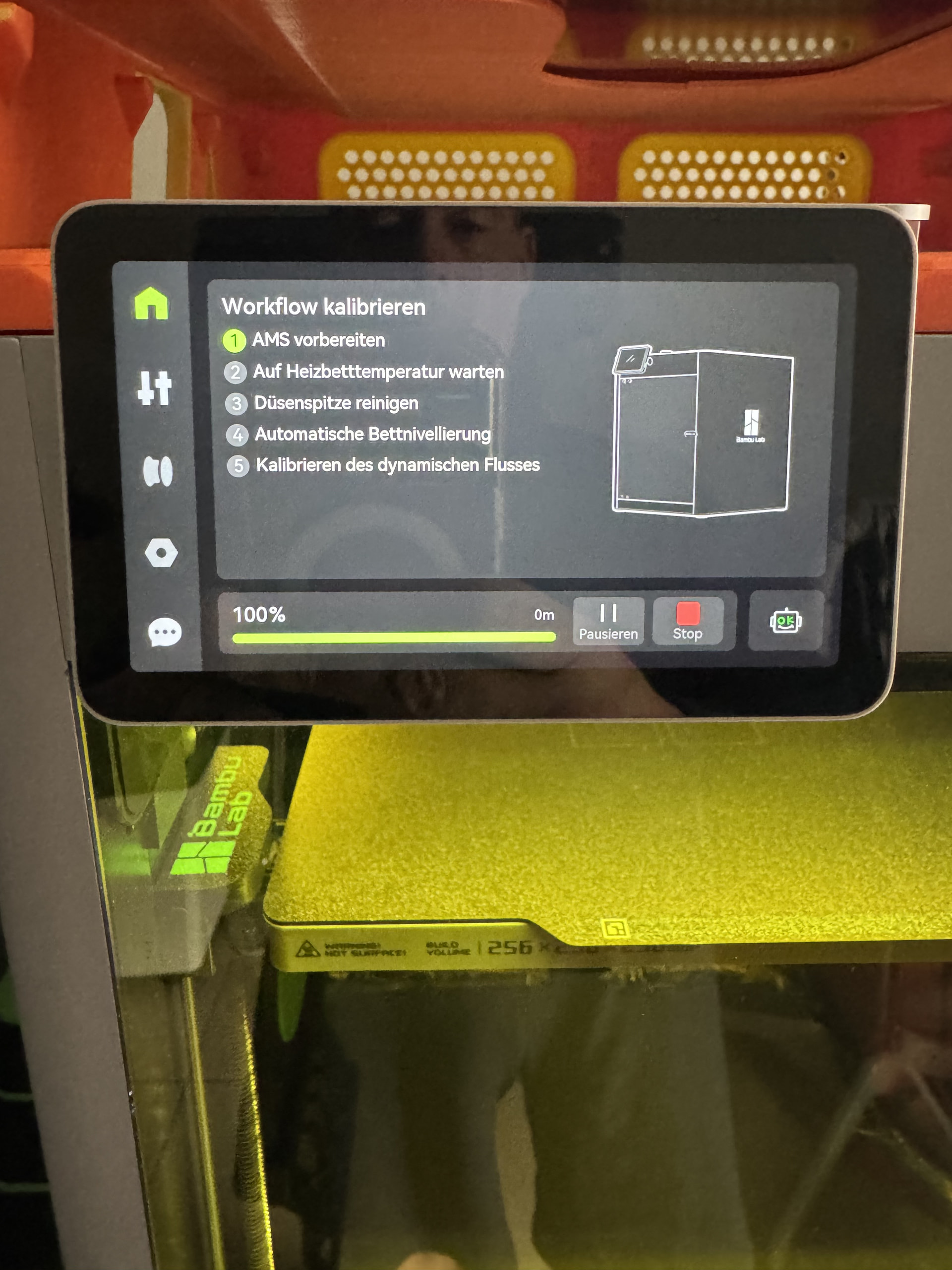

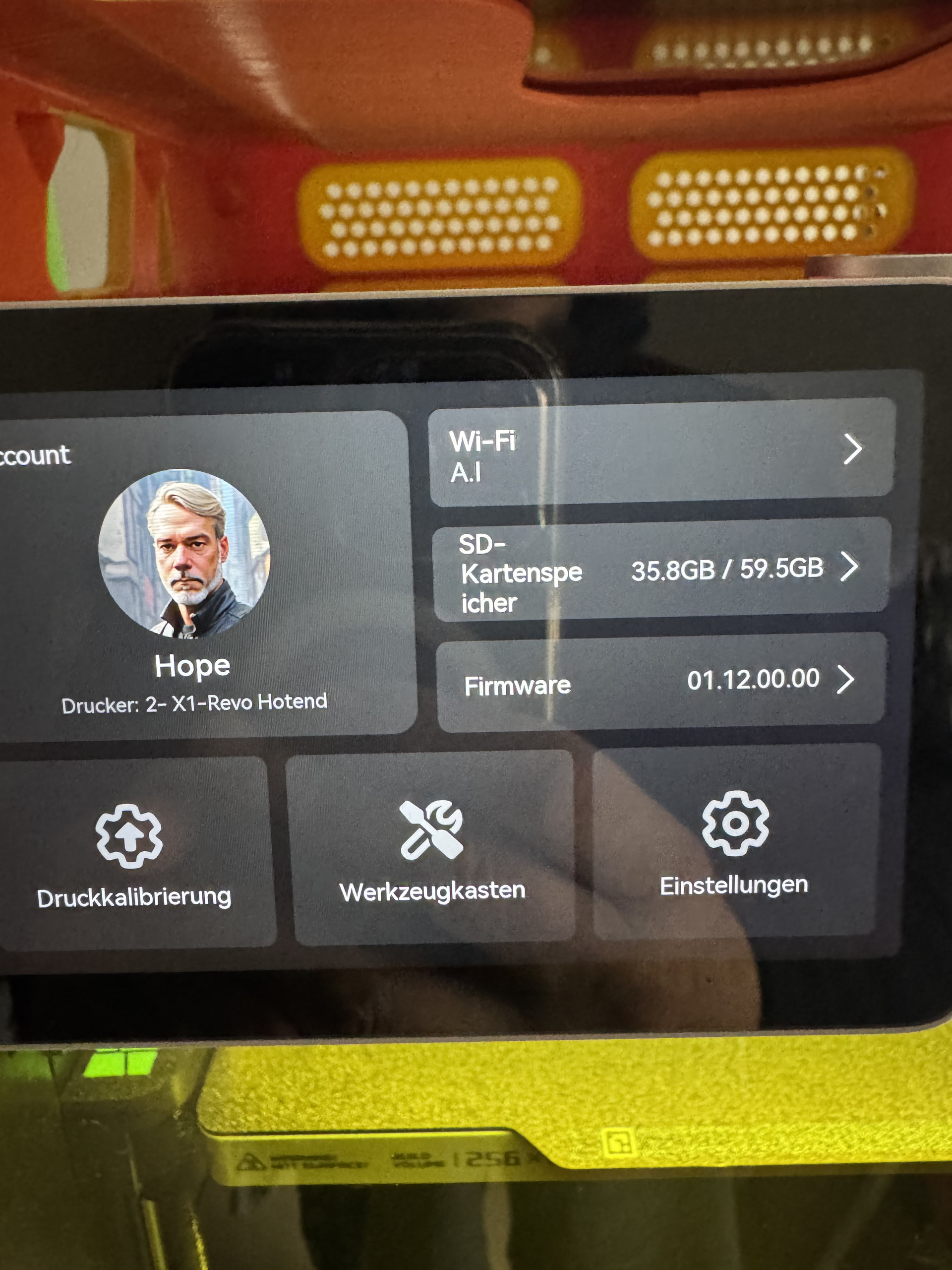

    since updating my X1C to firmware 01.12.00.00, I’ve been having an issue with the AMS.
    When starting a print, the printer gets stuck on “Preparing AMS” and does not continue.
    I had the same issue before and was able to temporarily fix it by disconnecting and reconnecting the AMS cable several times.
    I’m currently downgrading to 01.11.02.00 to see if this fixes the problem.
    Has anyone else experienced this issue with firmware 01.12.00.00?

This is not a beta firmware – it is an official release. In my case, after installing it, my X1C repeatedly got stuck at “Preparing AMS” and was unable to start a print.
After downgrading to 01.11.02.00, everything immediately started working normally again with exactly the same hardware configuration.
