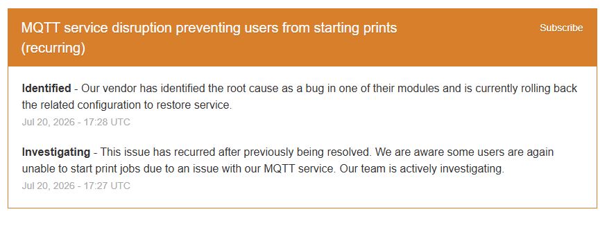

I am UK based, running an X2D Firmware 01.01.01.00, Bambu Studio 2.7.1.62 and Bambu Handy 3.24.0. Recently, I have had my printer become unavailable in both Studio and Handy Apps for long periods of time.
I can still ping my printer on the network (it is given a static IP) and the screen on the printer reports that it can reach the router but does not complete the connection to the internet. Turning it off for a period or resetting access codes eventually work. Any ideas?

on device tab in studo i have failed to conncet to server, clicking on the arrows next to shows me error 6020 failed to connect to cloud service..checking on the update says

MQTT service disruption preventing users from starting prints
Resolved - This incident has been resolved.
Jul 20, 16:42 UTC
Monitoring - Service began recovering at 16:00 UTC, and most users should now be able to start print jobs normally. We are continuing to monitor to ensure everything is fully back to normal.
Jul 20, 16:26 UTC
Identified - We have identified the root cause as an issue with one of our MQTT service nodes. Our team is actively working to restore service.
Jul 20, 15:51 UT C
Investigating - We are aware of an issue with our MQTT service that is preventing some users from starting print jobs. Our team is currently investigating.
Jul 20, 15:41 U TC

I’m also having this issue on the H2D and P1S in the US right now. Seems that there is a cloud service issue, check: status[DOT]bambulab[DOT]com
