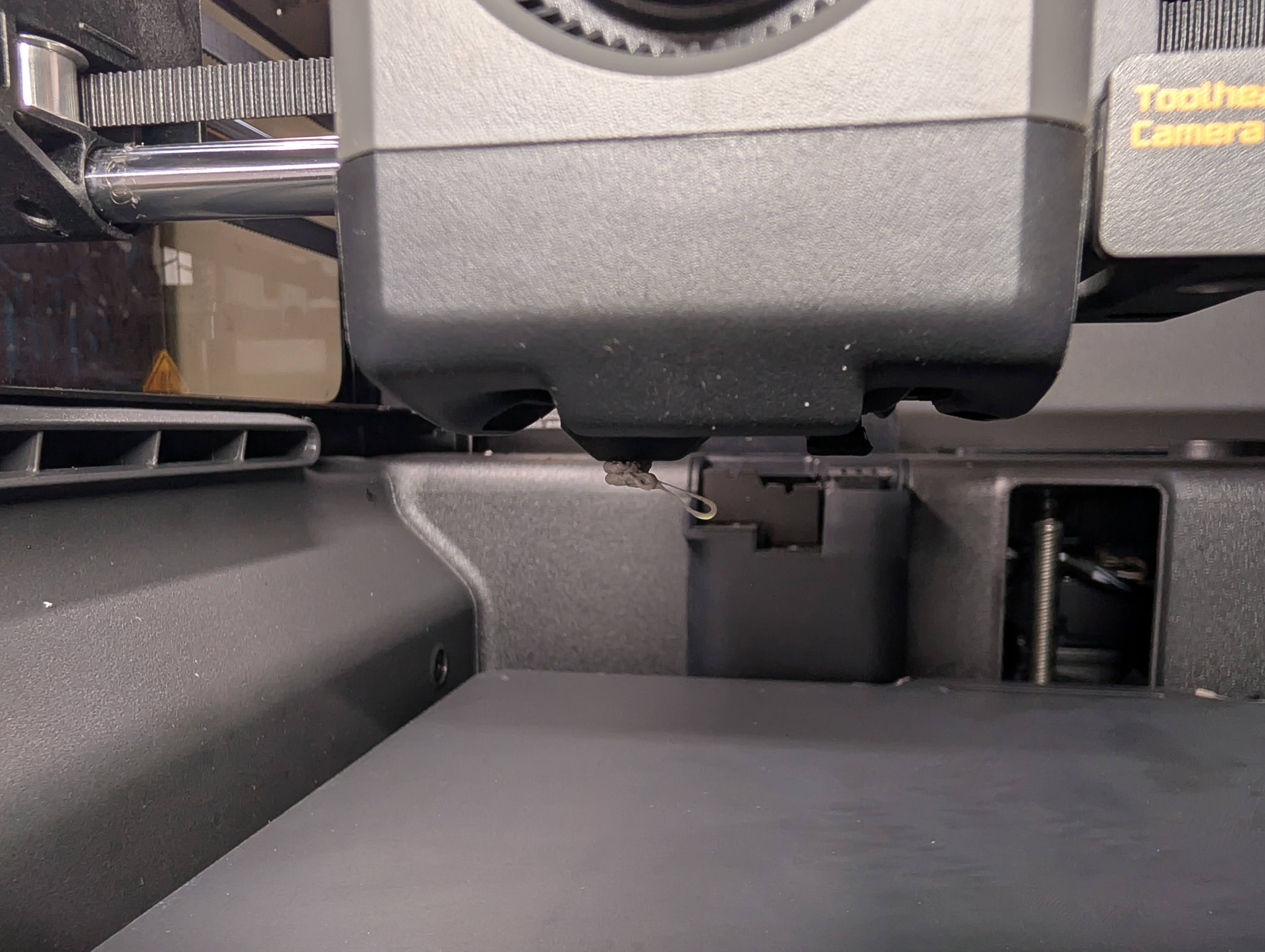

I am having major issues with bed adhesion on my X2D. I am trying to print this spool model:
PETG Basic - Spool A.3mf (1.6 MB)
When trying to print that model I end up with this:
As you can see, because of the total lack of adhesion everything just clumps up on the nozzle.
Now, here’s some context - I previously had an A1 and this exact same model would print without issues. I then upgraded to a P2S and this is when the adhesion issues began. After a lot of back and forth with technical support no solution was found and Bambu agreed to a return. I then purchased my X2D - and as you can see, I have the exact same problems.
I am using stock settings (although during the troubleshooting process they asked me to play with the bed temperatures but this had no effect). I have tried with both PLA and PETG (all Bambu and all dried properly). I have tried different build plates - textured, super tack and even a BIQU Cryogrip (Frostbite). I have added the auxiliary airflow diffusers. Nothing helps. I see videos of people struggling to get their prints off of their Cryogrip/super tack plates… Well mine is the total opposite. Everything comes off with ease.
I know the example I have given is always going to be a bit of a challenge for a 3D printer with those small letters/numbers. But I know I didn’t have these issues with my A1… And this example just shows clearly the problem I am having overall. There is just a fundamental lack of adhesion all round. I am still able to print things but I can just feel the lack of adhesion when I am removing the models from the build plate. And I know it didn’t feel like that when removing the models from my A1…
I haven’t tried using glue - and that may well help. However, I want to try and get to the bottom of what is causing the underlying issue. Does anyone have any ideas/theories as to what is happening here?
Thanks in advance.
Welcome to the forum.
The vast majority of adhesion issues stem from contaminated build plates. So I must ask how are you cleaning your build plates? From the picture you posted you can see the oil marks on it.
Apologies, I should have included that in my initial post. I clean with soap and water. That build plate wasn’t freshly cleaned when I took that picture but I have tried with freshly cleaned build plates and it didn’t help…
I am surprised that support did not go over proper plate cleaning before replacing a printer.

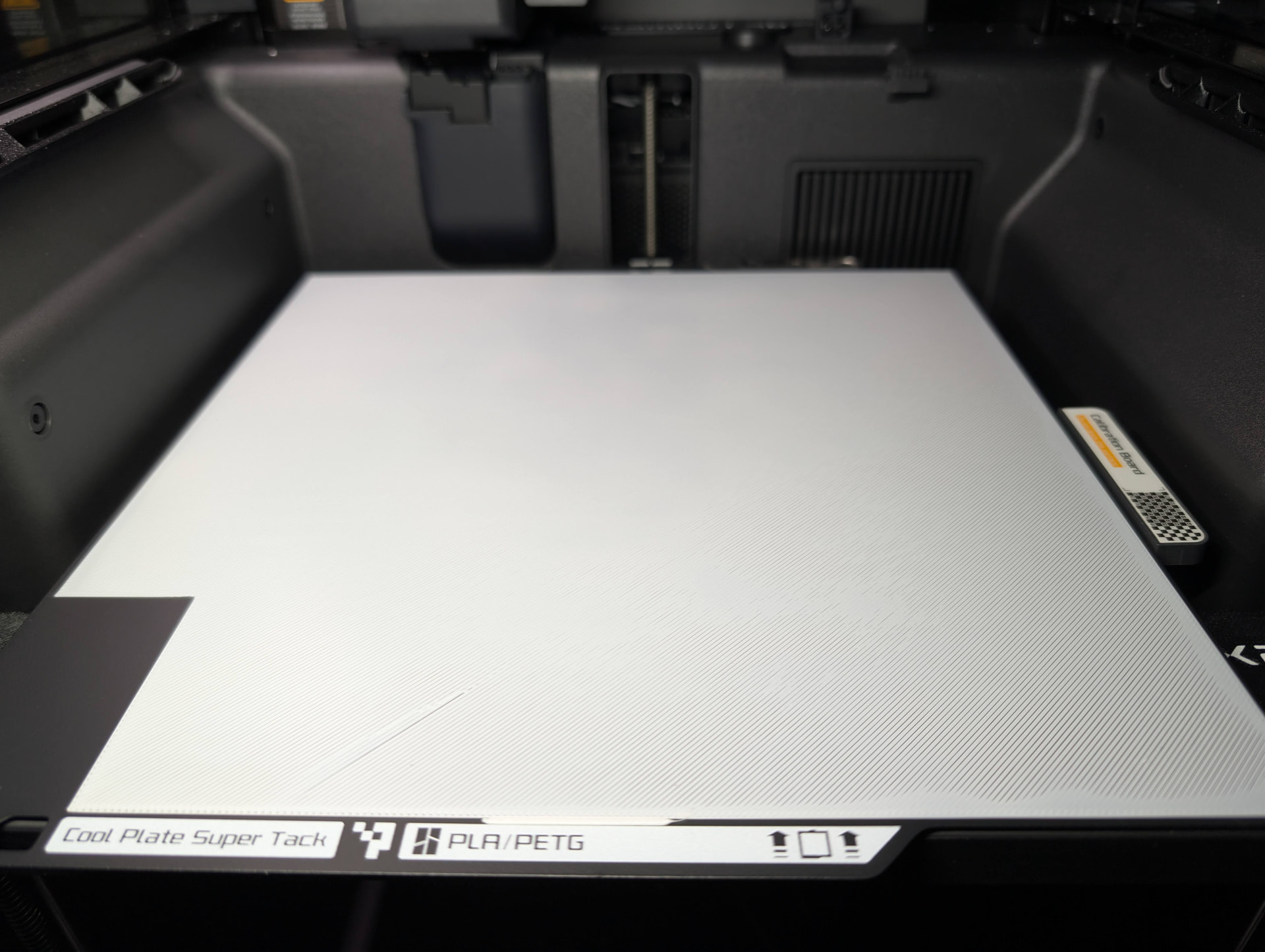

Thank you for this. So I washed the plate as you instructed, preformed a high temp bed leveling and printed a bed cleaner. Here is the result:
Clearly some under-extrusion but that’s a problem for another day. I then tried the spool print again and it did seem to be a bit better… the small elements of the numbers didn’t just clump onto the nozzle like last time. Although they did seem to be on the edge of coming away… However, maybe that’s all I can really expect with those small intricate elements. I will investigate with my other plates over the weekend.
It’s definitely not a power issue - temps are all as they should be. The water is fairly hard here but the plates look very clean after washing. No signs of any residue…
“looks clean” does not mean anything. and PETG (you sure it actually is PETG?) should literally stick to anything, unless your (first layer) settings are way off.
  1. some dish liquids contain hand moisturizers (i.e. oils - for your skin) that immediately destroy any adhesion on any pei sheet - this is very likely the root cause in your instance.
  2. IPA (not to be used on cryogrip and supertack afaik) just spreads oils around, it doesnt remove anything (though i am wondering if there are IPAs out there that also contain oily residues/impurities) The IPA i have only gets used for the releasing of TPU prints, NOT for cleaning (because it makes bed adhesion worse)
  3. some glue sticks actually make adhesion worse. I suspect that they have additives that also have a negative effect. Generally i like to avoid glues, in 99% they are not necessary anyway.
  4. for PEI - acetone (pure acetone, not some ■■■■■■ nail polish remover with additives) is your friend. That stuff actually removes oils. Been using the stuff on pei sheets from when they started to become a thing, years ago. never ruined one with it… make sure the sheet is cold (otherwise the acetone evaporates too quickly) and only wipe the sheet with a towel with some on it. dont soak it. DO NOT USE ACETONE ON THE CRYOGRIP AND COOL PLATE SUPERTACK… only the pei, dont overdo it and itl be fine.
So to sum up how I get to get the textured pei to work/stick with PLA, PETG and ABS:
  • wash with warm (no need to burn your hands) water and dish soap without any perfumes/additives/hand moisturizers - very important!
  • use a clean and brand new scrubber/sponge (not the one that you use to clean your frying pans, that one will be full of fats/oils), make plenty of foam, let it sit for a minute or two and then rinse it off… you could consider doing an after rinse with a bit of destilled water if the water in your place is too hard. (but id try without, should not make a difference)
  • after that let the build plate dry, or wipe dry with a clean dry paper towel
  • soak paper towel with acetone (only for PEI!). give the build plate a good wipe with it. dont soak the plate
  • never ever touch the plate with your bare hands after that. dont even think about touching it or your pei sheet will lose adhesion on that spot…
  • print.
Great. That looks perfect.
If you want to go over fixing under extrusion we can do that next. It only takes a few minutes.

Thank you for these detailed instructions! So I gave my textured sheet a thorough clean and, fingers crossed, it seems to be sticking! I guess maybe before I was using the wrong kind of soap that had some kind of oil in it like you suspected. I haven’t tried with all my plates and I’m pretty sure the cryogrip failed straight out of the packaging… But maybe you’re meant to clean them before using even if they’ve never been touched?
Anyways, thank you all for your help. Seems to be working now!
