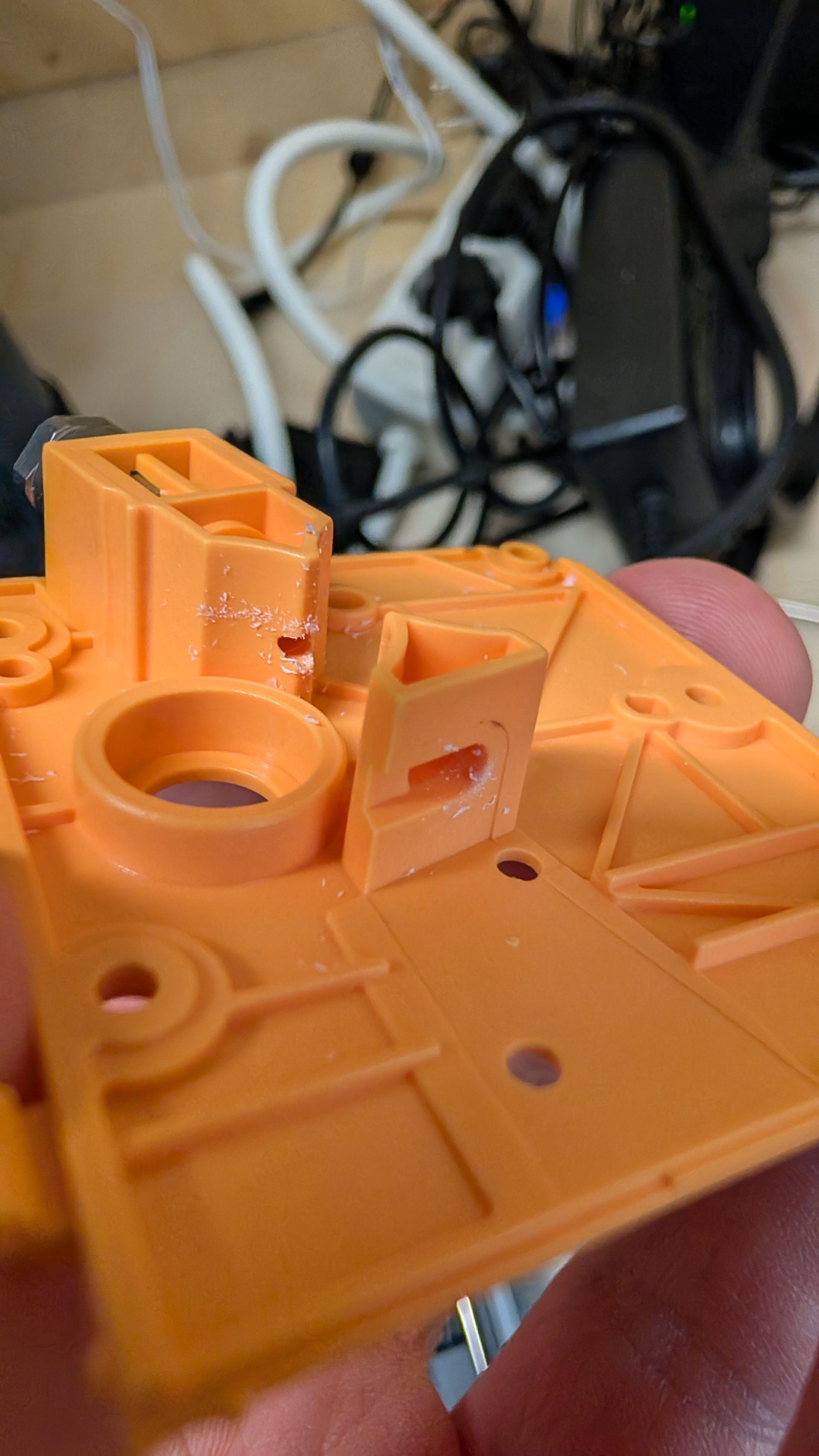

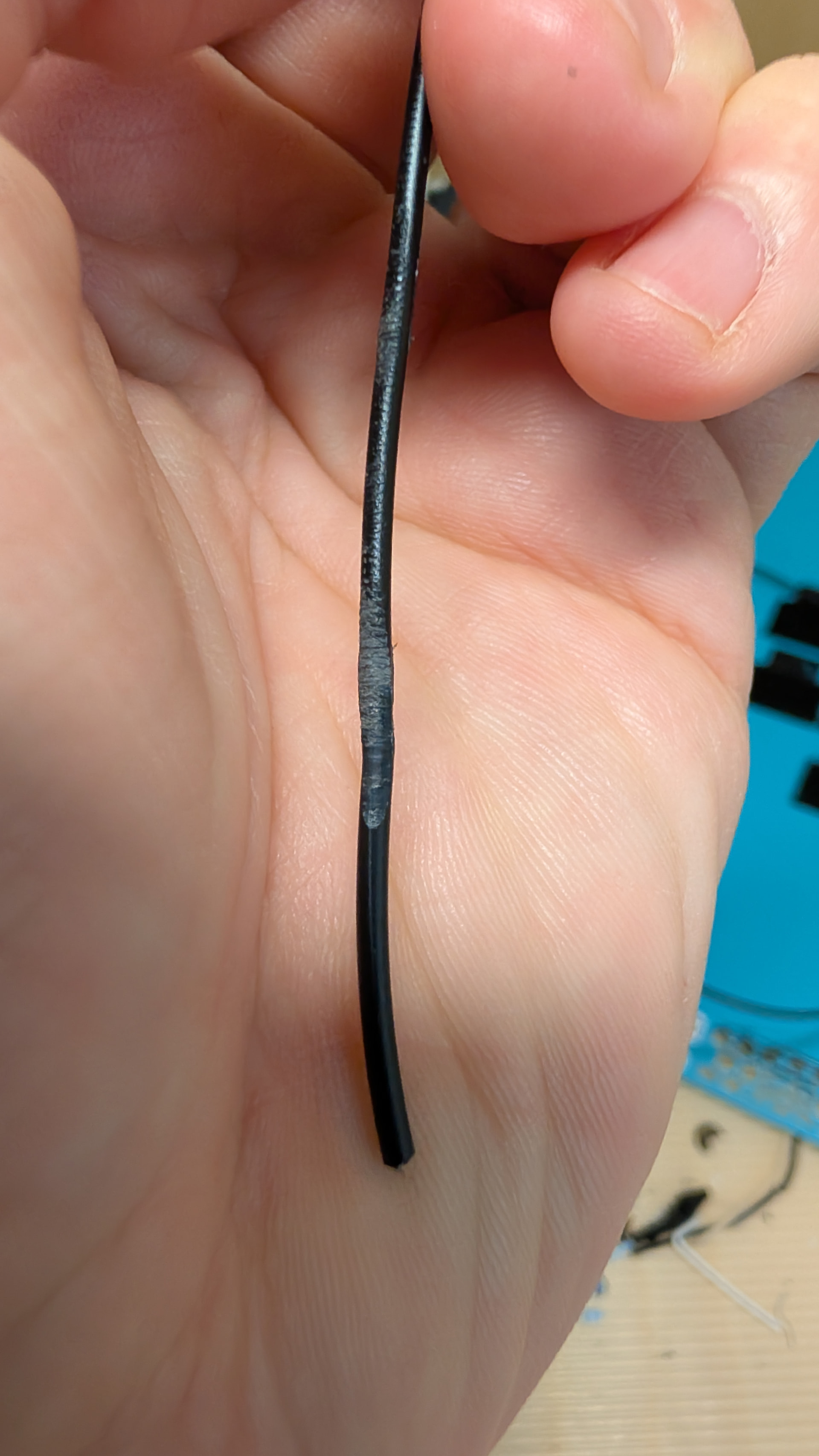

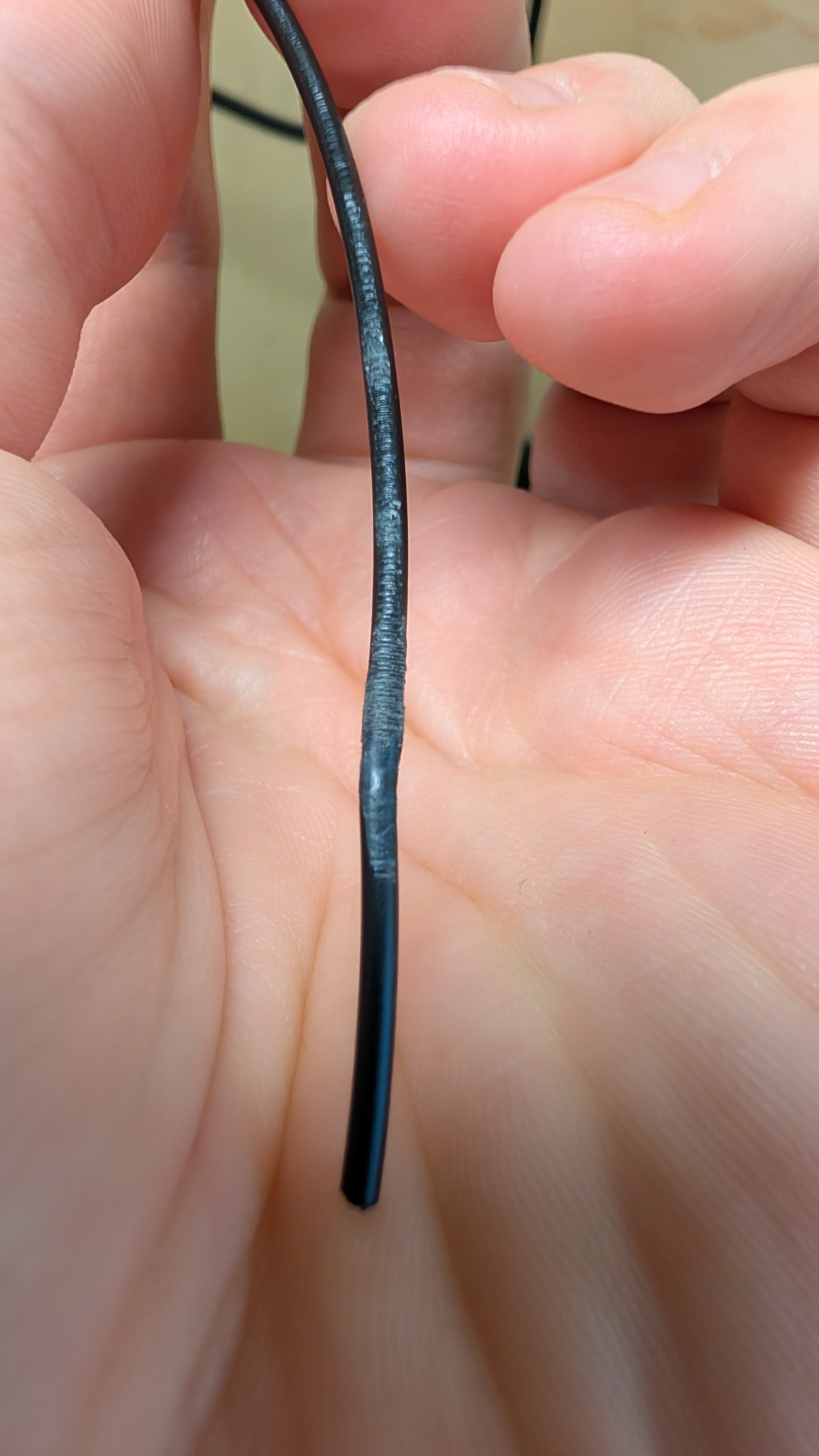

I have some issues after only 2 prints with the Bowden Extruder.

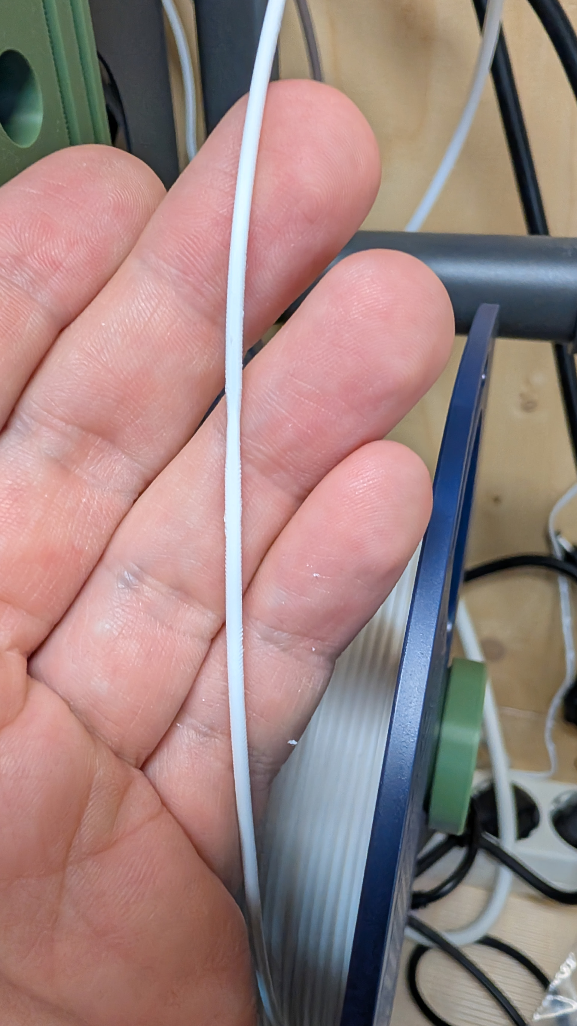

I noticed that the end of the Filament looks like it has been squished:

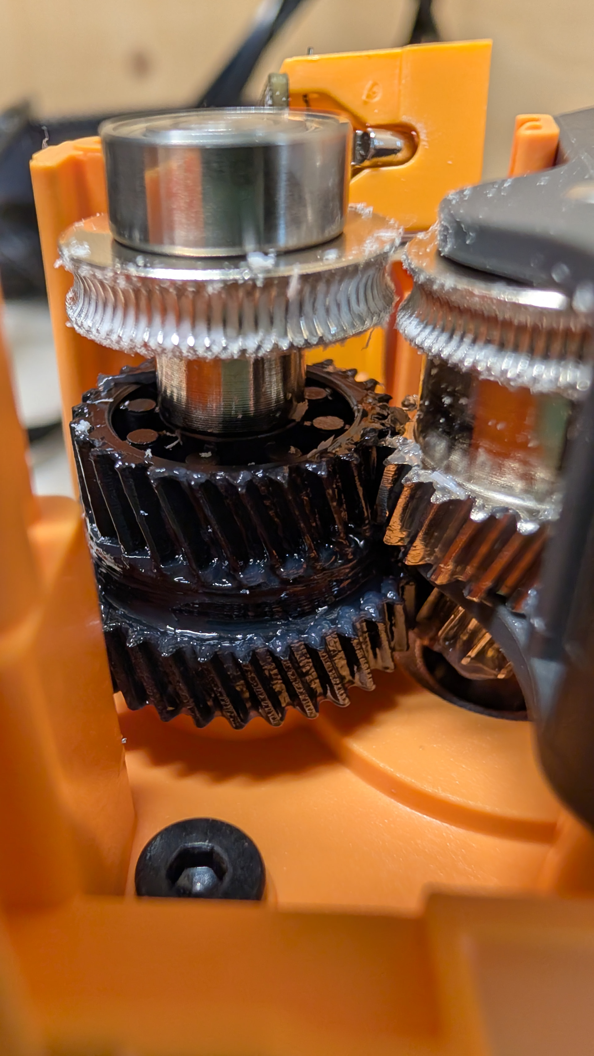

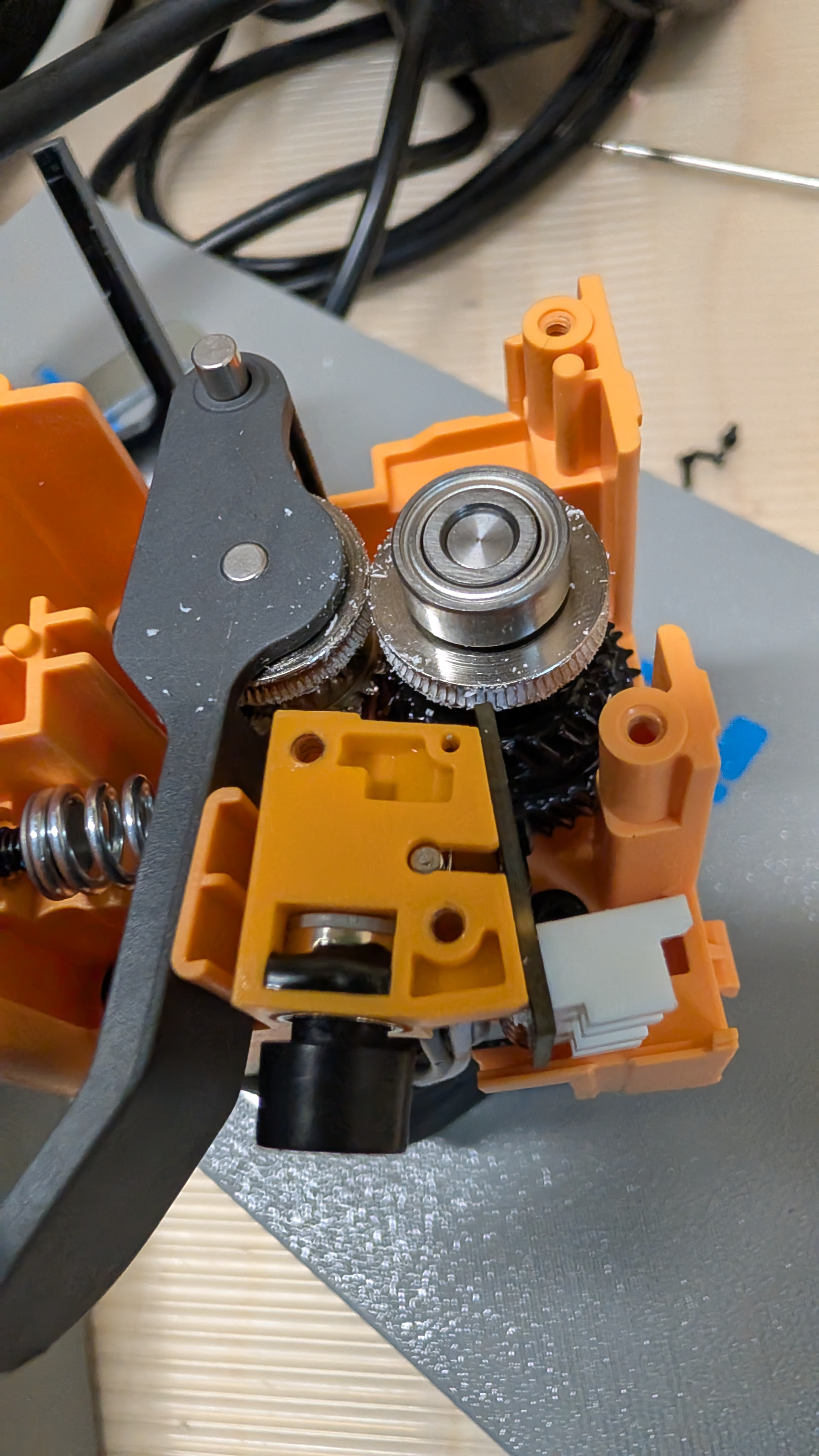

After disassembling the Bowden Extruder it does look pretty clear:
I’ve heard of some Heat Creep being an issue on their wiki. The Filament I’ve used was very dry (dried it for 12h). Printer is pretty new with just 2 months old and only 2 Prints with the Bowden.
I’ve been told that this can be a tension issue but it doesn’t seem like we can adjust it at all since there is a spring that is fixed.
The Filament in the gear is stuck. What are my options here besides trying to clean it?
Anyone else had this issue?
To me it looks more like grinded, and seems you have a lot of small particle from the filament inside, so maybe worth to open a ticket and check it with Bambu?
There are some issue reported around the forum which needed replacement of the extruder.

Maybe you can check also if PTFEs on both ends are seated nice and flat. And if nothing there maybe try to do some prints and try to see what happens. Maybe the retraction is not working well, or the spring is too aggressive.
I would expect if you have heat creep going to the extruder wheels the filament inside the PTFE tube and the nozzle should be very soften also.
Do you see any issues with the print quality? And do you have printed different material in the main nozzle at the same time?
So far no. Just pure PLA. If I print PETG than just on the Main nozzle

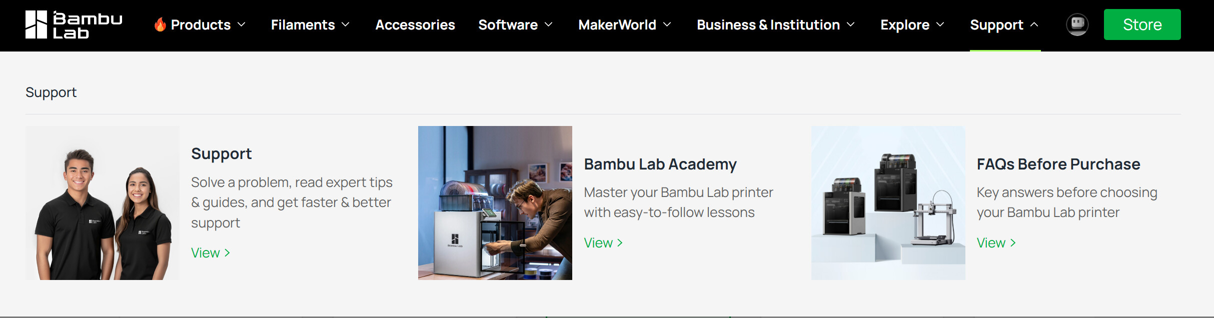

P.S. it used to be easy to find the “Community” and the “replacement parts” on Bambu’s site. Interestingly, those have gone away. Takes a Google search to find them now. Hmmmmmm…

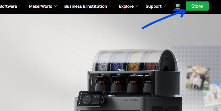

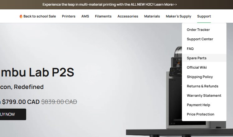

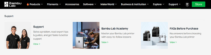

They moved “Replacement Parts” under the “Support” tab and named it “Spare Parts”.
I don’t get a drop down menu when I click on support…

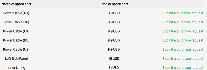

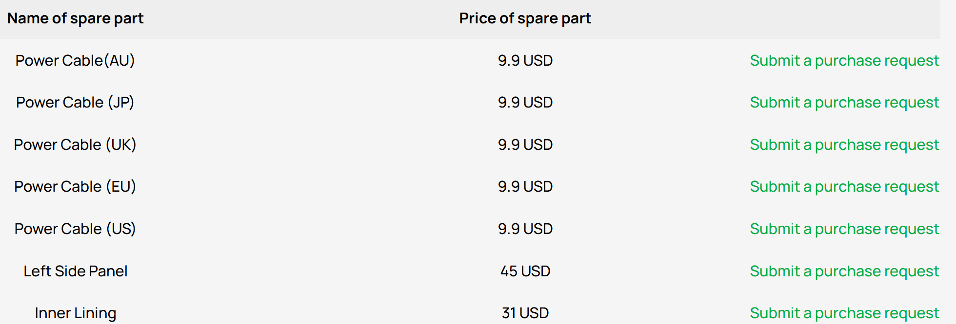

I did find the spart parts area in the full support site though, but seems you can no longer just purchase parts, but instead you have to submit a ticket to support in order to purchase parts.
…and very few parts are available now. This does not bode well.
You have to enter the Store…
The Bambu site is a world wide landing page. The Store is specific to your region.

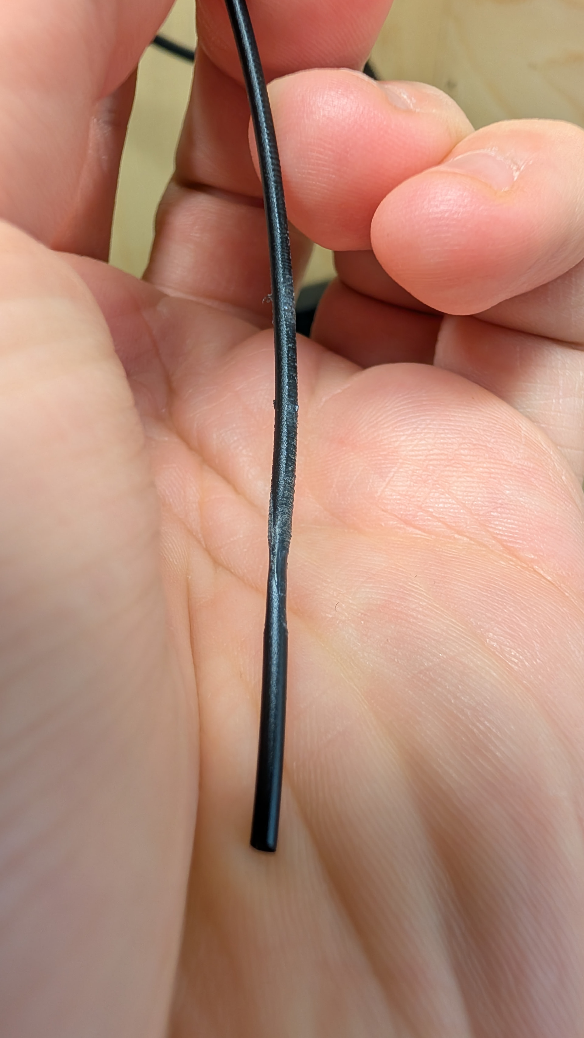

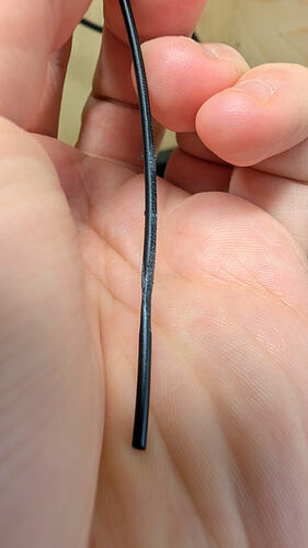

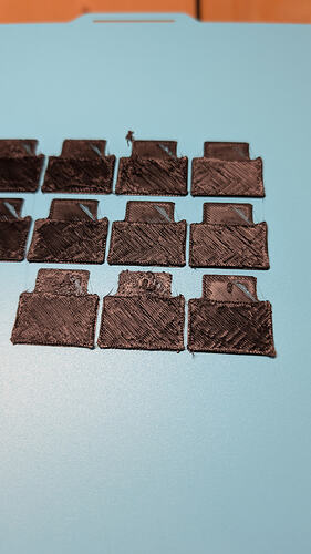

So, I received it and did a few prints and well… Its the exact same issue with different filament brands (all PLA)
the filament looks squished at one point again. It happens every time at the same position on the filament after unloading it so it must be grinding within the extruder.
Now I’m thinking if the buffer could cause this? What do you guys think?

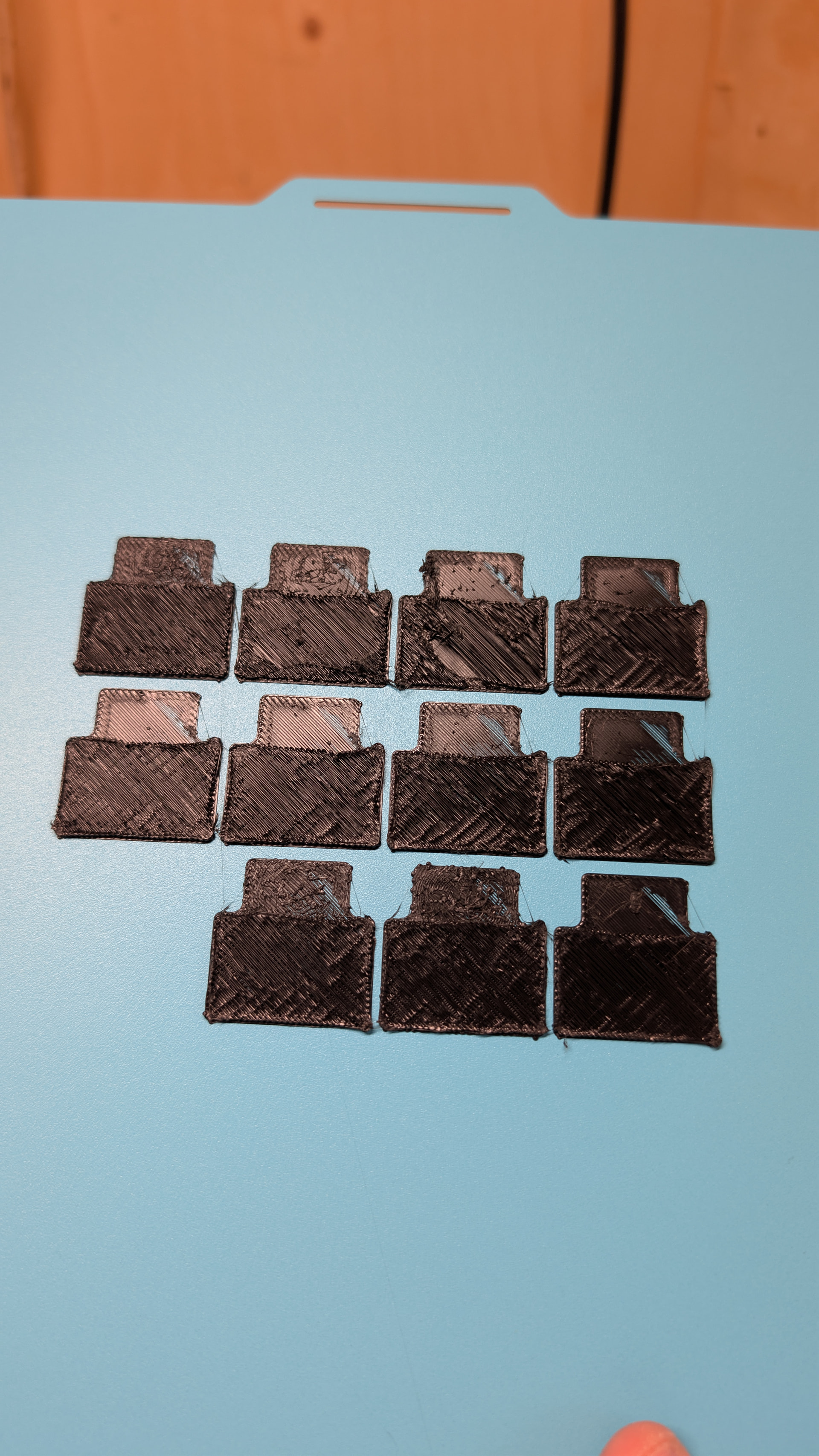

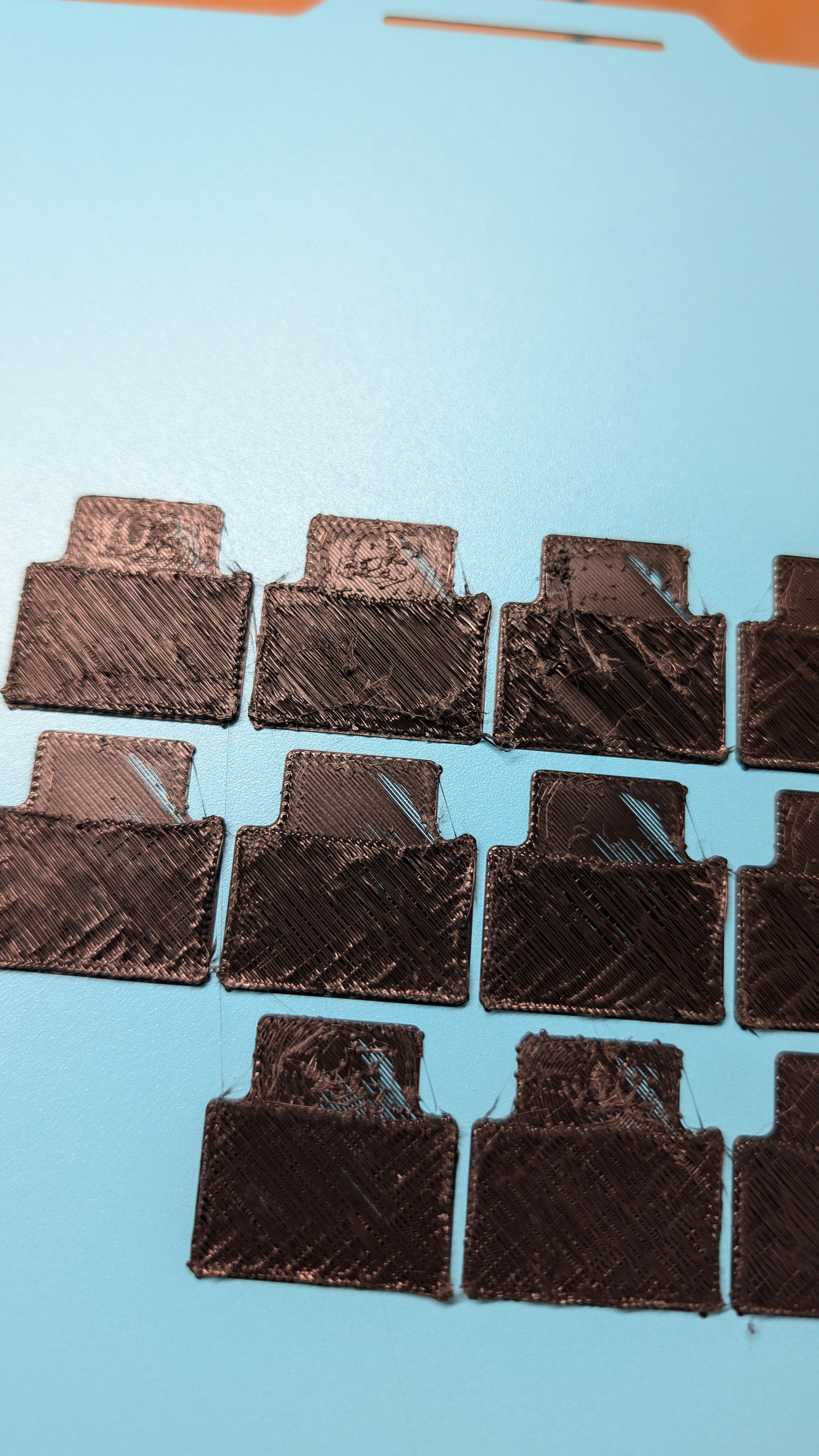

I used a PTFE tube from the external holder to the aux extruder and the results were “better” (still not good) by bypassing the buffer which seems to be the issue here.

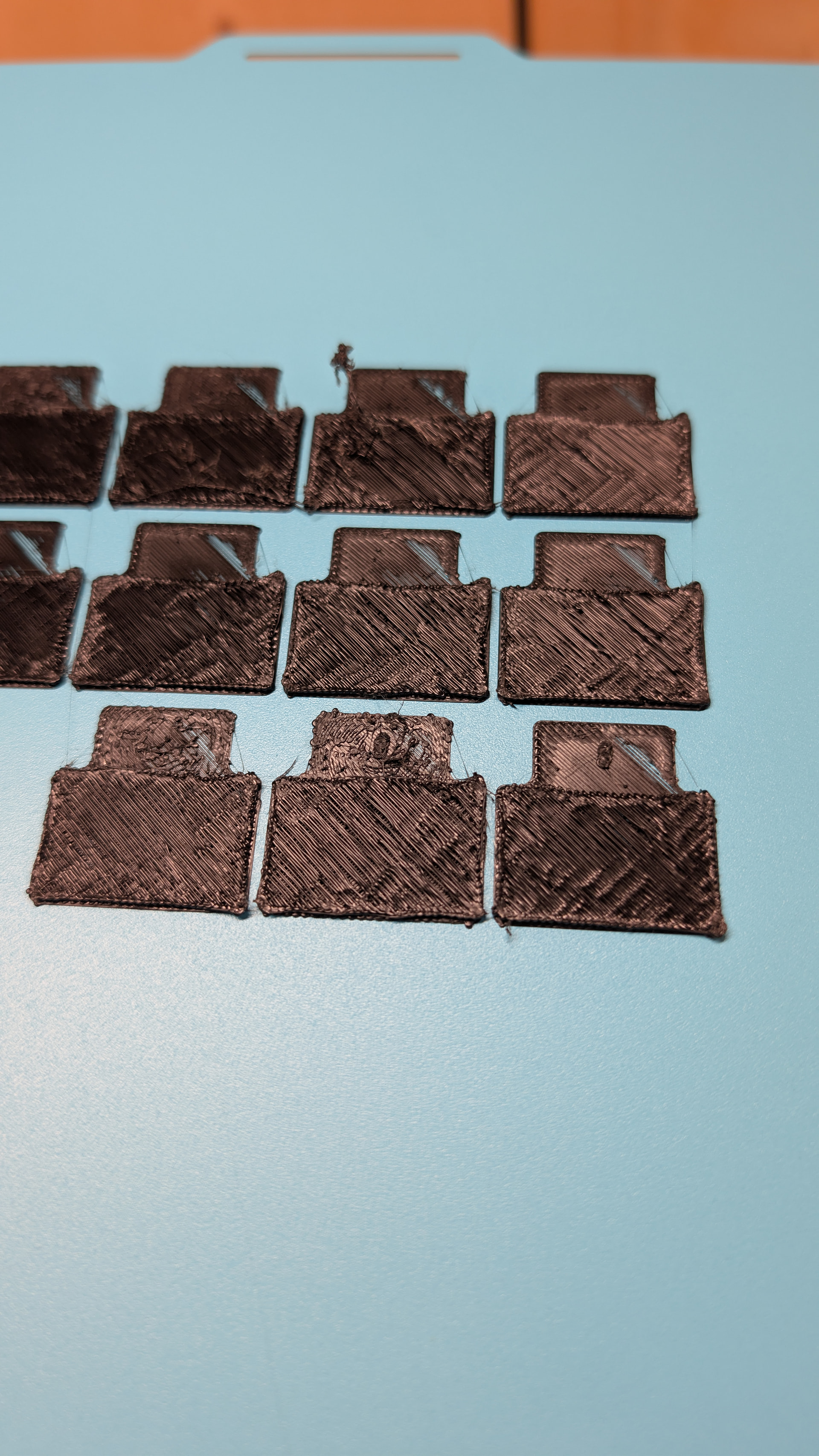

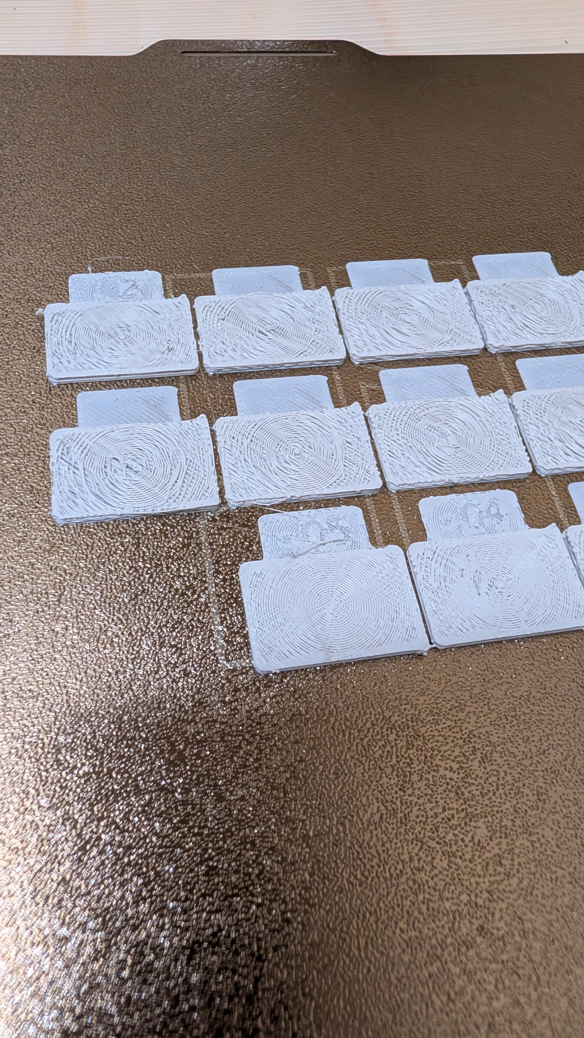

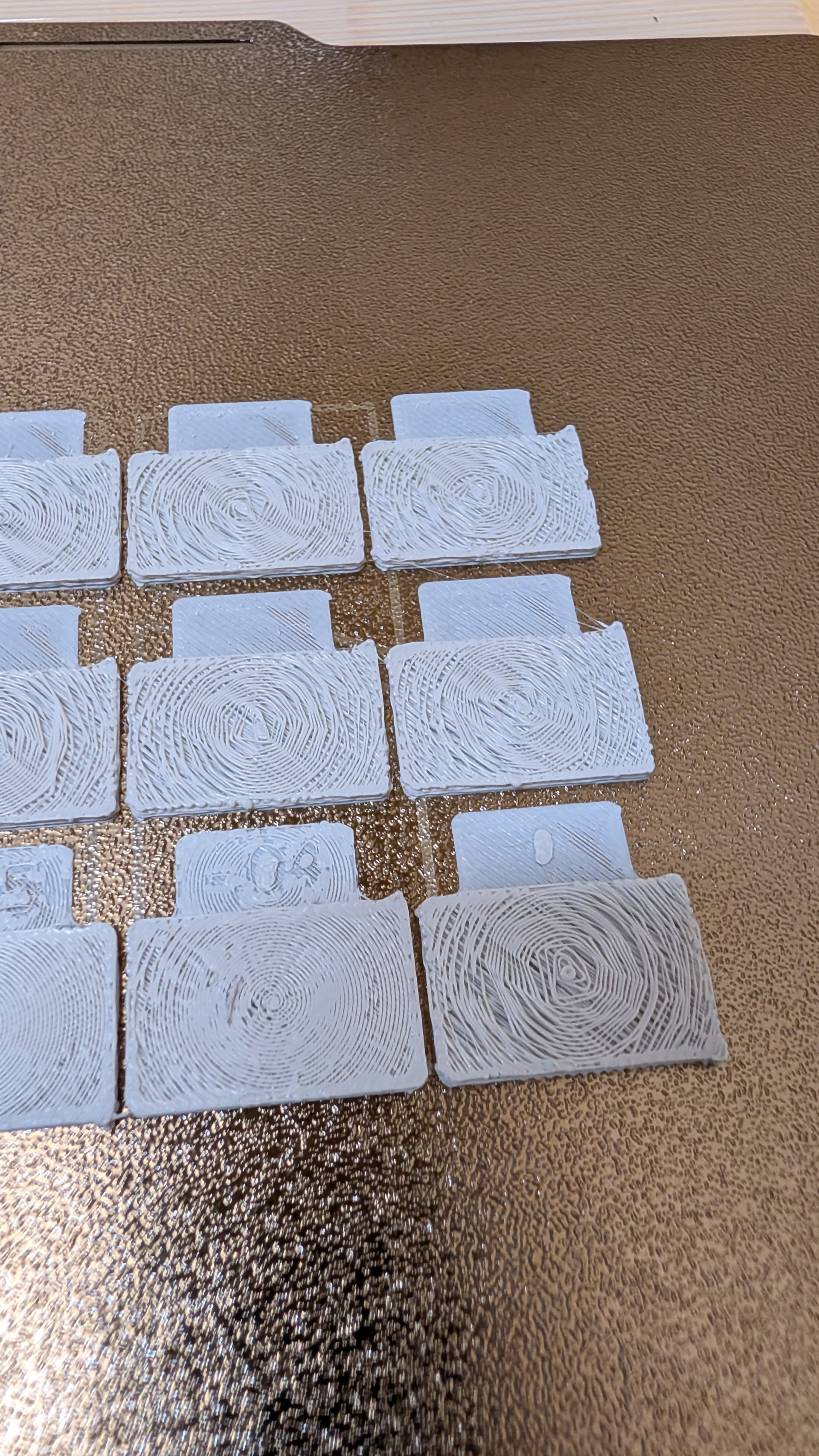

the results:
Does anyone have a clue what the issue could be now? Seems weird to me that the buffer is actually causing the grinding issues on the extruder
That’s severe under extrusion. Look for any piece of filament between the extruder and the nozzle. Something is retaining the free movement of the fimalent.
Hmm so I have to disassemble the printhead or just check the PTFE tube?
I was running into the same issue, but with a third-party hotend. I was able to solve it by doing a cold pull. Have you tried doing this?
