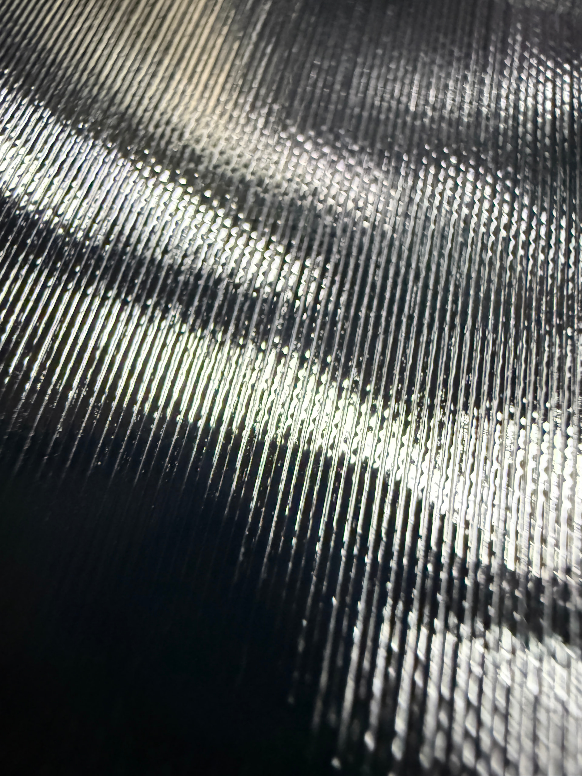

Received my X2D almost 2 weeks ago, since then I haven’t been able to properly calibrate ONE of my spools, no matter what I do the top layer always comes out with ann horrible crisscross pattern that’s typical of the underextrusion symptoms…except that it happens even at 1.05 flow rate with the very same spool that on the A1 mini printed perfectly at 0.983 flow ratio. Yesterday I even dried the filament a bit more (12hrs at 55c) since with the first batch of tests I saw some oozing.
For this test I’m using Anycubic’s Basic PLA
But what are talking about exactly?
THIS
This is a shrinkage test block, no edits done to it, straight from makerworld.
Bottom piece is from the A1 mini, see how the lines are straight, proper and catch the light the same way?
Now look at the top piece from the X2D, mind you after rounds of flow calibration I landed at 0.975 which seemed to be a good choice, and yet it looks like a piece of yarn, irregular lines full of little pock marks, at a distance it doesn’t look that different but the moment light gets onto it you instantly can tell the difference
What did I do to try to solve this?

Sunlu PLA+ 2.0, the square is the test piece on the X2D while the printed part under it is a previous print from the mini, you can sort of see the same effect on the Mini part, but only before walls, afterwards it’s a straight line
Lastly a piece with 1.05 flow ratio af the Anycubic basic, I’d expect ridges bumps and what not but it’s just a little rough that is all
Anyone else experiencing this issue? I’m at my wit’s end especially since the return window is VERY close by, I’m not expecting perfection but you know I’m at least expecting the same quality as the previous printer…

Just one theory: Maybe it extrudes at too low a temperature and therefore underextrudes at higher speeds? You could rule that out by cutting all speeds in half. If that solves the issue, the temperature sensor might contact the heating directly instead of the nozzle, causing significant lower temperatures in the nozzle than it reads back.

I’m already at 220C which is the upper limit for that filament, if anything I should be easily overextruding. The rippley/crosshatch effect also appears at 50 mm/s top layer speed. About the temp sensor wouldn’t that result in everything underextruded and not only the top layer?
I’m having the exact same issues with X2D. Gaps between the lines on top layer. Can be helped with dynamic flow calibration to some degree.
See the two parts - one printed on X2D one on P1S with 3000 hours on it. Somehow P1S top layer quality is better!!! It’s shocking and very disappointing. I hope Bambu acknowledges the problem and have some solution in the pipeline.

As intended by BambuLab, you have a thermal chain and at each transition you loose a bit of temperature. E.g.
Heater (230°C) → Hotend (215°C) → Sensor (214°C). So the heater has to actually get hotter than the desired hotend temperature, especially when more filament moves through the hotend consuming heat.
When the sensor touches the heater directly, the actual hotend temperature might be far lower than intended.
When flow is really low, then
1.) the temperature drop (heater → hotend) will be lower because less heat is drawn away by the filament and
2.) the filament prints fine at lower temperatures when printed slow. “In the old days”, it was very common to print PLA at 190-200 °C for better overhangs and deliberately increase the temperature only when printing fast.
I would not only reduce top speed but also all other speeds. Typically when the layers below top are underextruded, you will get gaps at the top even when flow is perfect, because the top layer also fills the gaps in the layers below.

Just as a reference, I switched from X1C to X2D and I was seriously impressed by the improvement in quality. Especially outer walls are far more consistent and all VFAs gone. Top surfaces also are slightly better at the edges. I have the feeling, that automatic flow dynamic calibration is far more accurate.
So I’m convinced that your machine is somehow defective like apparently many other. Unfortunately it is not easy to track down. I wish you best luck in finding the issue and will think about other possible root causes.
Well, my walls are like yours. Smooth and vfa free so there’s that. As for the max volumetric flow it’s already down from 18 to 12 mm³ but this happens with filaments that run at 22mm³ too.
