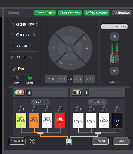

Just like most of the Bambu line-up, managing the aux fans are an absolute pain and cause so many issues.
With the X2D having 2 aux fans that blow directly onto the plate, it seems even more important to be able to manage them properly. They cause adhesion issues and there seems to be no way to turn them off or down.
This is where this setting should be managed, however with these exact settings, both aux fans adjust up and down at their own will. A print happening right now has both fans at 80% which is extremely noisy and there’s a high risk of the print warping on either side.
Is there a reliable way to manage this properly (or even completely disable) on the X2D? I am currently printing deflectors for both sides, but it’s just so loud and I would prefer a software solution.
If Bambu can give a good reason for the following default setting for PETG filament (Bambu’s profile), I’ll drop the topic and accept that it is a valid setting.
Everyone knows how powerful the aux are or can be…. so please explain to me what part of PETG printing requires they BOTH blast cool outside air right at the plate and part at 100% for pretty much 100% of the print when chamber temp itself is in the 30s???
What’s worst is no one knows how to set these fan profiles because they seem to ignore whatever you set in Filament profile under Cooling-Aux Fan settings as OP mentions and is reason for this unanswered post. Literally no one knows? Including Bambu Staff?
Where are you seeing these settings? You mentioned the filament profile, but I don’t have that view?
These are from the screen or the Device window AFTER the print starts and you can modify it while it’s printing. Click on “Fan” But you you’d have to do that every time you start a print (or remember).

Ran into this same thing on my X2D and dug into the actual G-code to figure out why. Here’s what’s going on:
The custom fan G-code only sends real M106 commands (which follow your slicer setting) for the first several layers. After that it hands off to a single M142 P1 command and never touches the fan again for the rest of the print. The problem is that command has a hardcoded ceiling — 100% for PLA/TPU, 50% for PETG — completely ignoring whatever you set in the Cooling tab. That’s the value you’re actually seeing on screen.
Fixed it by editing the Change filament and Layer change G-code (Printer Settings → Custom G-code) and swapping the hardcoded ceiling on the four M142 P1 lines for the real filament value:
M142 P1 R30 S40 U{additional_cooling_fan_speed[current_filament_id]/100.0} V{additional_cooling_fan_speed[current_filament_id]/100.0} O45
(swap in next_filament_id for the Change filament field)
Setting the floor and ceiling to the same value matters — there’s also a floor variable in there tied to something Bambu doesn’t expose anywhere in the UI, and on a mixed-material print (PLA + PETG support) it can end up higher than your ceiling, which breaks the whole range. Matching both to your actual setting sidesteps that too.
Don’t touch the exhaust fan line (M142 P6) — that one’s fine as-is.
If you want to confirm it actually worked: re-slice, open the .gcode inside the .gcode.3mf, and search for M142 P1 — you should see your real percentage instead of 1.0/0.5.
Heads up this is all reverse-engineered from testing, not official docs, so treat it as a working fix rather than gospel. Also worth filing with Bambu directly — a hidden, non-adjustable value silently overriding your filament settings seems like a real bug, not intended behavior.
