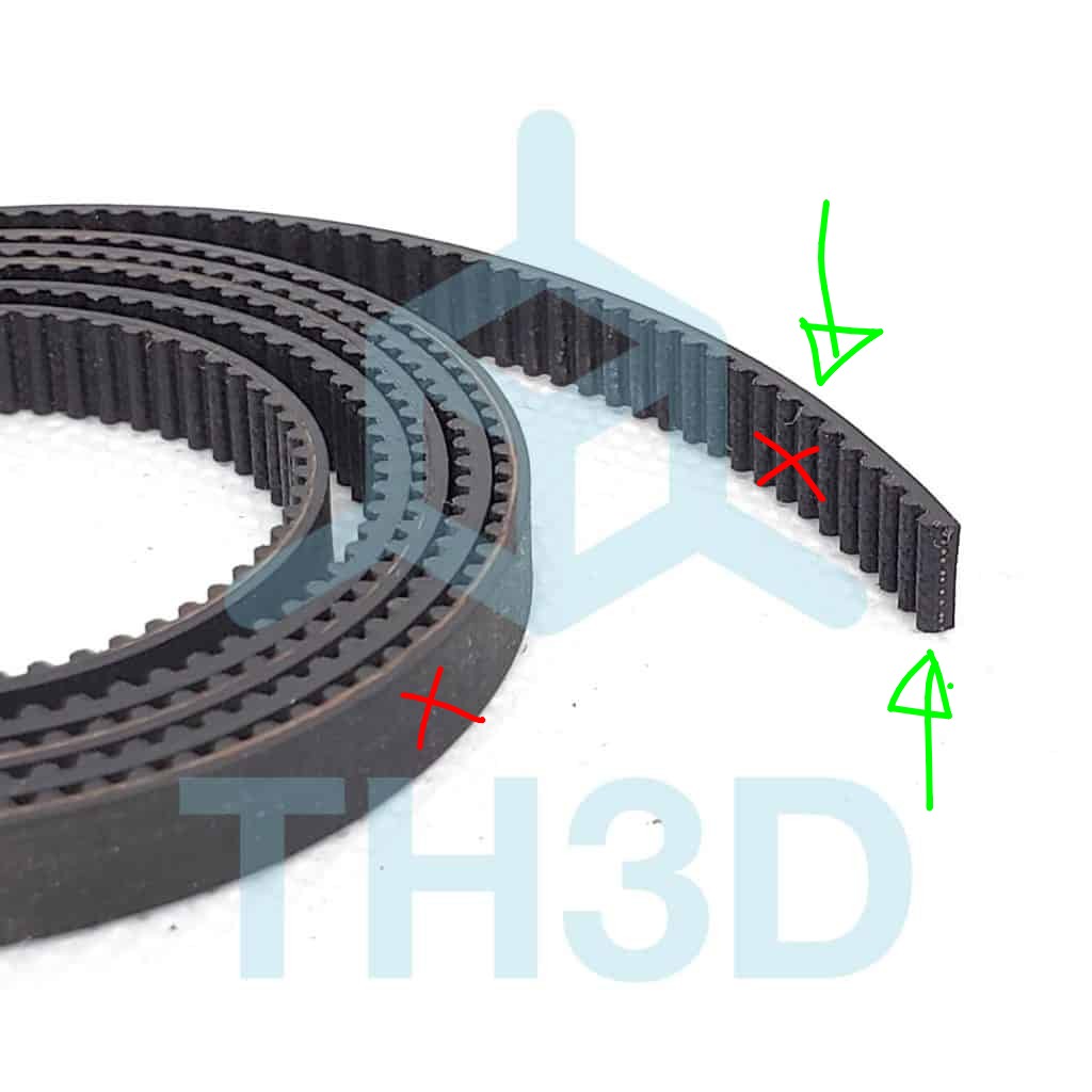

I just got my X2D and I noticed that it has a really noisy Z-Hop compared to my X1C’s. It almost sound like a squeaking or like a dog whimpering (I thought it was my dog at first making that noise lol). Anyone else having an issue with it or know how to fix it?

Usually, a squeak might be related to the sides of the belt rubbing against the pulley flanges.
Adding a very small amount of grease on the side of the belt should help solve it.

Honestly, it just stopped being noisy haha. Maybe the belt needed to wear in a bit or something.
Could you please explain further where to put grease? on the inside of the belt?
Sides of the belt that rub against the pulley flanges.
