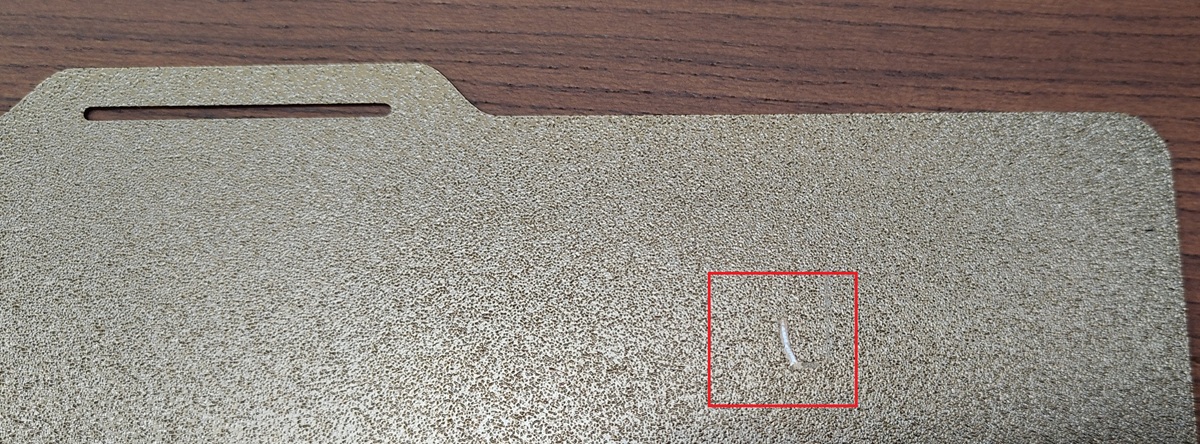

After more than 100 hours of normal operation, my X2D suddenly scratched the top-right section of the print bed when I initiated a bed-leveling procedure via the printer’s UI.
I launched the calibration function, I walked away the printer and after some time I heard a loud scratch sound, so I looked inside the printer chamber noting that the nozzle was performing its typical initial cleaning movements in completely wrong place (that you can see in the photo), tearing off the surface coating of the build plate.
It seems that the offsets following the homing process were incorrect, at least for the Y and Z axes.
I should clarify that the printer chamber was clear and clean, as was the nozzle (I found no plastic residue anywhere).

Bummer. I wouldn’t be too worried about the scratch, but I’d be worried about whether it did anything to the head or other parts of the head movement hardware. That’s a pretty deep scratch. It would take significant force to cause that.

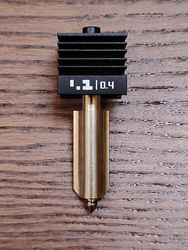

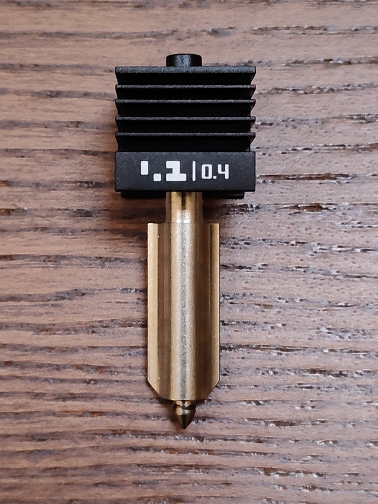

The hotend does not appear to be bent, It’s hard to say whether the rest of the head has suffered any damage or not, but at first glance I’d say no.

Are you sure it was the nozzle tip that made contact and not the nozzle cover? I suppose the nozzle cover would be badly damaged if it made contact that hard.
And was it the primary or aux that made contact?

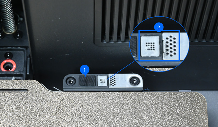

My understanding here is that bed pressure sensor signals were not taken in consideration during that phase, where normally the nozzle tip is not touching the bed plate but the lateral cleaning surface.
I also own one A1 mini, one Anycubic Kobra 3 V2 and one Centauri Carbon (that self destroyed the hotend almost out of the box due to a bed assembly problem) with several hundred hours of printing activity each so I have some practice to understand what is going on.
Exactly, not only the Z offset but also the Y offset because during the tip-cleaning phase the printer head was performing the usual tip-cleaning movements on the damaged bed plate section (that you can see in the first post image) in place of the dedicated pad that you can see in the image attached to this post.

I have a similar scratch on mine. I wasn’t watching when it happened. It happened when I had less than 100 hours on the machine. A picture of mine would look a lot like yours.

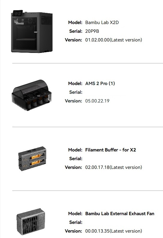

A couple of questions :
  1. the printer FW versions are the same that I showed in my first post (see attached image here) ?
  2. have you contacted the service ?
Using the same firmware versions and didn’t contact support (yet).
