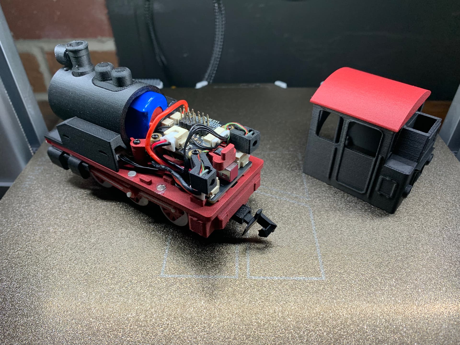

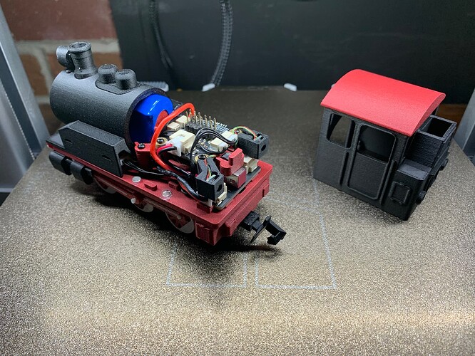

I received my kickstart kit yesterday (all for the pieces where there) and finished the first locomotive this morning. It was a challenge for me (small parts-stiff hands-poor eye sight) but fun. I haven’t ran it yet, but here is hoping. The only instructions to assemble the loco, controller, turnout controls, was the video on X’s CyberBrick page. So I watched it while building the loco, pausing, backing up, watching, pausing over and over. The parts fit very well, snaking the wires was a little challenge and I will do some wires different when i build the second locomotive. I will be building the controller next. Then we will see if it will run. Jim

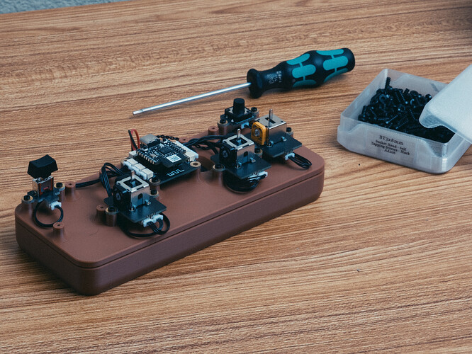

Unless you are planning on designing a controller of your own, you may prefer to use a prototype controller to test that things work.
Mine:
The one from @Josh-3D

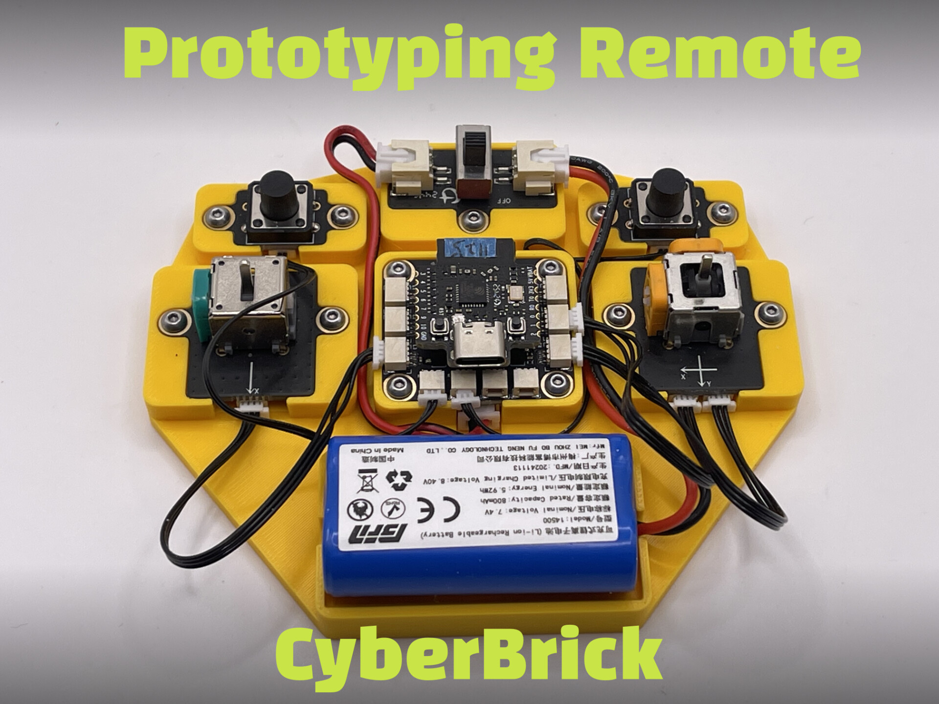

Who would have thought…So my train isn’t working. “If at first you don’t succeed…read the directions”. Just because I have been modeling for 72+ years doesn’t mean I know what I am doing, so I need to figure out how to make this thing work. Good thing I am retired and have lots of time. Printing out MalcThe Oracle’s prototype controller board now, going to use it to program and test out components and will see it things are/ can get them working like they should. So going to disassemble the locomotive electronics and start over.
Also, Would like to have a pilot light on the controller in order to know if it is turned on and some way to recharge the batteries with out having to take it all apart.

The only LED on the controller is on the board itself, I am not even sure the transmitter can drive LEDs directly. Possibly using the lower-level programming environment.
I would suggest to anyone who chooses to design a controller, to locate the transmitter in such a way that the LED can bleed through thin surfaces or below a hole in the model.
I suffered a poor connection and it was hard to know when debugging. This was part of the reason I design the prototyping remote control board. Easy to swap out parts and cable, access to the battery (Blu-Tack FTW), plus, a quick print.

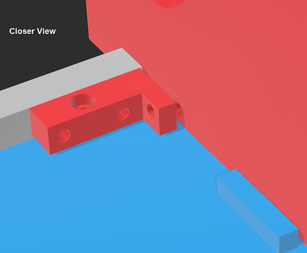

I don’t know about the rest of you, but i could use help putting together the bridges. Xiaoqiang has let up down here…If any one could post some photos, especially from the underside, showing how the components are connected, that would be great. Thanks.
Are you still looking for information about putting the components together? I have just found this train thread and am glad you started it. During the build of my engine I ended up making some changes that made it much easier to build. I wondering if this is similar to what you are experiencing with the bridges.
Hi thanks for responding. Yes, I was wondering how the bridge decks are fastened to the piles at the ends there’s brackets and screw dimples but no clear photo how it is fastened. I didn’t have any problem with the locomotive, just followed the video but then it was so long ago I really don’t remember. Glad you found the thread, wish more would…
Okay now I understand what you are looking at. I will have to take a look again at those parts to see if I can help. I have been making quite a few modifications to the locomotive during this build. I can post some of the modification photos and such here if you or anyone else is interested.
I looked at the parts and some of the assembly notes. I can see how this would be confusing. I first thought there was a mistake but I figured it out. Here is how you assemble them.
  1. Secure brackets to deck.
  2. Secure side to bracket / deck assembly.
  3. Secure pylon to full assembly by sliding pylon up against “stop” which will align it to each bracket. Then it can be secured.
Some photos of the assembly process that I put together with the parts in CAD.
Thank You, Thank You…Those photos make sense, I will give it a try.
Your welcome glad to help out. You will have to let me know if you are able to assemble it completely. I would like to see how yours comes out.
I will post some photos when I get them together
