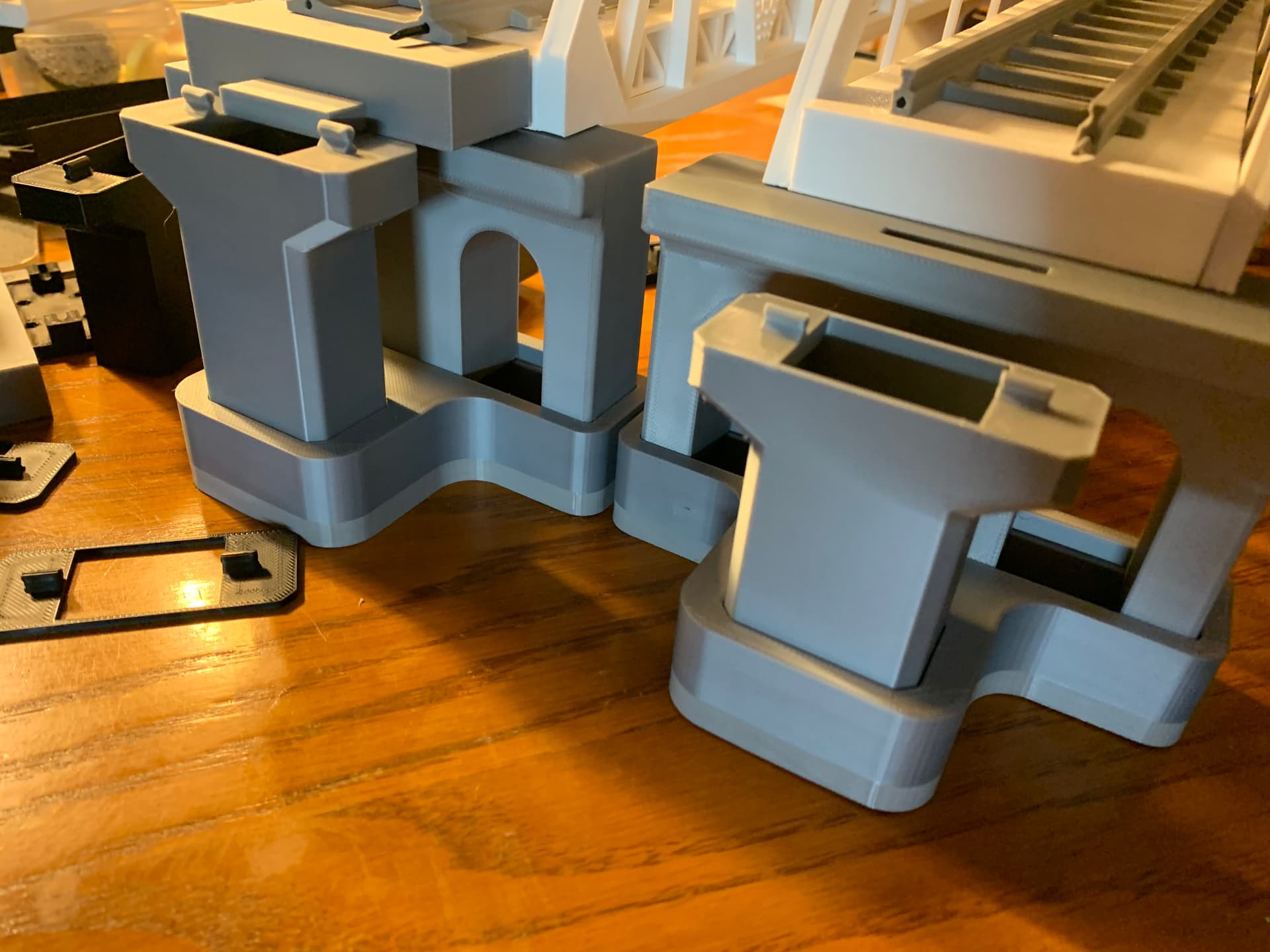

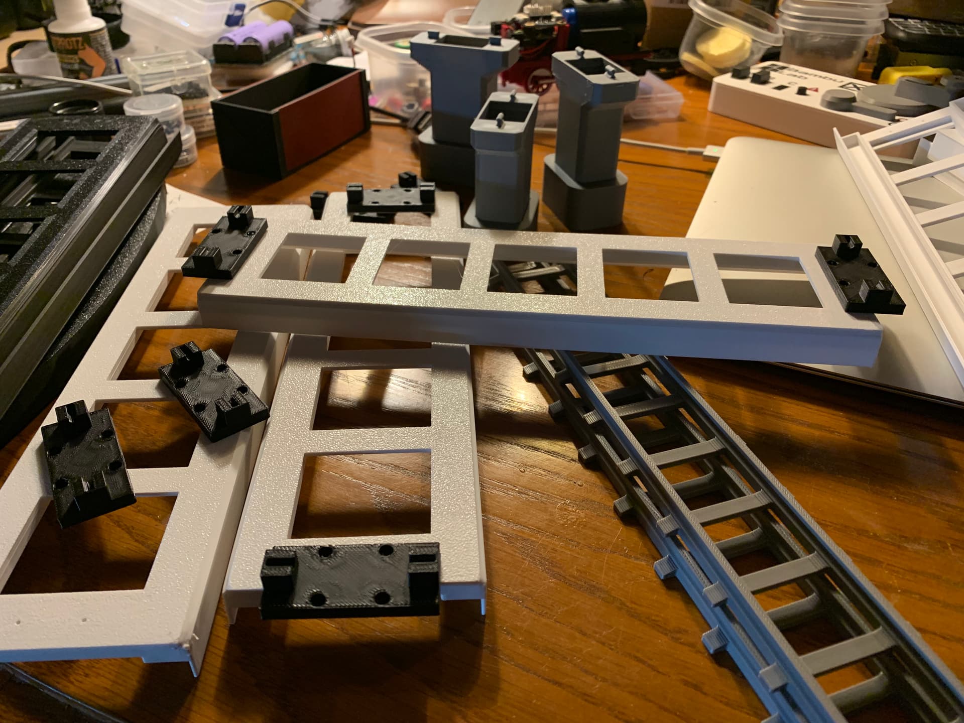

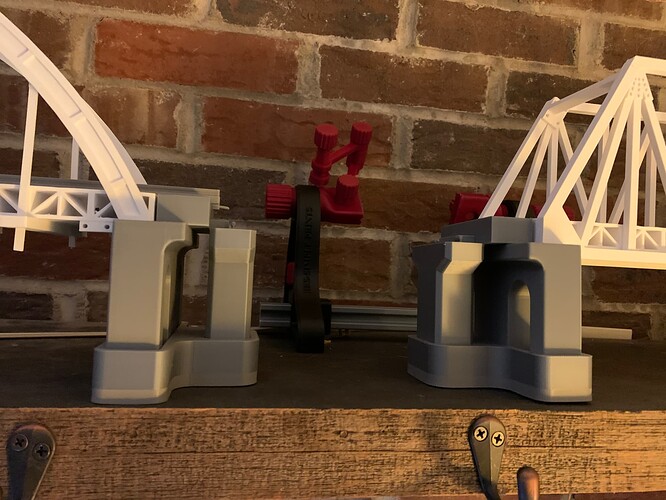

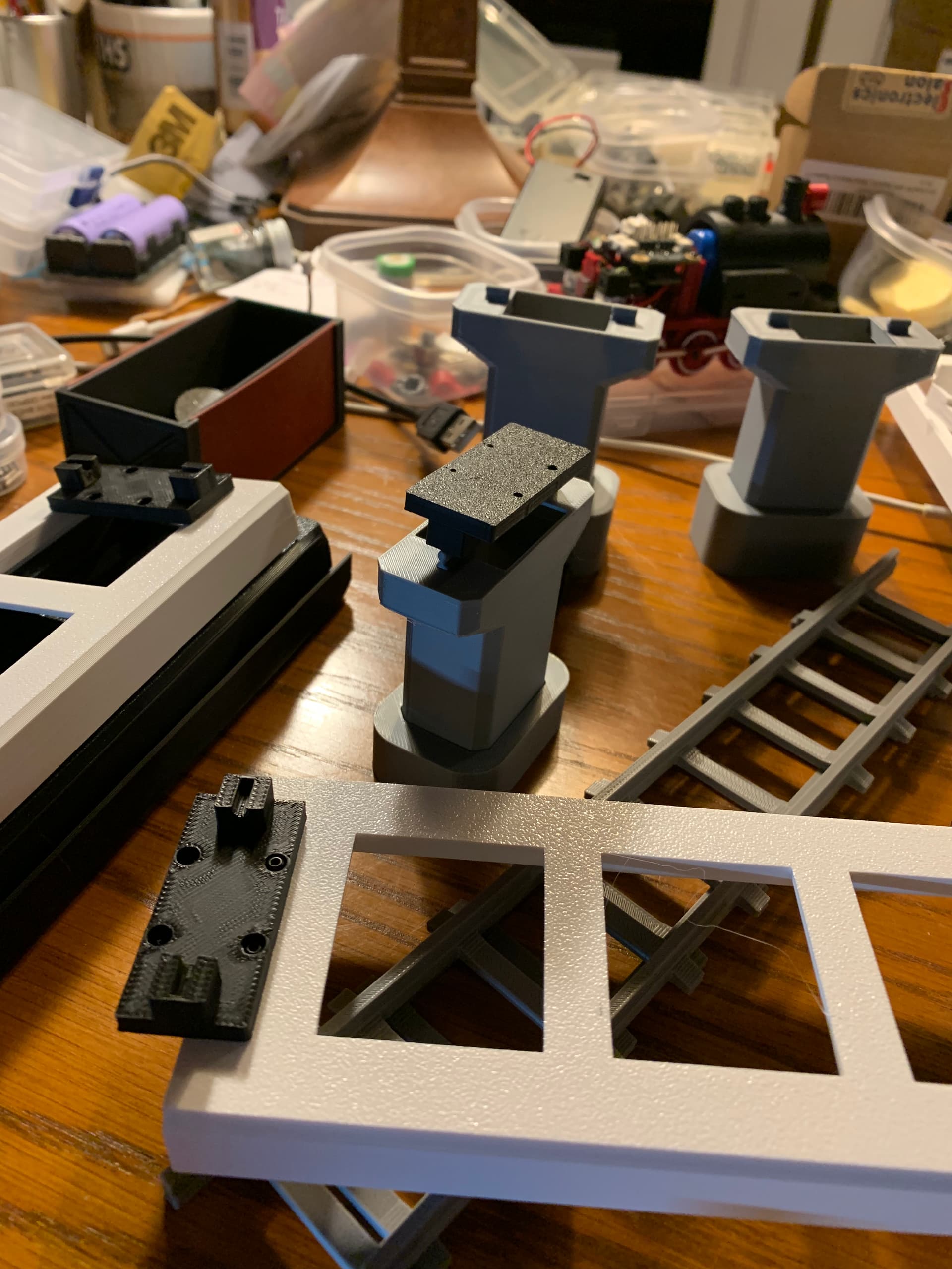

I am a bit confused on how the railway viaduct and heightening all fit together for an elevated track.
Hi

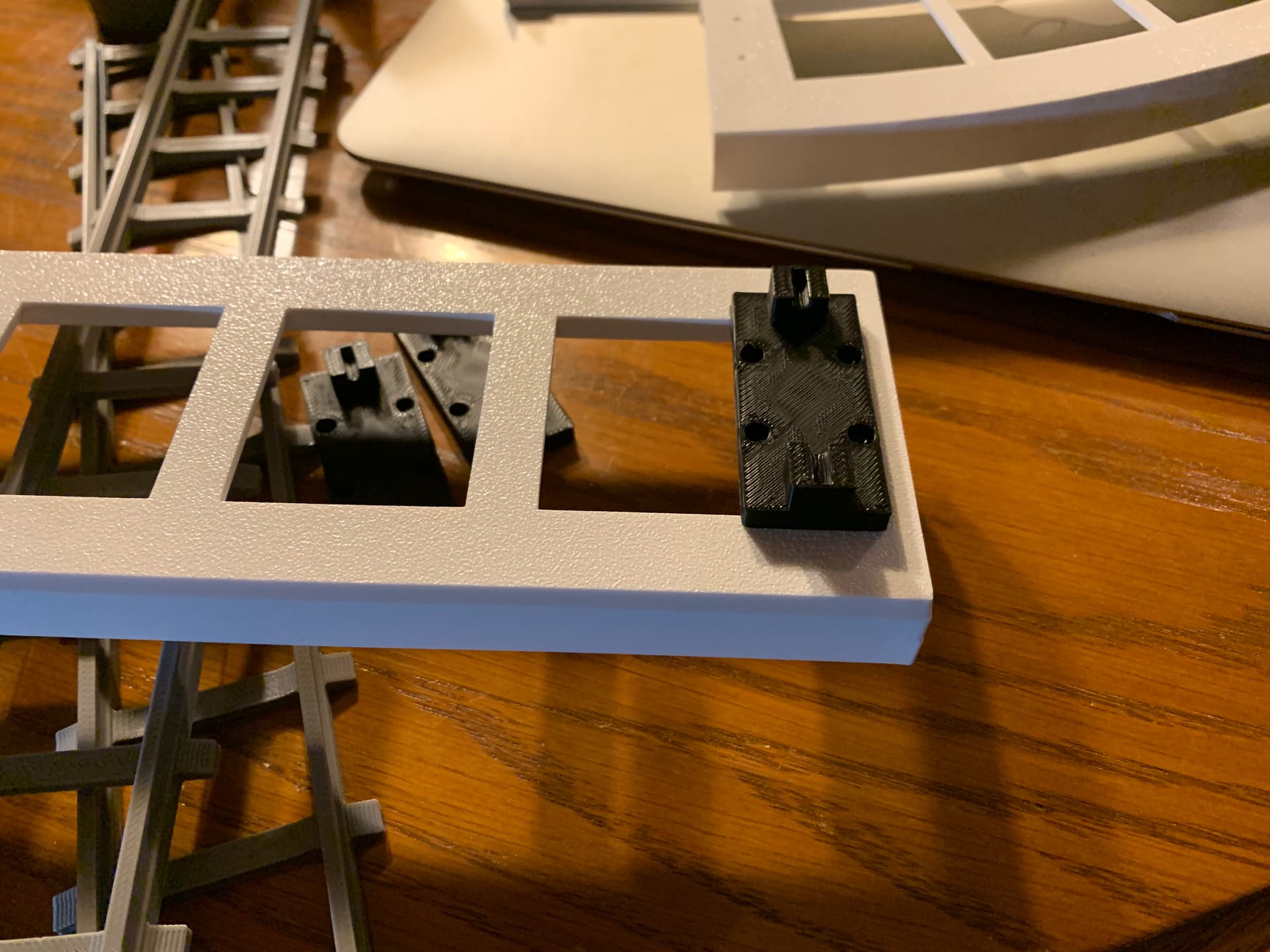

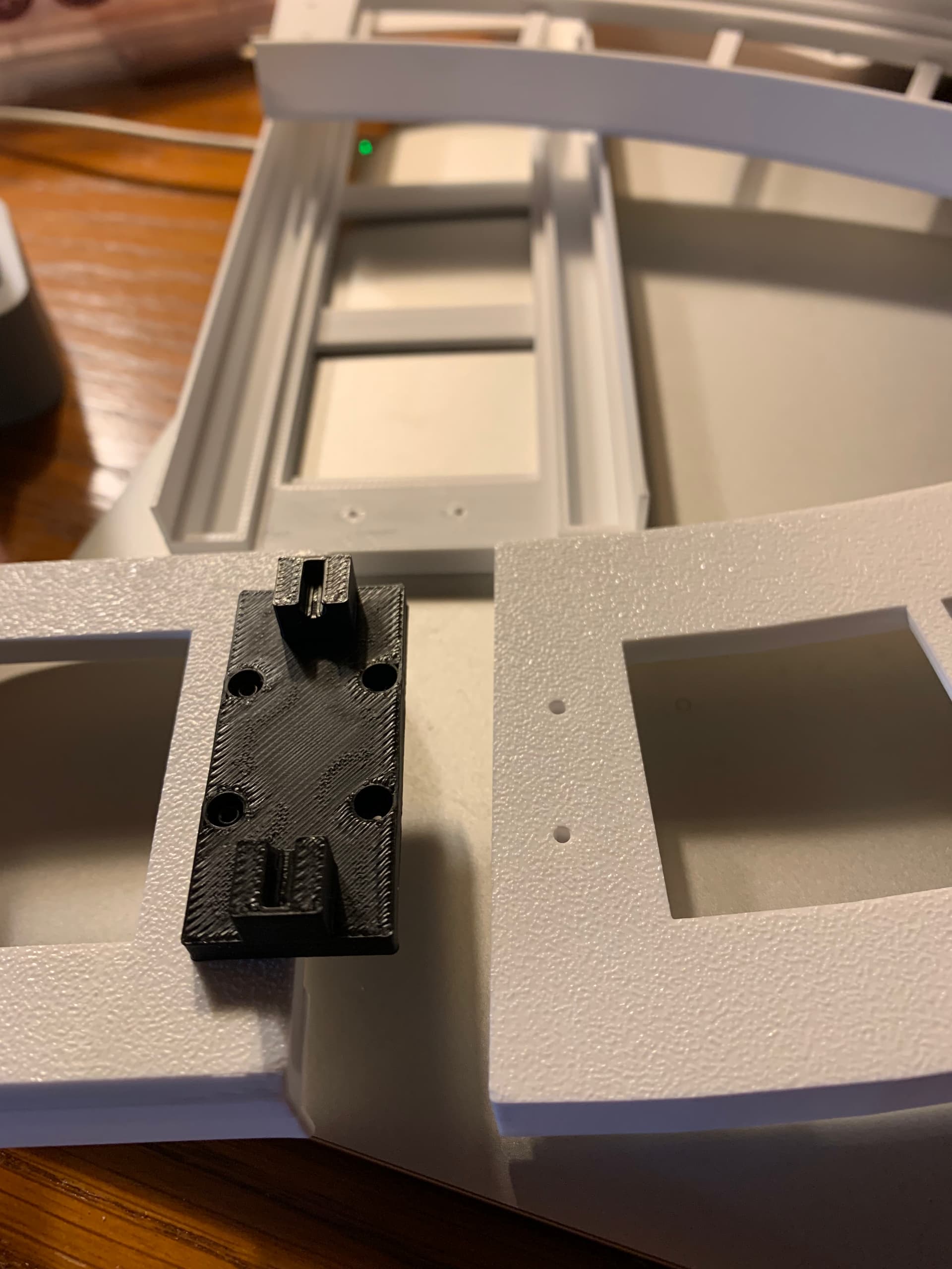

The viaduct pylons can be printed in varing heights, the base plates are screwed to the bottom of the viaduct sections, but if your track is all raised on the viaduct, it becomes one huge item to try to handle. the black base plates snap into the little tabs on the gray pylons. BE CARE FULL, THE LITTLE TABS ON THE PYLONS ARE VERY FRAGELE AND BREAK OFF QUITE EASY. I have a solution for it, should it happen to you. If you are going to have a viaduct section come off one of the bridges, you need to fasten the bearing plate backwards so some of the viaduct “white” is exposed, (see the pictures). Notice the viaduct pylons at the end of the bridge, one is shorter then the other. The shorter one on the right is the tallest one from the file so I increased the height by 10mm (the one on the left) so the viaduct will line up with the bridge deck. After the black bearing plates are screwed (M2x6) to each other, flip them over and snap the bearing plate to the pylon tabs.

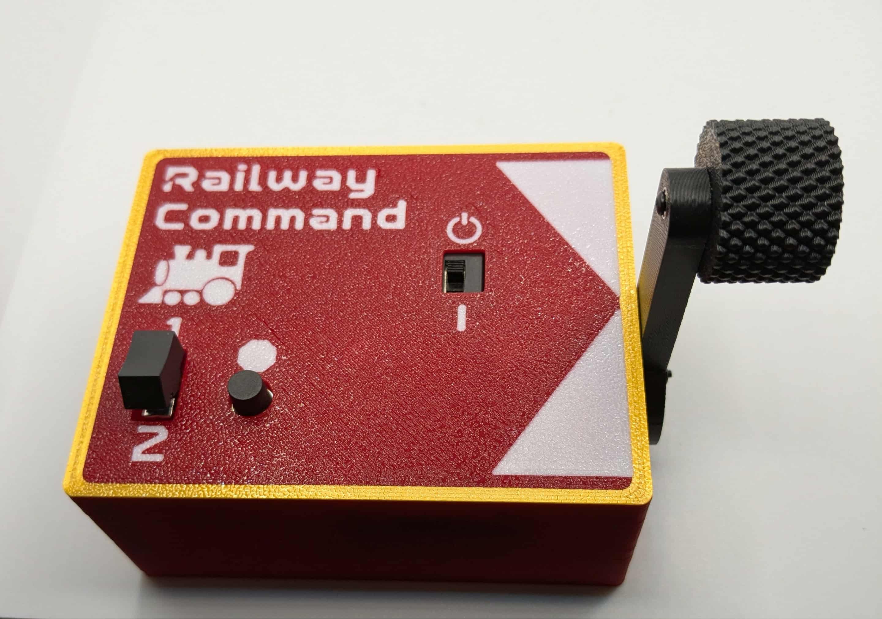

Locoman, I don’t know if you guys are interested or not, but I just published a new controller for the trains. It gives you a smooth vertical control throttle rather than the “click click click” rotary style. It also uses the CyberBrick AAA pack instead of having to use another rechargeable pack from the kit.
i like it, looks more like a throttle I am use to, I will take a look.
