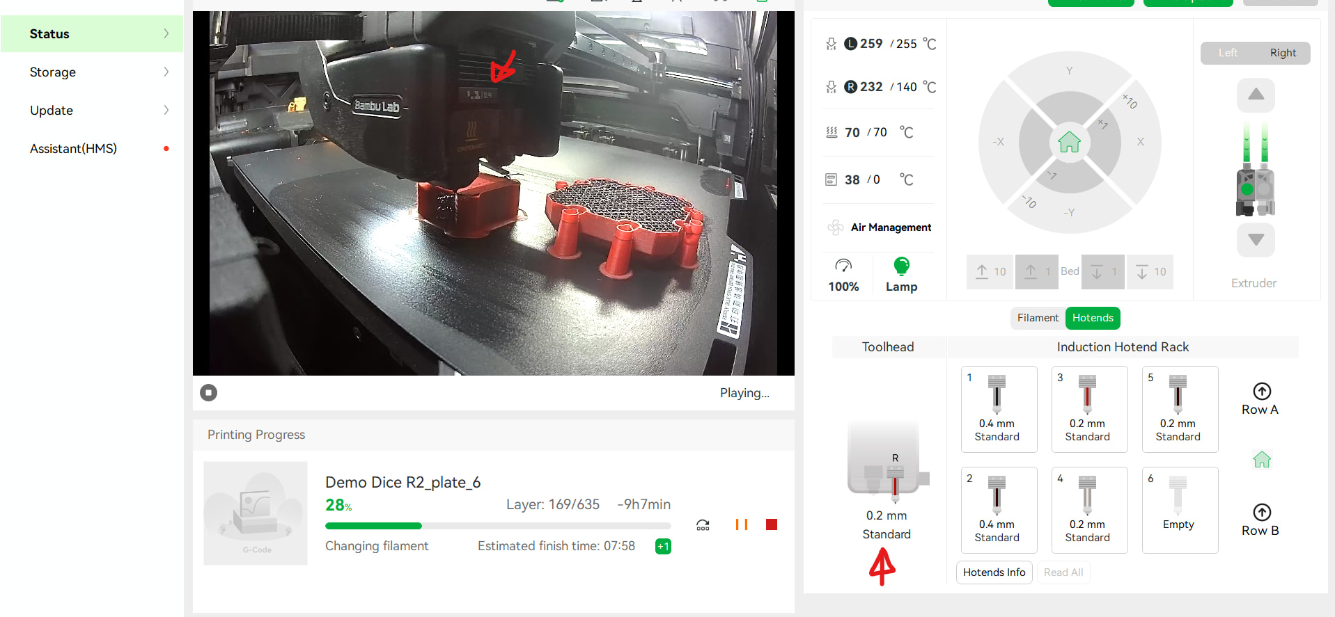

You CAN'T use two different size nozzles in the same print!
Replying to myself in Vortek already obsolete? here because I needed to remind myself that:
“One does not speak if one does not know”
I felt I had plenty of well founded opinion. But that is not the same as doing/knowing.
So: Ongoing print:
0.4 nozzle on the left printing black PETG-CF as infill with “Combine Sparse Infill”, 0.2mm Vortek printing red PETG HF.
Will post more if the print succeeds tomorrow. If not… probably better not to hold your breath :joy:
:crossed_fingers: :crossed_fingers: :crossed_fingers:
