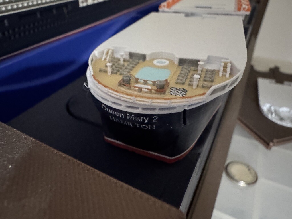

On this ship - so far the rear and front of the decks, including the tiny 1.5mm text is using 0.2mm and the middle decks and main hull is using 0.4mm

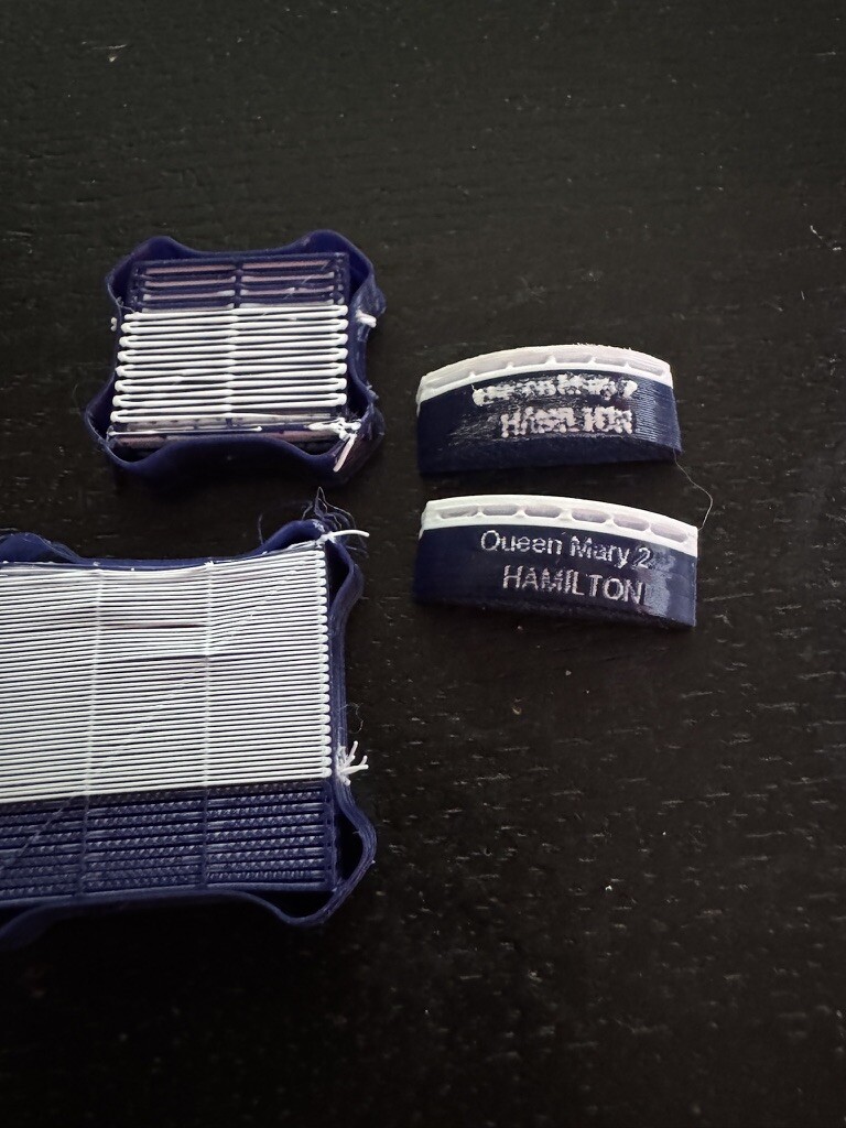

Example showing the advantage of 0.2 vs 0.4mm
With 0.2mm Text and rear of deck, with hull below the text 0.4mm

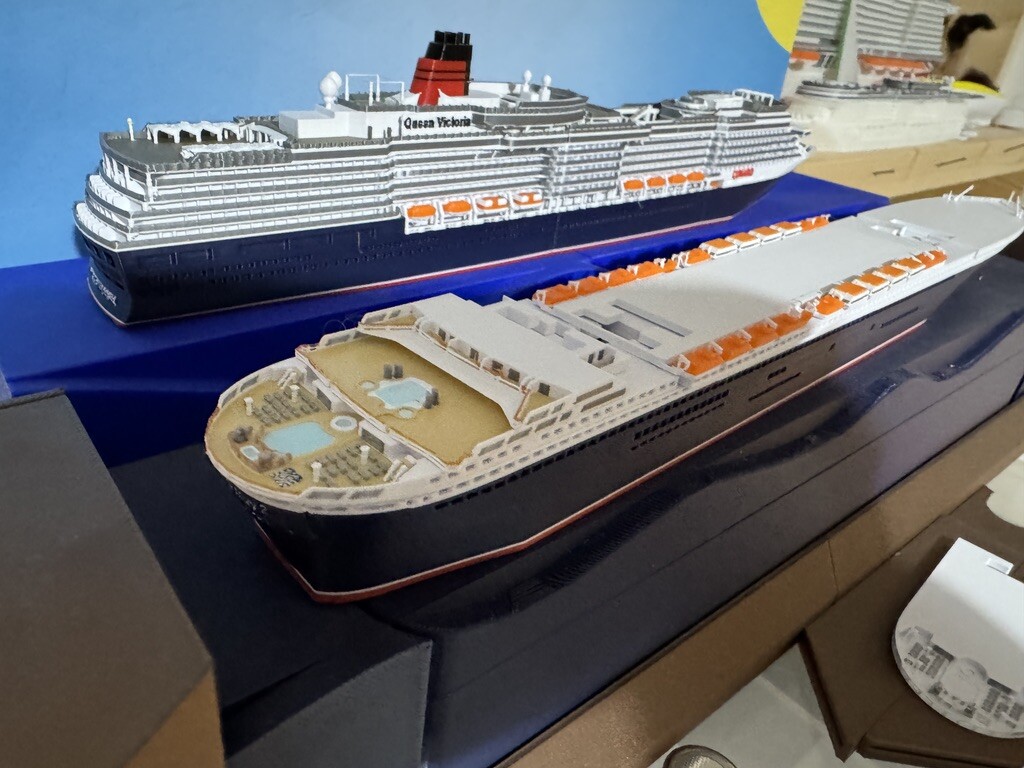

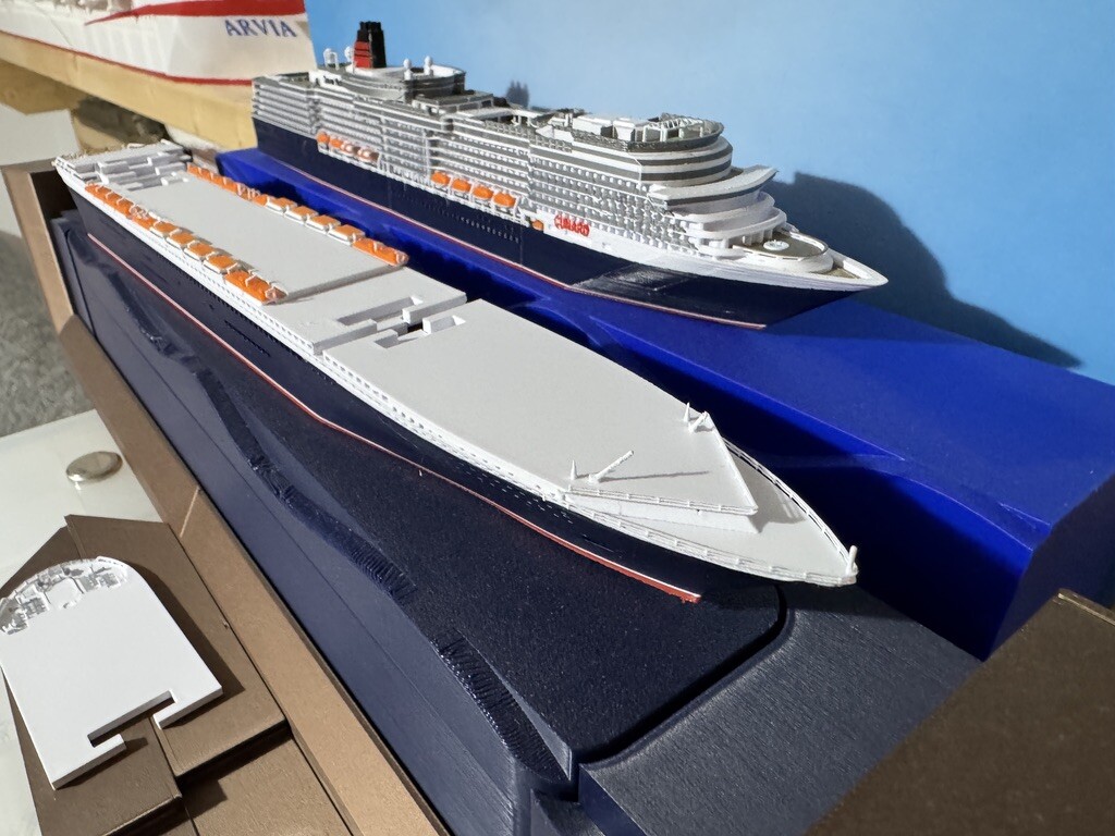

This print is impressive, how long does it take overall with the H2D?
Thanks - quite a few more decks to go. Will add up all of the times once it is fully sliced. Got the printer on Monday, so far about 8 hours print time.
The next deck is going to take about 5 hrs by itself as I am going to do the whole thing as 0.2mm - due to it having railings all around.
For scale purposes the ship is too long to fit on the bed - but fits on the H2D rotated 45 degrees.

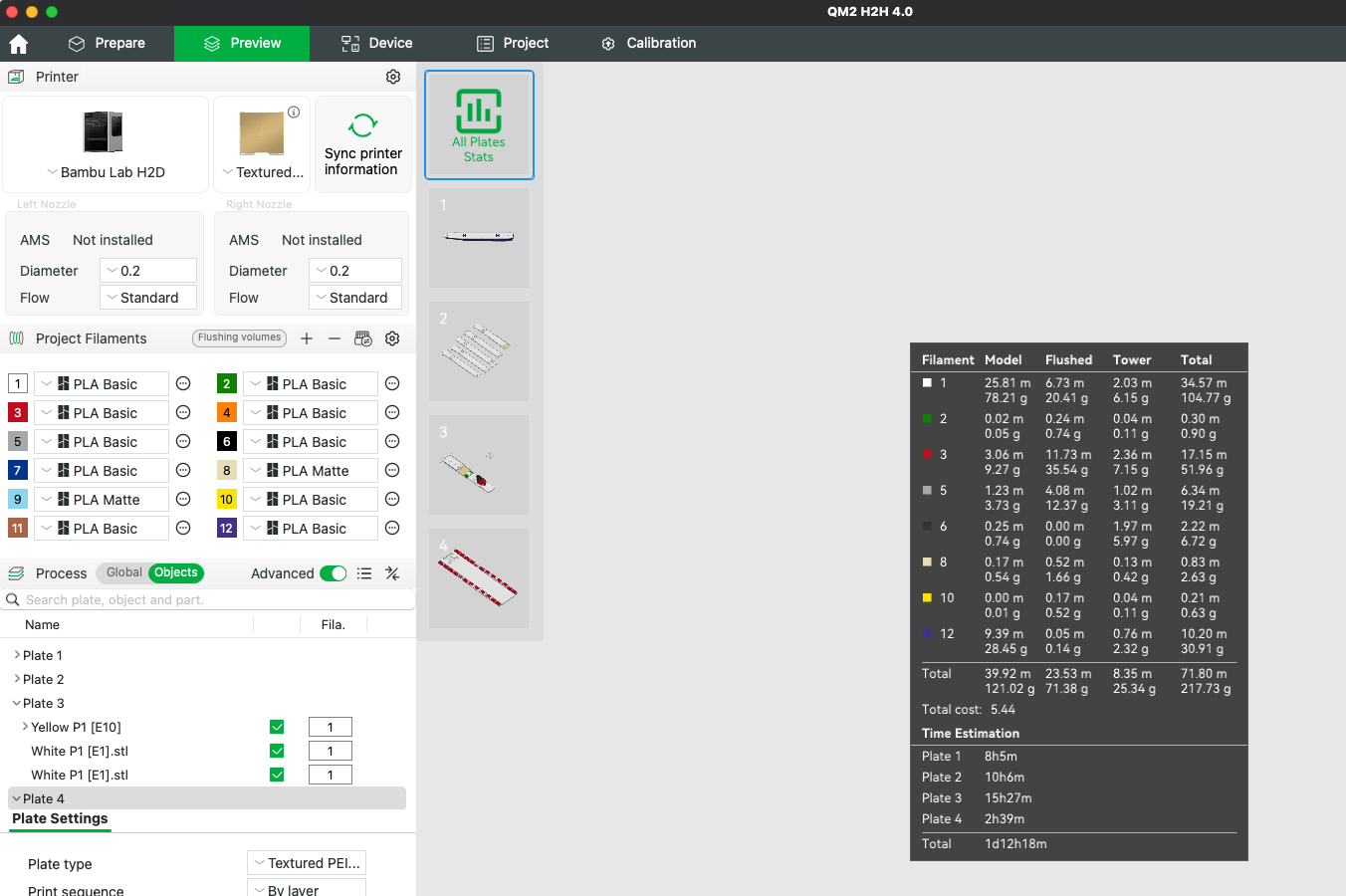

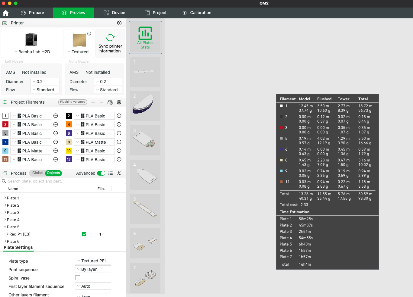

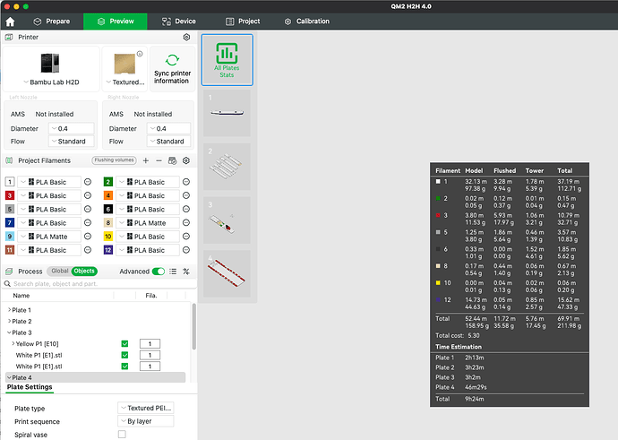

@Fr33lab Model now fully sliced. - 11 colours in total. Total print time 25h28m
0.2mm Nozzle sections - 16h4m

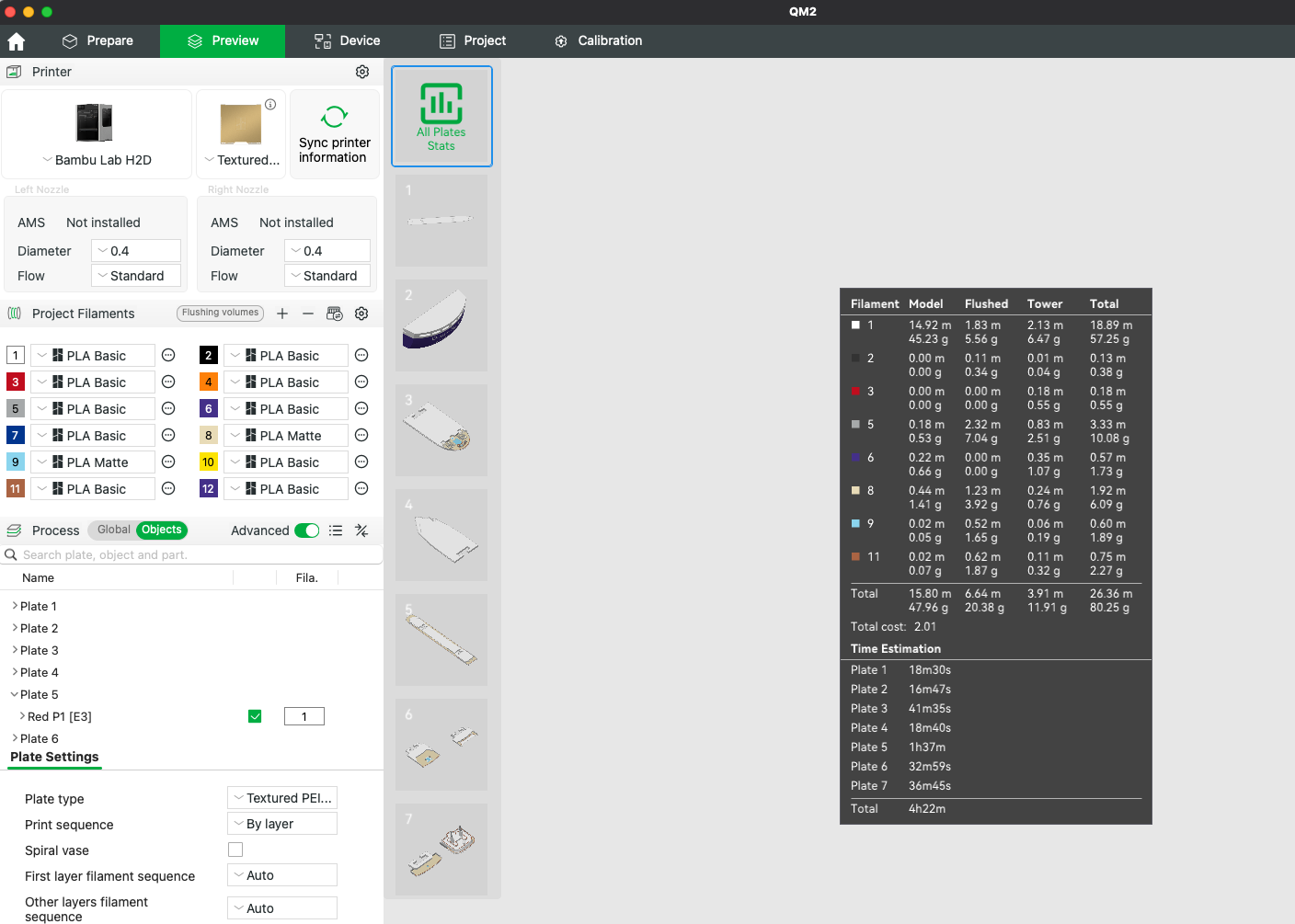

0.4mm sections - 9h24m
If 0.4mm sections were printed on 0.2mm - 36h18m. (300% more) - so printing these sections at 0.4mm will save over a day of printing.
For completeness (although not practical in this model due to loss of detail) - 0.2mm sections sliced at 0.4mm. - 4h22m - which is about 75% less
So overall saving from printing just essential sections at 0.2mm vs the whole lot = 9h24 + 16h4m = 25h28m. vs 36h18m + 16h4m = 52h22m = around a 50% saving in print time by splitting up model and printing some parts in 0.4mm on an H2D.

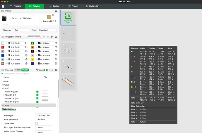

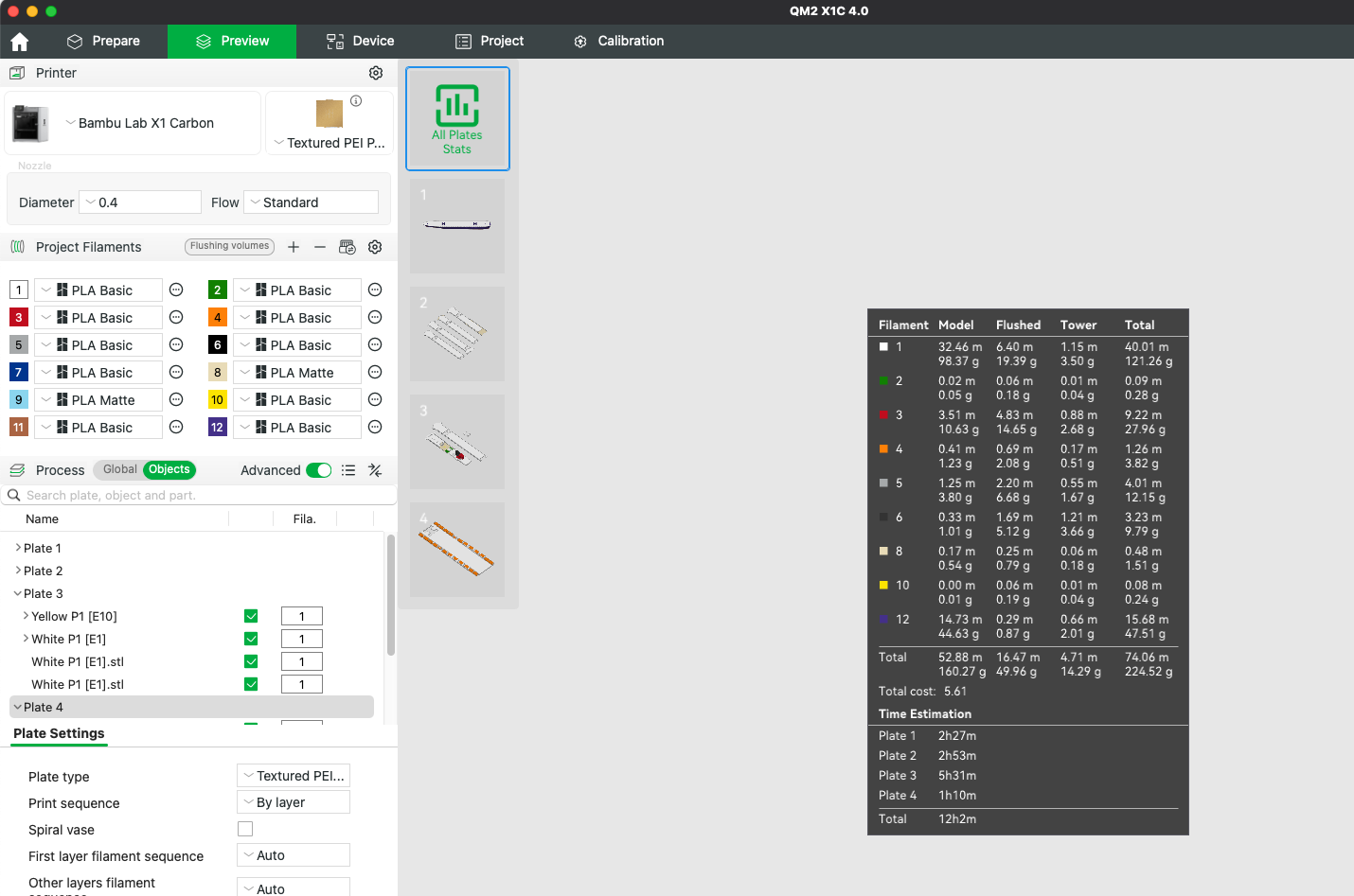

Another comparison - printing the 0.4mm sections on an X1C (which is probably what I will do for some of them). 12h2m vs 9h24m on H2D - due to faster and less wasteful 2 colour swaps between nozzles.

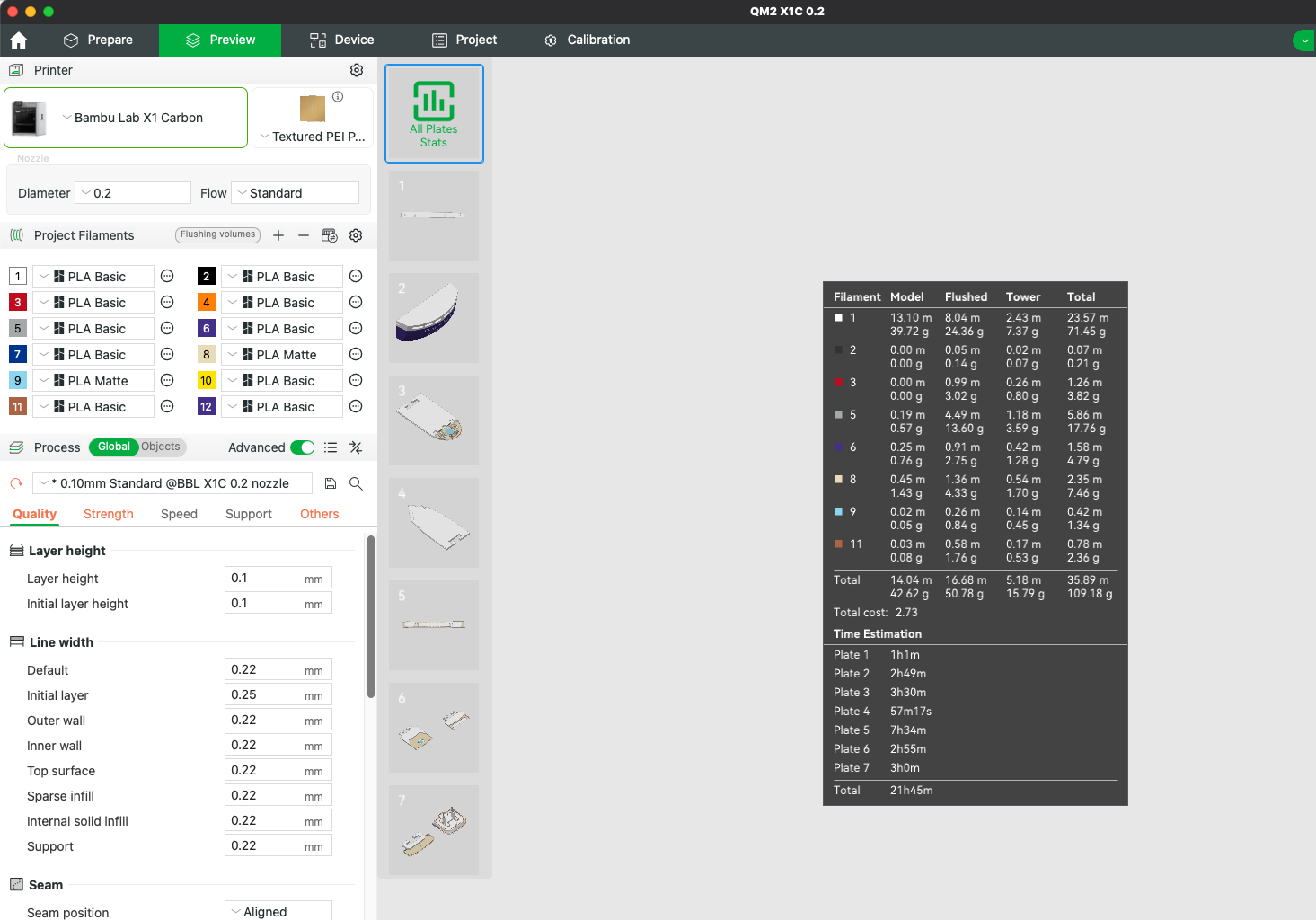

For the 0.2mm sections - X1C 21h45m - vs 16h4m on H2D - so for my models H2D brings about a 30% saving in time, plus flush waste on X1C 50g vs H2D 35g - so similar around 30% saving in waste.
