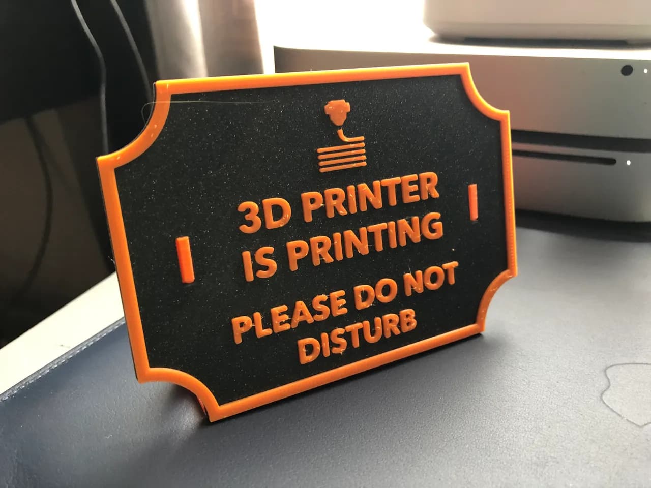

Can you start by letting us print the body of a print with a flat top with one nozzle size, and then extrusions on top of the printed flat surface with a smaller nozzle?
For example, see this image. It should be no issue to allow us to print the entire black sign body with a .8 nozzle and the extruded orange text in a .2 nozzle, right? I can’t imagine why that would be difficult to program.
For clarity:
The sign in the above image is large enough not to necessitate such a nozzle change. However, I print a lot of simple little fridge magnets which are simply a flat body that is tall enough to drop a magnet inside of mid print + extruded text or a design on top in a different color. I did a test just now and sliced a bed with 7 magnets on it.
.8 nozzle finishes in about 3 hours.
.2 nozzle with the highest possible layer height is 17 hours! lol
