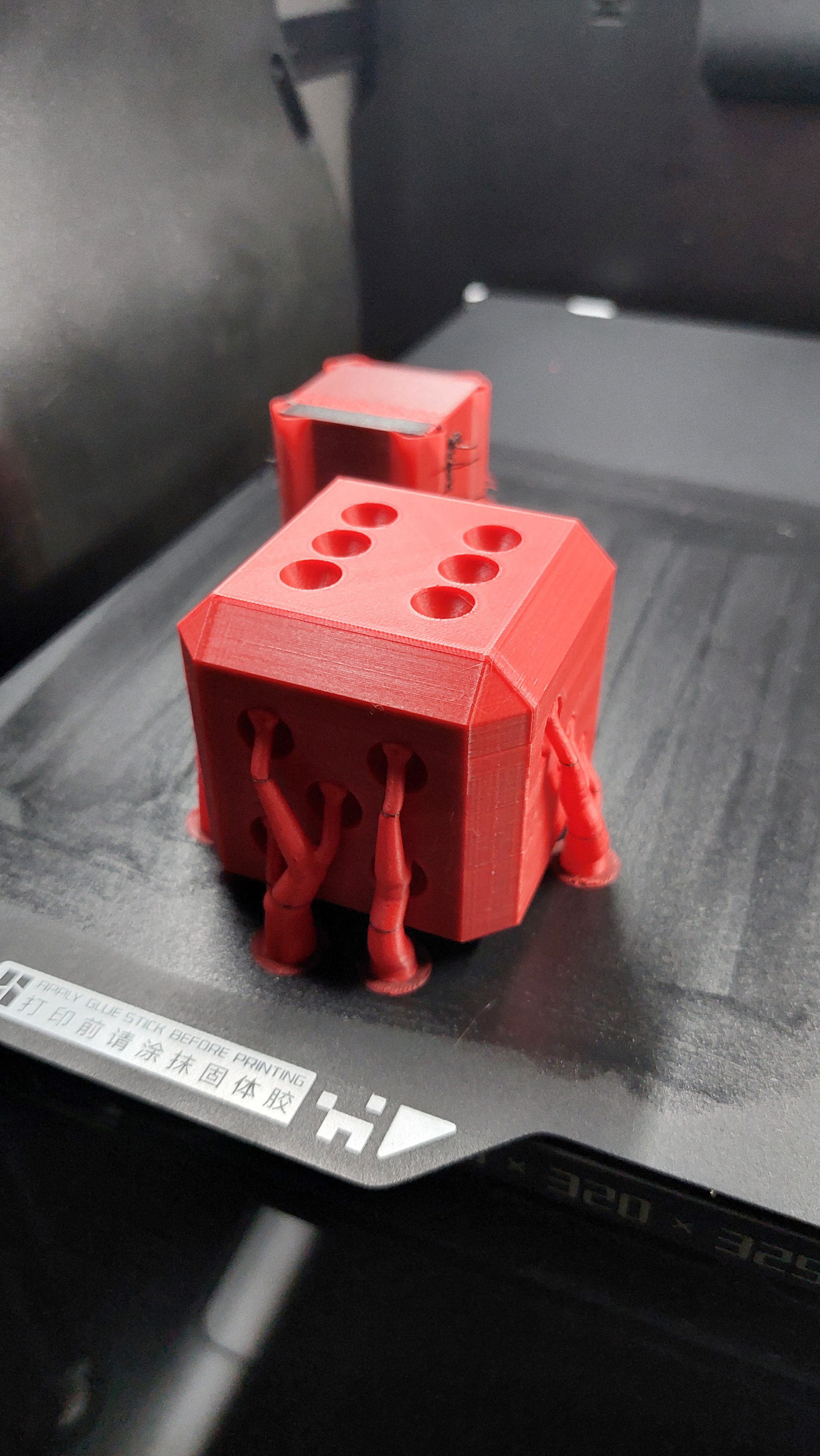

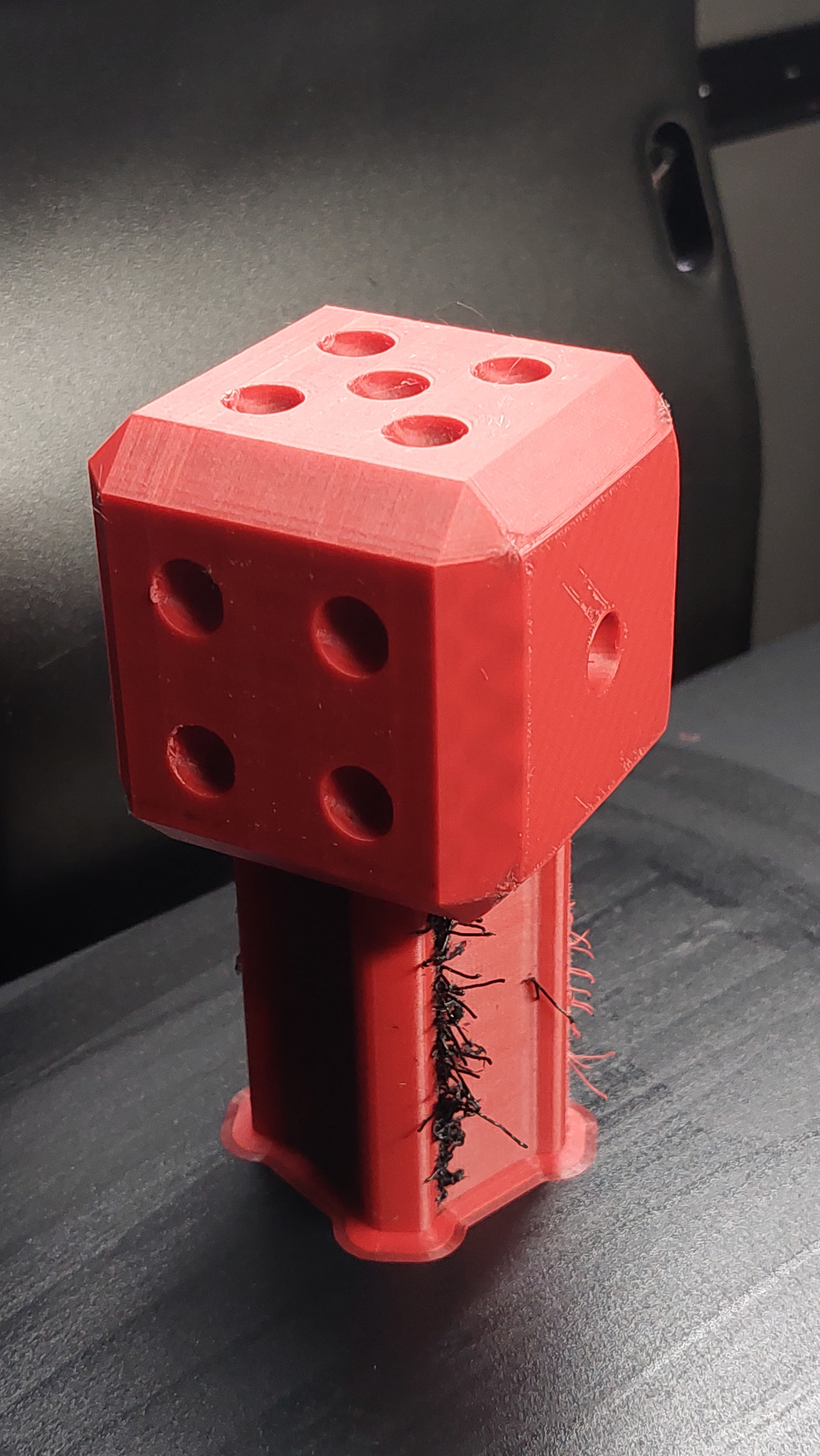

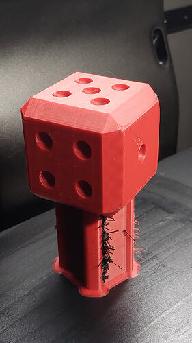

Hi @NeverDie ,
So,…
It worked :smiley::smiley: :smiley:
Except for my timelapse. The USB stick was too small :joy:
But sharp, crisp corners from the 0.2mm nozzle, thick and fast sparse infill with a 0.4mm nozzle insides.
Since I cut down on the wall count to reduce overal print time for this demo, you can see the infill through the edges in the second pic.
I went down quite a few dead ends, did both over- and underthinking but will briefly summarize.
How to (using Studio version mentioned above)
  • Have a roll for sparse infill loaded into the left 0.4 nozzle, a roll for everything else linked to the 0.2 Vortek. It helps to use different colors for early experimentation.
  • Calibrate the nozzle-filament combo to be used (if not already done)
  • Use an object without any painting as the line generator is completely overruled by the paint anchor generation
  • Ensure Studio is not synchronized with the printer (In a pinch, select a different printer on the device page. Or switch it off.)
  • Select a nozzle size (I used 0.2 here, but I’ll try a few things when slicing for 0.4 next: That may enable using a 0.6 or even 0.8 with a 0.2 nozzle as long as Bambu keeps its over-nannyfication in check.)
  • Set the volumetric flow rate of what will be the sparse infill nozzle to its safe maximum (0.2 nozzle defaults to 1mm³/s)
Global Slicer settings
Quality
  • Change only sparse infill line width to 0.42mm
Not sure if this is truly needed
  • Arachne wall generator
Strength
  • As always, grid sparse infill to anything else. I used rectangular.
  • Enable “Combine infill”
  • I used embed wall with infill
Object slicer settings
  • Select the object, go to Other settings and change only the Sparse infill material to the left nozzle material
=> Slice
  • Use Manual mapping: Infill filament to the large nozzle, all other filament to the other one
  • Check filament, line type, line width and layer height previews (this also shows what happens when trying this also for solid infill :face_holding_back_tears:)
Starting a print
  • Check that you have a 0.4mm nozzle on the left for sparse infill and a 0.2mm nozzle on the right for everything else
  • Use “Send” to transfer the file to the printer
  • Browse through the files on the “Device” page of Studio, print from there
  • Do not use auto-calibration at print start
  • Choose “Ignore and Proceed” when the printer complains about nozzle sizes
I’ll experiment a bit more, post and report but it’ll be a while as I am not at the Laptop atm and the kids are shouting from the pool…

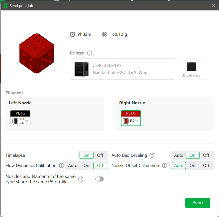

I also made these choices when starting the print:
Slicing for 0.4 and 0.6 nozzles works very well. But printing failed as I could not “Ignore and Proceed” in these cases. Installed were only 0.6 and 0.2 nozzles.
It is really frustrating that both the slicer and printer are much more capable than Bambu gives itself credit for.
Feels like I have a prime breeding bull :ox: sitting on my desk which was clasped in chains :chains: and castrated :scissors: :soccer_ball: by over-nannyfication.
So, for now: Need to slice for 0.2mm nozzles only. Work with nozzle-filament pairs, assign large nozzle/line width filament to sparse infill only in object settings, send to printer, print from printer memory using “Ignore and Proceed”.

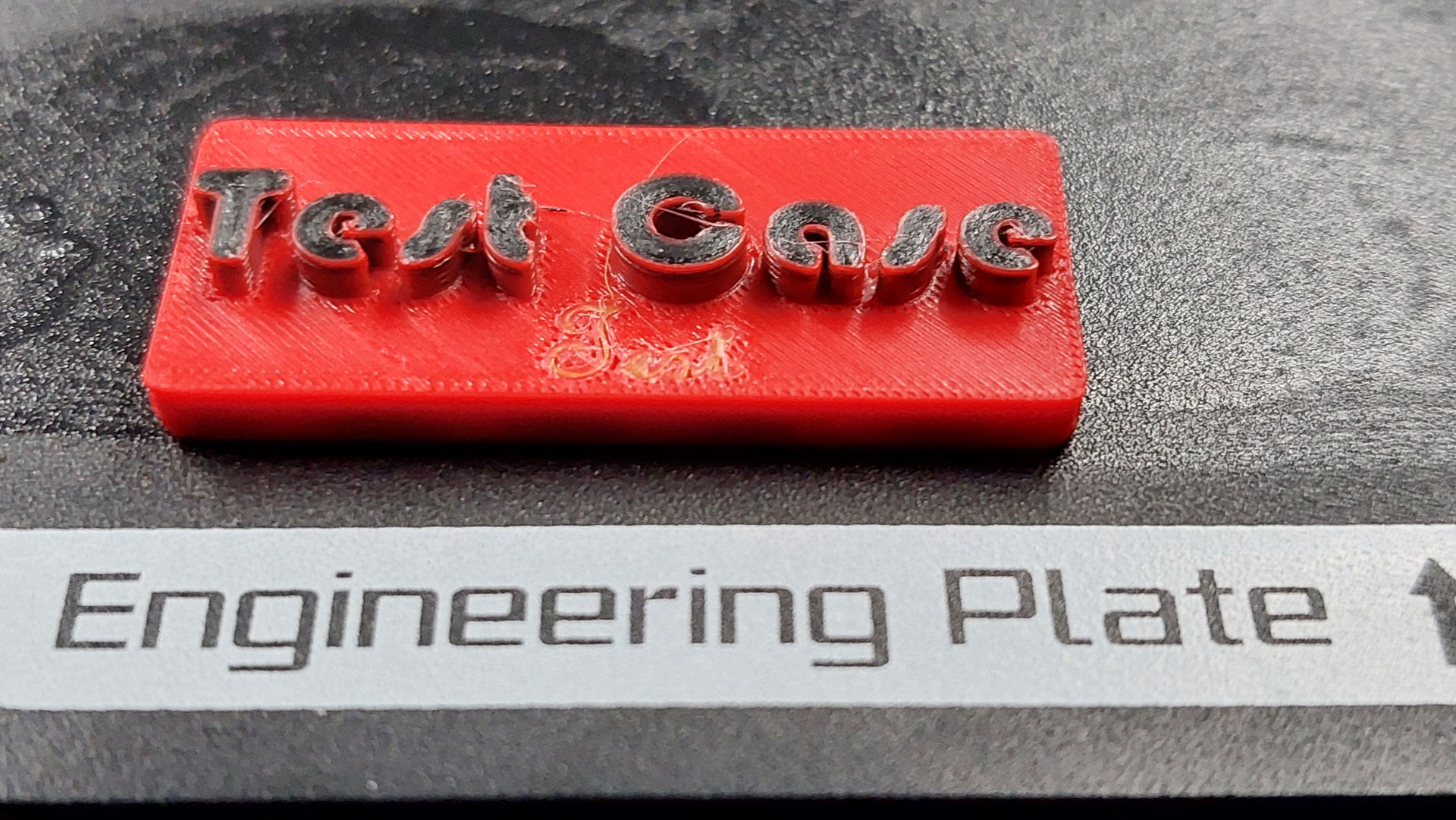

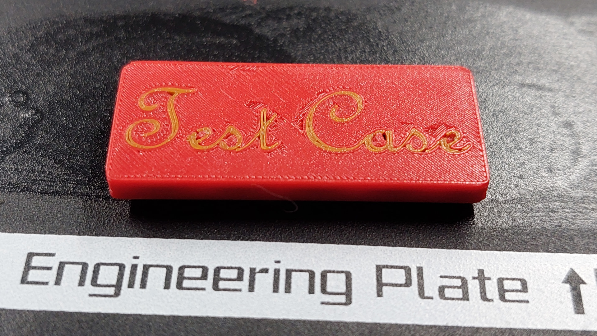

I have also run a tiny test for the tiny, sharp text use case. Not quite there yet though. The slicer treats top surfaces like sparse infill. And the first layer line width of course overrides other line widths. The pic’s don’t do it justice though as it is really small :joy:
Still experimenting :wink:
