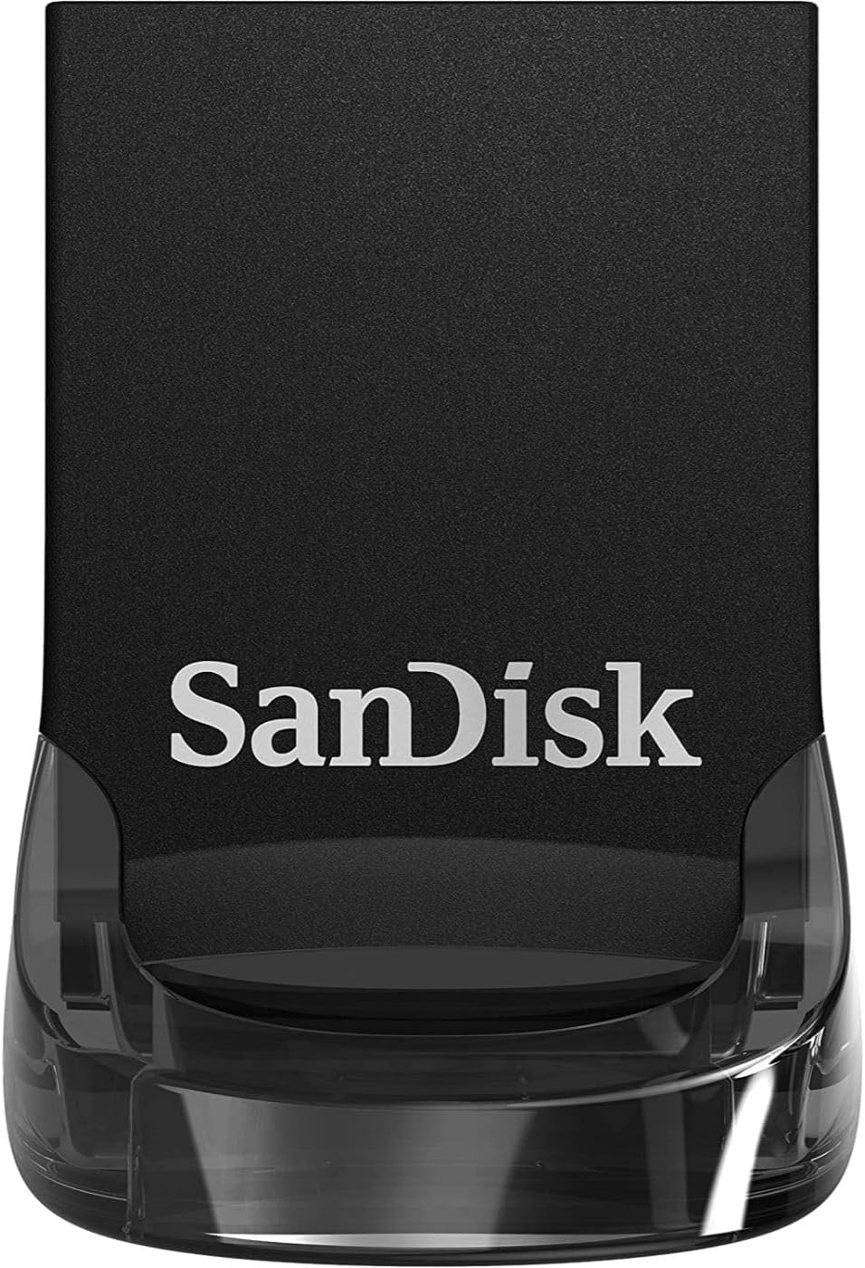

I used a PNY Elite Turbo Attache 4 USB 3.2 Flash Drive to diagnose and troubleshoot the problem, but only because it was laying around. For a more permanent solution, I would look for something known to run cool, and preferably with a metal case (to facilitate heat dissipation) and a lot of surface area (again, to help with radiating heat) that I can connect with a short USB cable. For those reasons, maybe something like:
You might be tempted to go for something compact and stubby so that you don’t accidently snap it off by careless impact, but in my experience those tend to run very hot, even when not plugged into a 65C printer.

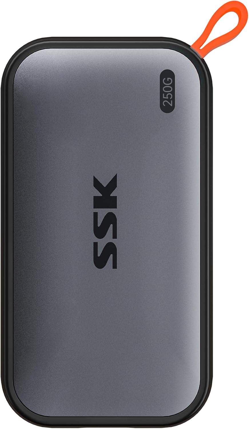

Alternatively, vibration might also be a factor, so possibly something rated for that. Maybe something like:

Also, I’d be very careful with connecting any high-capacity and high-power devices, like portable SSDs or USB3.2 Gen2x2 devices - majority of USB devices are not really capable of providing enough power, and to be honest, printer manufacturer is probably the last manufacturer in line who would be capable of a proper BC1.2 or PD spec implementation.
The USB drive needs a minimum spec for constant writing speed as its saving the video/time-lapse on it, 10MB/s is the write speed required by bambu. You need to be careful as a lot of USB flash drives will drop in speed significantly as they warm up. Good idea to stick to brand name fast drives like Samsung or Sandisk. I picked up the Samsung FIT as its a small drive with fast speeds from a company that manufactures its own NAND chips.
