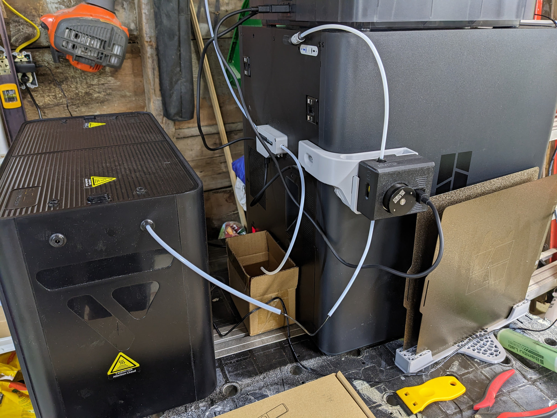

Well, I got the feeder, made a custom bracket for it to fit my SMSE.
And I have to say, the results are great.
It took some testing to figure out how to use it, especially with the power increase / decrease function.
But once I figured that out I was able to print flawlessly with 85A TPU.

I finally installed the TPU Assist Module on my P1S. It works great while drawing the filament out of my Sunlu S4 dryer. I’ve used it with Siraya Tech 85A.
