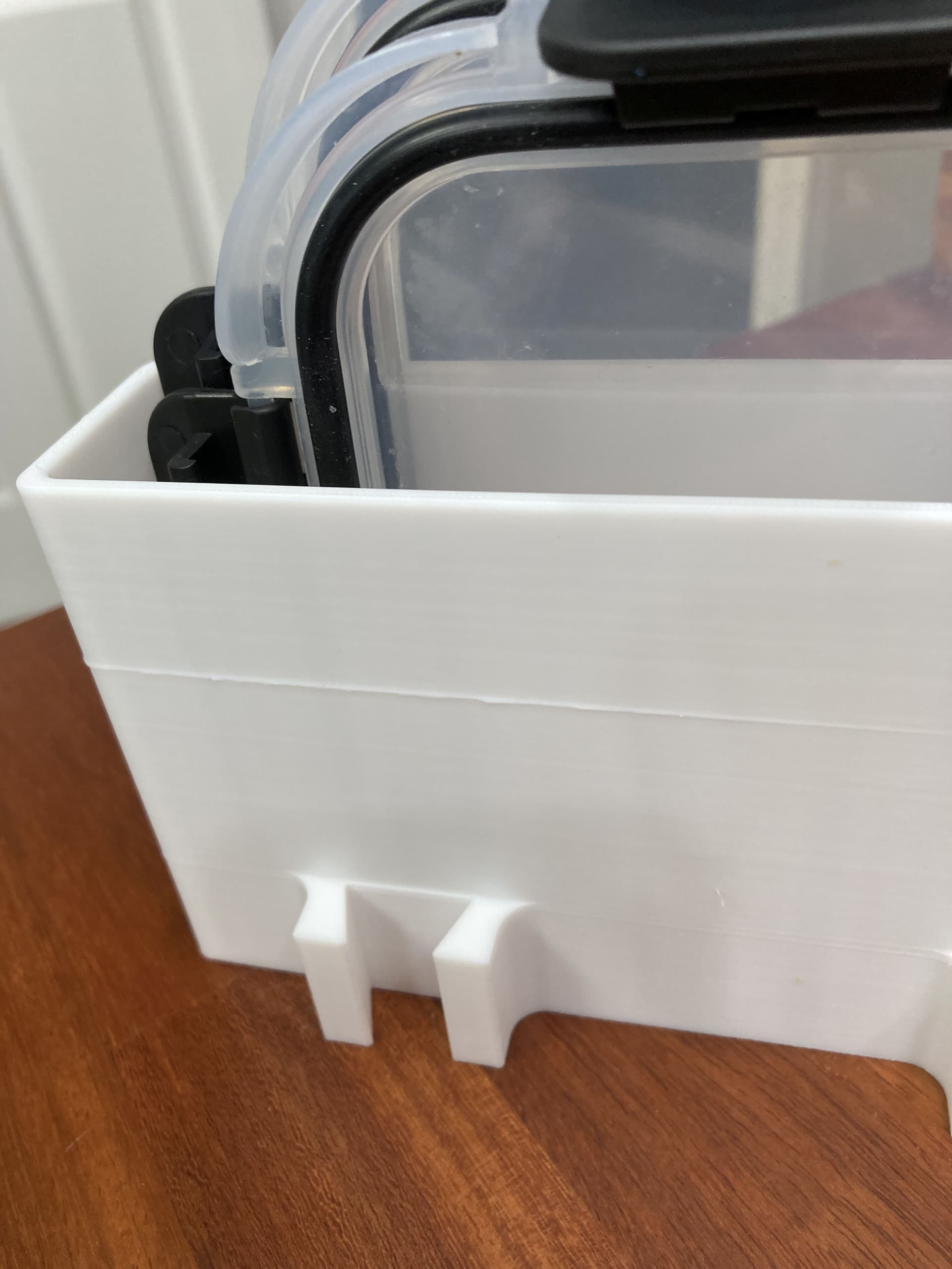

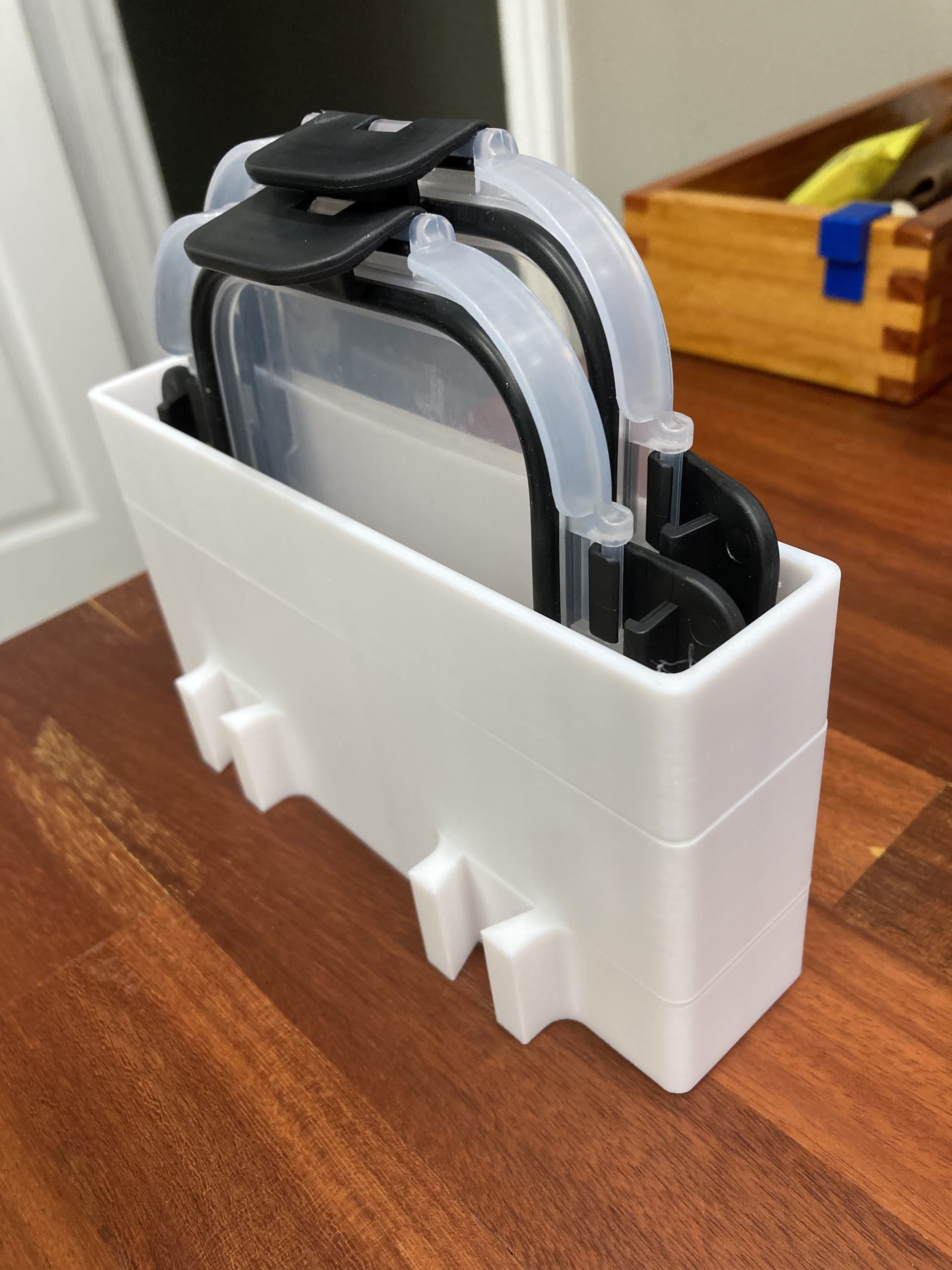

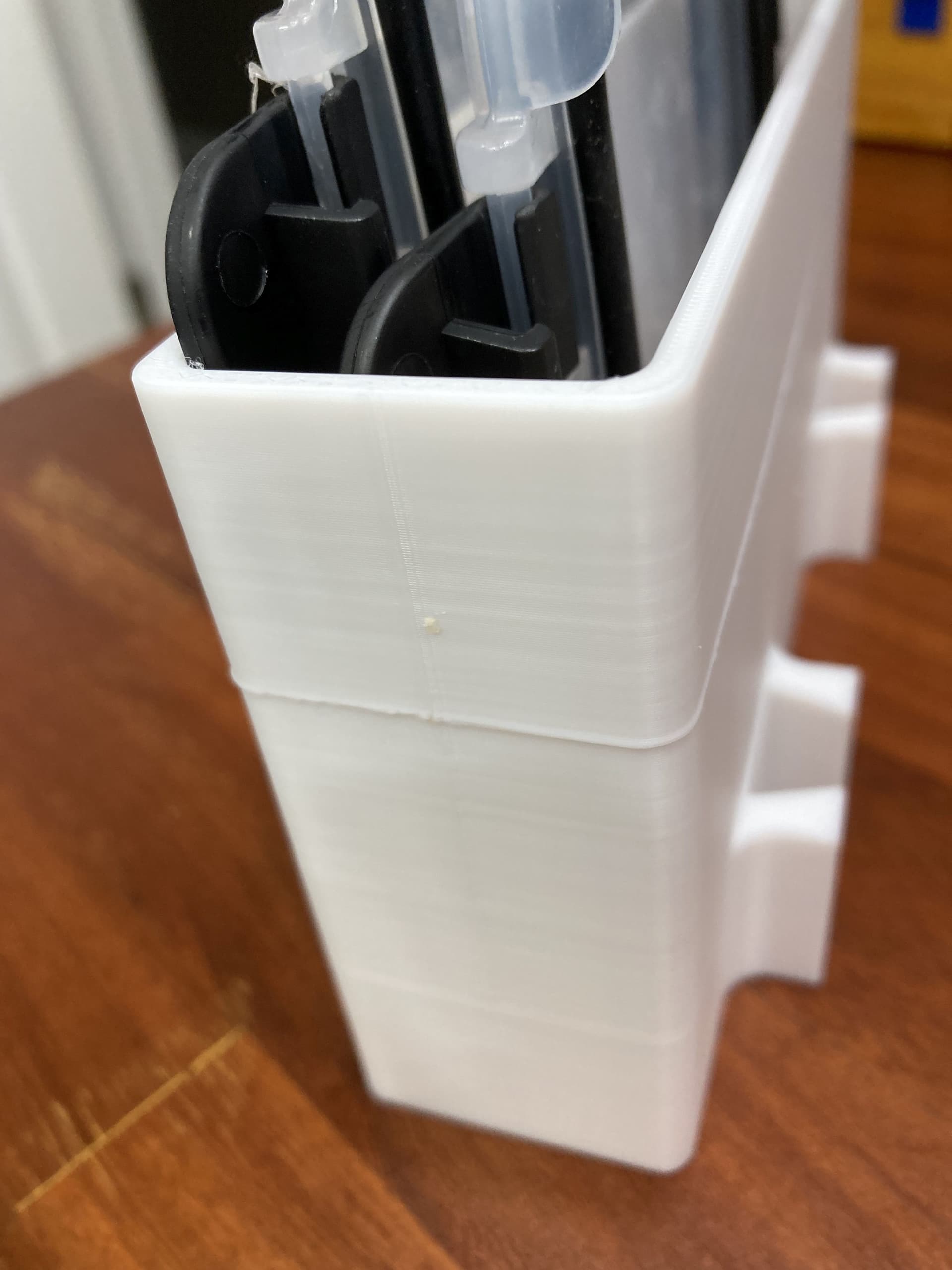

Yuk! What do you think happened here?
I printed this on my A1 Mini. I think I might know what happened, but I would love to know what you think. I’m talking about the line going around the piece. I appreciate your thoughts.

  1. Was the print paused (intended or not) at that layer? For example, if the filament is stuck(AMS?), the spool needs to be replaced, etc.
  2. External factors to the printer. Either affecting mechanical (e.g. movement, vibrations) or thermal (e.g. gust, draft).
  3. Design and slicing.
Okay, I think you nailed it with the stuck filament. The roll had stuck several times but I was able to de-snag it quick enough to continue. But then I went to bed. So the bad roll of filament is probably to blame. I was thinking the model shifted a bit on the bed, but the snag sounds more likely. Thanks
