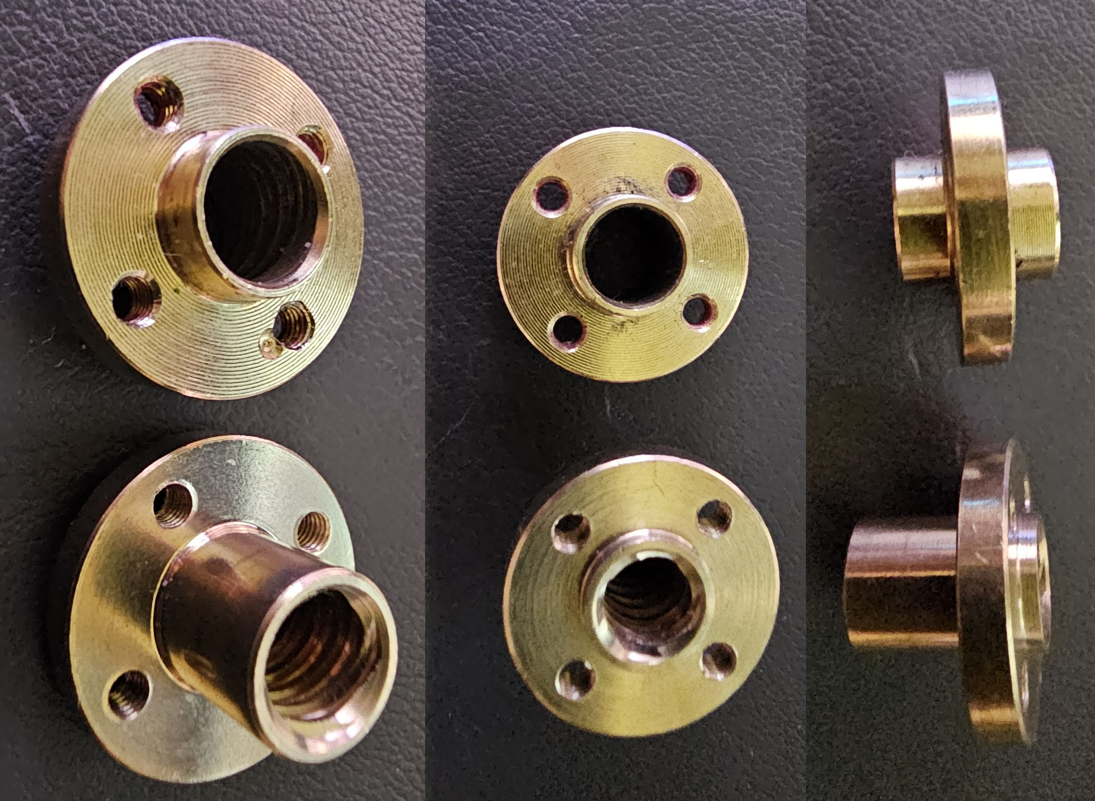

The brass nut on the rear lead screw that connects to the heat bed failed on my X1C printer with 3,890 hours on it (threads on the inside of the nut are worn, it’s almost totally smooth and the nut slides freely up and down the lead screw) . Also, one of the front brass nuts was found to be very worn, the other front brass nut was okay. (Bambu lab support referred to the part as a bearing) I have kept the lead screws on my X1C well lubricated at all times.
The part is not available from the Bambu Lab web site, I have contacted support to see if I. can purchase replacements, but it looks like that is going to take weeks. Support stated “Please allow me some time to review this further and see if we can source the part directly. “.
I was able to find a part on Amazon that is close, it’s the same diameter, thread specs and takes the same 4 screws to attach to the heat bed slider bracket but is different in height from the original. Original is 11.43mm tall and the replacement is 15mm tall “uxcell 4 Pcs Tr8x8 Lead Screw Brass Nut, Trapezoidal Nut Linear Screw Acme Thread Screw Replacing Brass Nut (2mm Pitch, 4 Start, 8mm Lead) for 3D Printer Accessories” Also the original is symmetrical where the center part extends 3.6mm above and bellow the disk with the screw holes and the nuts purchased from amazon extend 1.5mm above and 9.6mm below the disk. I was able to install the parts from Amazon in my X1C and get the printer working. I think I lost about 6mm of printable Z height due the difference in the nut height, but I am able to print with the X1C.
I suspect that other Bambu lab printers are likely going to be encountering issues with these brass nuts as they wear out. Hopefully Bambu Lab will add them for purchase from their web site, if not then maybe a company like BIQU will start selling them. Until then if you have tis issue and want to get your printer working these nuts might be available from Amazon.

could this be actually the one ? its the most i could find out there, it has 4mm from flange to end of nut on both sides, 2026 asked support for replacement they dont even know what nut im talking about when i ask for a replacement brass nut for my z-axis…
Tell Bambu Support you need ( Z-Axis Leadscrew Kit model: FAC067 ) I purchased in July 2025 for My X1-C cost was $35 + $7 Shipping Plus NY Sales Tax.

Just wanted to let you know that I tested the dimensions in the link to an official replacement I have and they look exactly the same. Thanks for finding this. When I had the problem a year ago, I absolutely could not find a 3rd party solution and had to get bambu’s.

actually, somehow my machine with 6400 hours was still in warranty and i just jumped them by demanding to buy them but they asked me for my UID and they just went yeah still warranty, 4 days you have new set and they shipped me but yeah for reference “Z-Axis Leadscrew Kit model: FAC067”
is exactly the needed part
