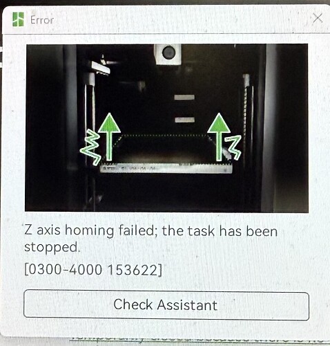

Z-Axis Homing Failed
I’ve been all day, no issues. All of a sudden after my last print I get the Z-Axis Homing Failed error. I’ve done all the troubleshooting:
Checked the lead screws for debris
Removed the build plate and reinstalled
Checked the Z-bearings
Cleaned and grease the lead screws
Checked all the belts
Made sure there was filament buildup on the nozzle
Powered of and back on
Reran calibration
Not sure what else I can check or what to do at this point.
Thoughts? Suggestions?

Whatever… Have you already done what is written in the wiki? :+1:
Yeah I did try those steps as well same problem.
Does the plate make its way all the way up to the nozzle and touch the nozzle?
It does and sets in the position for quite a while before finally failing. I’ve even gone so far as to try different beds because I’ve checked everything else. That I can think of and what the Wiki says to check.
I’m currently experiencing the same problem. I have replaced the Eddy Sensor and it did not fix the issue. The bed crashes into the nozzle and keeps driving before failing and giving an error.
I finally got mine fixed today, so dumb, makes no sense. I checked all the sensors, unplugged, plugged back in, still didn’t work. So today I shut the printer off, turned the threaded lead screws by hand a few times, turned back on and leveled with no problem. Can’t really explain it but that worked.
