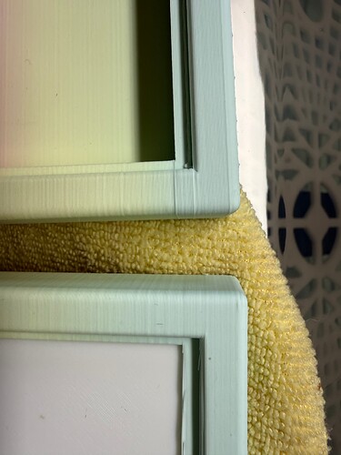

Z banding issue discovered
I believe THIS is an H2D issue with using both heads. I have a couple jobs where I use supports blending PETG with PLA and found that where there is PETG applied with one nozzle and the PLA with the other I get Z bands. At first I thought it was because of a transition between a floor and wall, but after doing a vertical job found its when ever there is PETG added to the mix. What I haven’t tried it swapping between PLA and PETG on the same head to see if it goes away, but I believe there is some issue between the two filaments and using dual nozzles, I see small strands on the purge tower of PETG.
If I use different colors PLA between the two heads, no Z band issues, clean transition between heads, its only when using PETG as the layer between support and product.

Have you tried enabling arachne? I remember in the z banding thread that being one of the settings that illuminated zbanding for people. PETG runs hotter so I don’t know if maybe they plays into it. Polymaker makes a filament to use in the support interface that runs at the same temp as pla.
I remember seeing arachne, but don’t remember where. The odd thing is, its 360* when it happens, and JUST that layer. All following layers are back to the origin layer. I’ve been using both heads for these to save time and filament, so going to move both to one AMS and see if it repeats. Using SunLu PETG with Bambu PLA, and the PETG-HF Bambu setting, which works quite well with the SunLu PETG.

I just printed a tall PETG object and I was quite happy with the smoothness of the walls. I slowed down the print a bit but I did not swap to other filaments.
What happens to that print if you print all if it in one filament type? Is it because of different filaments or is it because of filament swaps.
