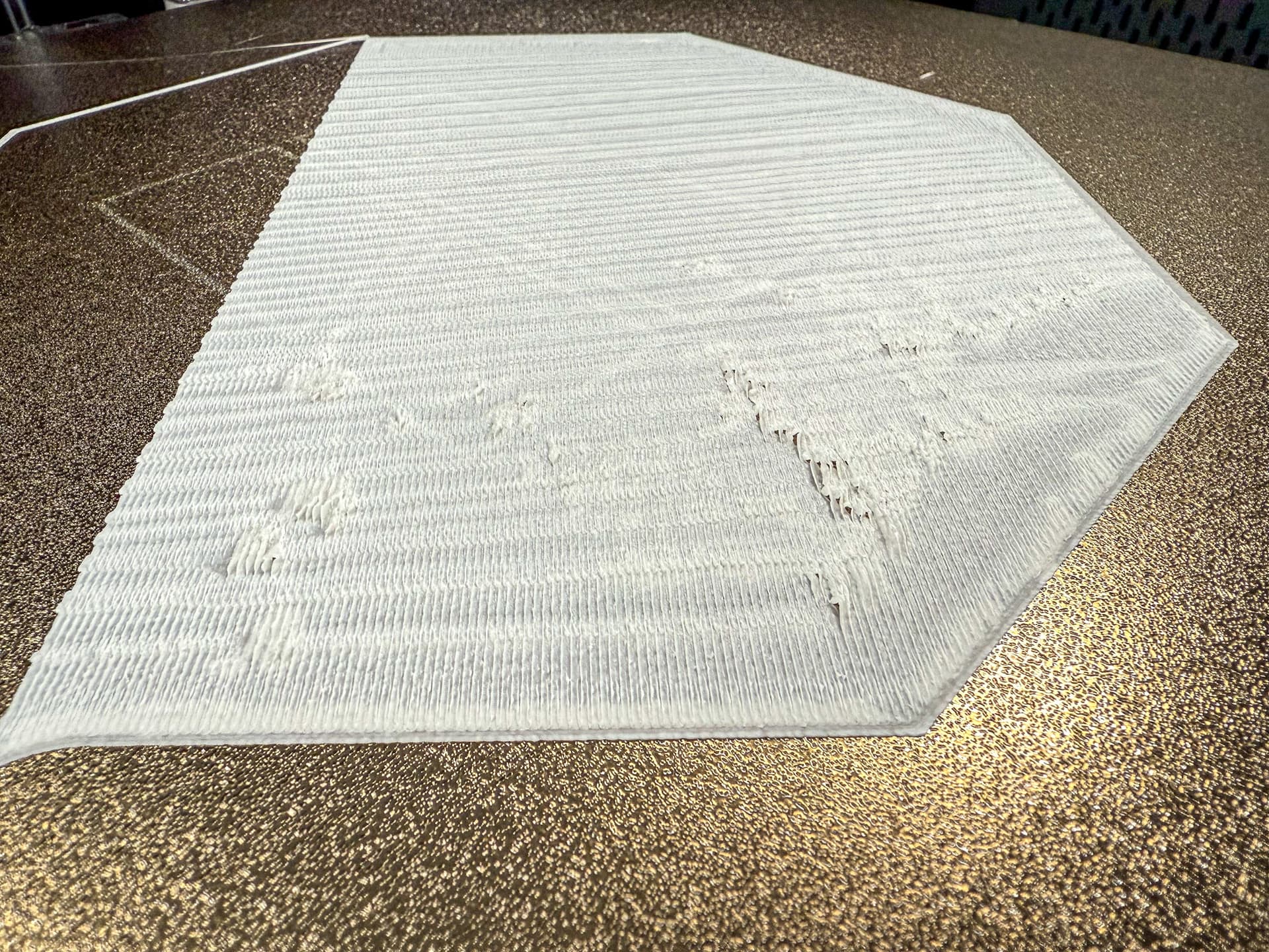

I have a problem with the HF hotends on the H2D. The Z-offset does not seem to be correct here, the nozzles are much too low.

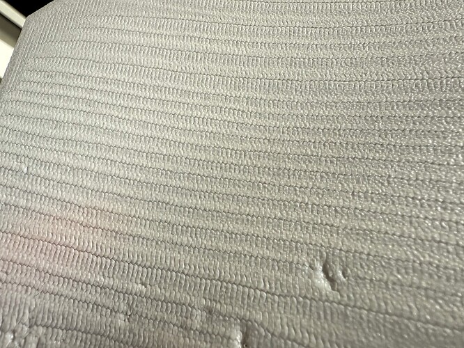

You can also hear the nozzle scraping lightly over the printing plate directly on the printer. And you can also see very clearly on the 1st layer how the nozzle ploughs through the filament.
Firmware and Bambu Studio are up to date. The nozzles are not clogged, the max. volumetric speed test ran without any problems. The HF hotends are also set on the printer and in the slicer (it recognises them automatically)
If I change back to the 0.4mm standard hotends, everything is perfect, with completely the same settings.
Put in the HF hotends and again it scratches over the printing plate and the print image is catastrophically bad. Even worse on the left than on the right.
If I insert the textured PEI and select Smooth PEI, it only improves slightly, but remains unacceptable.
Does anyone have any idea why this is and how to fix it?

I’v had a strange issue pop up from time to time where (probably 3 times now) it squishes the nozzle right onto the plate and looks similar to this. Resending the print fixes the issue every time. Twice it has happened using the PA calibration manually from the calibration menu and once when sending an ASA print.
Mind you, I have bed leveling set to “on” for every print. Yes, the printer is calibrated. I cant say if it was actually touching the bed during printing as there are no witness marks, but getting the filament off the bed was a nightmare (I caught it each time on the first layer thankfully).
I also have the HF nozzles so it could be attributed to that, but I would be surprised if the HF and non-HF were different lengths (considering the nozzle blocker would be useless then)
I do genuinely think there is a bug somewhere that has to do with z-offset within the firmware (since the gcode from the slicer wouldn’t be the issue).

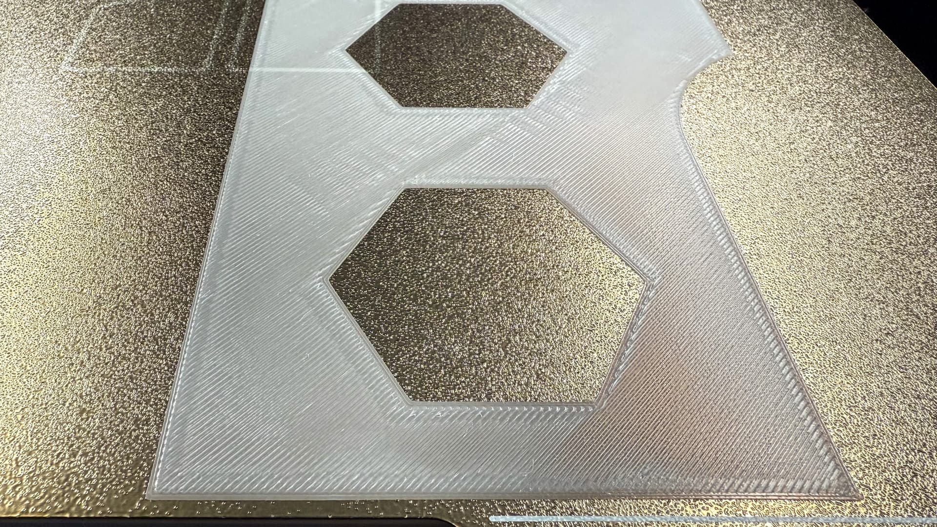

After the complete calibration (including the high-temperature bed leveling) it does indeed look a bit better than before, but it’s still not at the level of the standard hotends.
However, it is not yet satisfactory for a 2000 euro device with these hotends.
I’ll let him finish the print now and then take a look at the end result.
Vision encoder only affects x/y as it is just automatic skew compensation. For it to be effective in Z, it would need to travel the whole Z distance (which it doesn’t) to account for different height anomalies (bent screw rod for instance).
Printing is finished, quality is okay, nothing more. Much better with a standard hotend.
Start the same print again and the first layer is worse again. Not as terrible as at the beginning, but worse than the previous print.
