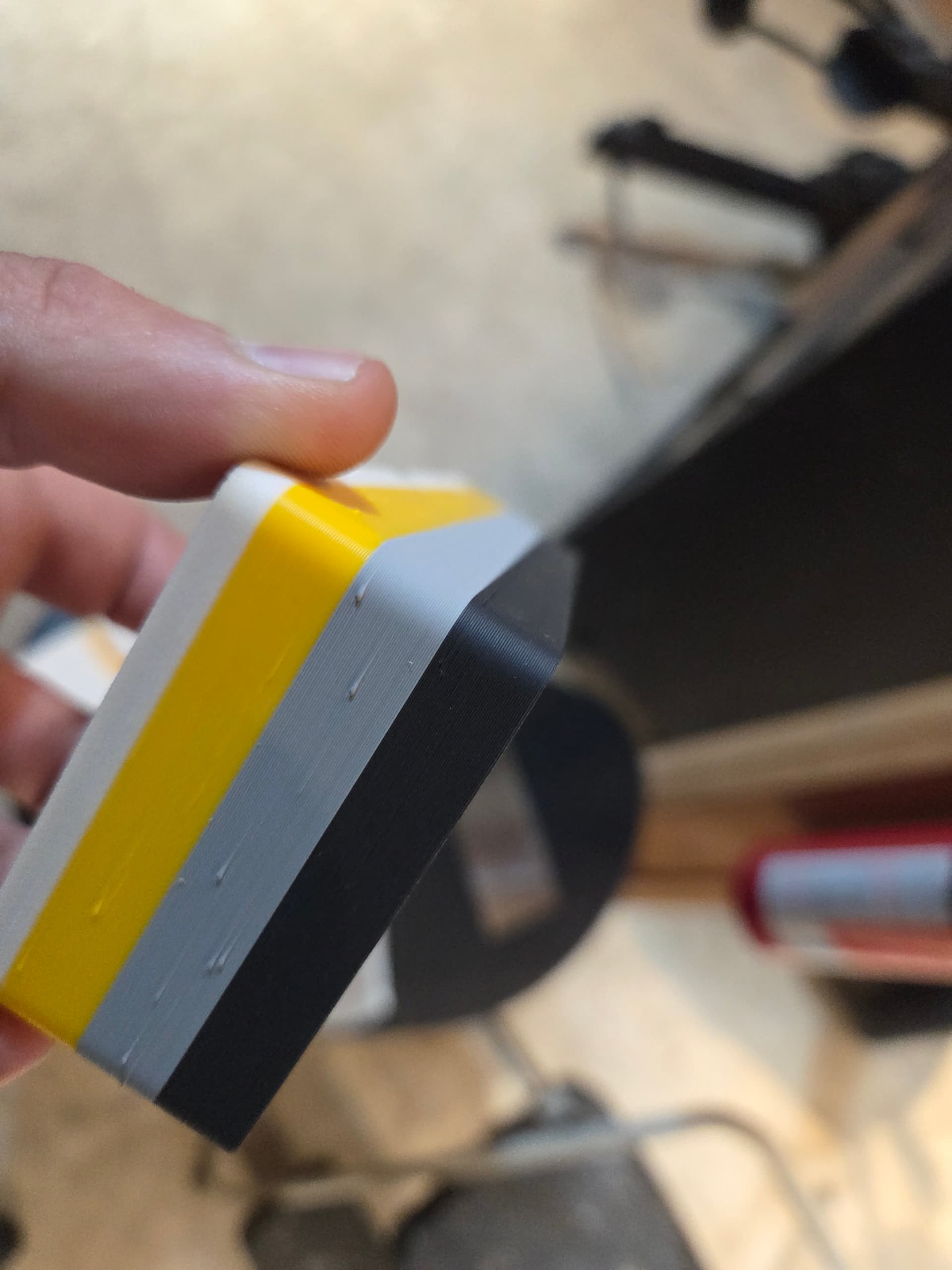

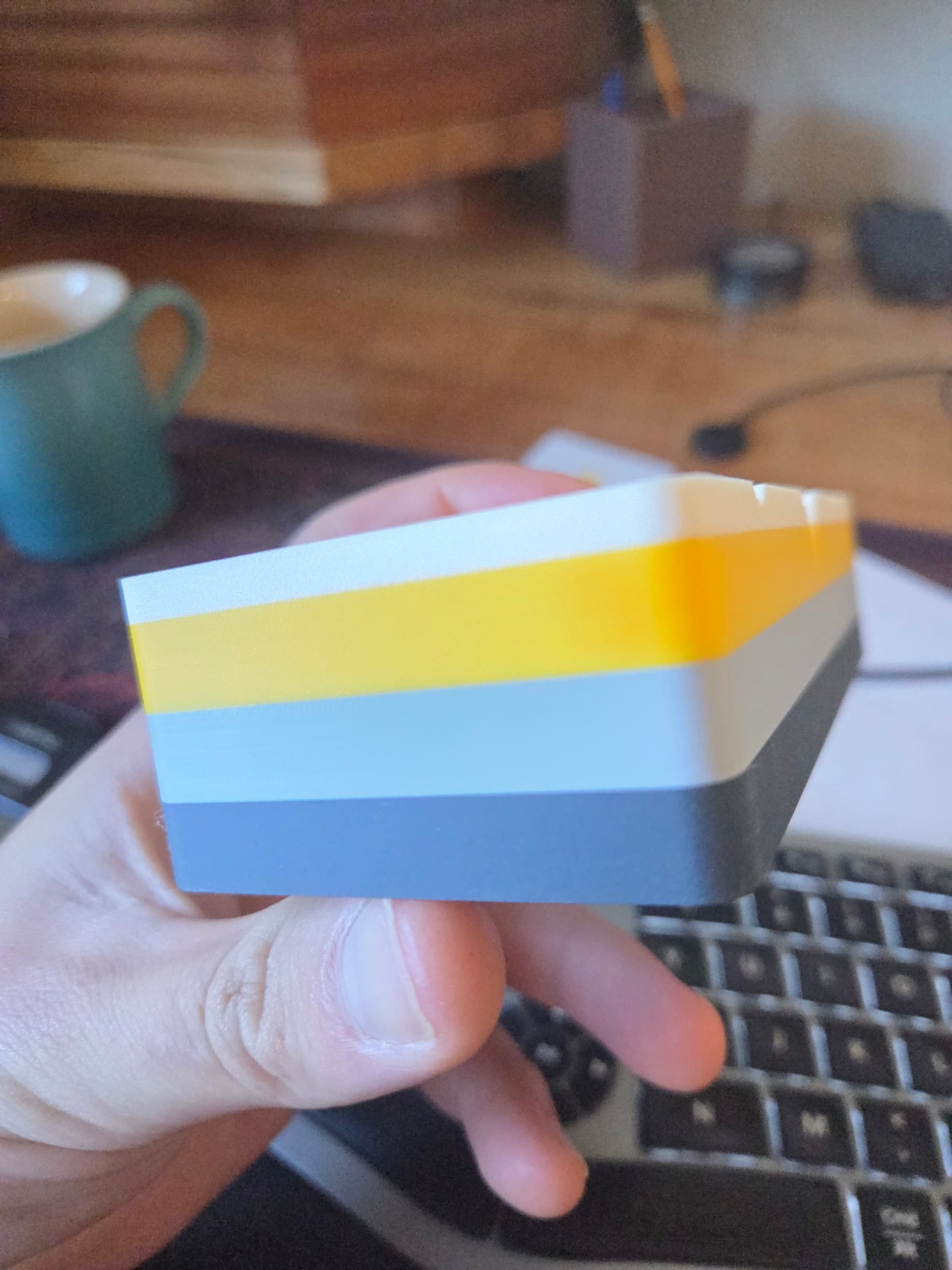

I have printed this object MANY times with zero issues (see first image), then out of the blue I started getting zits/blobs on the side.

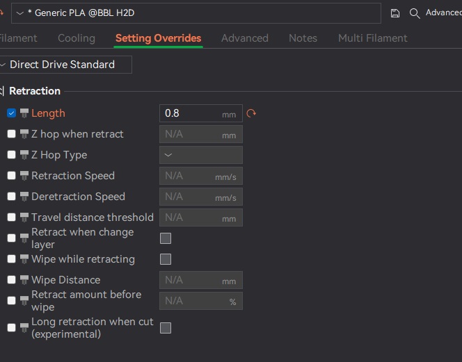

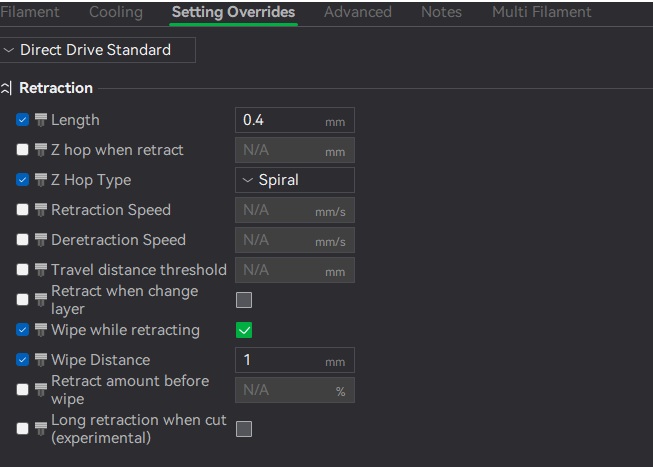

Im curious if the default retraction length of 0.4mm was recently changed in the recent software updates? I am going to up it to 0.6mm or 0.8mm. It seems that generic PLA is set to 0.8mm while bambu PLA is set to 0.4mm. Not sure why this is the case.
Yes the filament is dry (dried for 12hrs on AMS and again on a esun filament drier) same zits/blobs. I want the seam position to be random.
I swapped the nozzle with a new one in case that was the issue. I’ll let everyone know if that does anything. Anyone else have this random issue come up?
