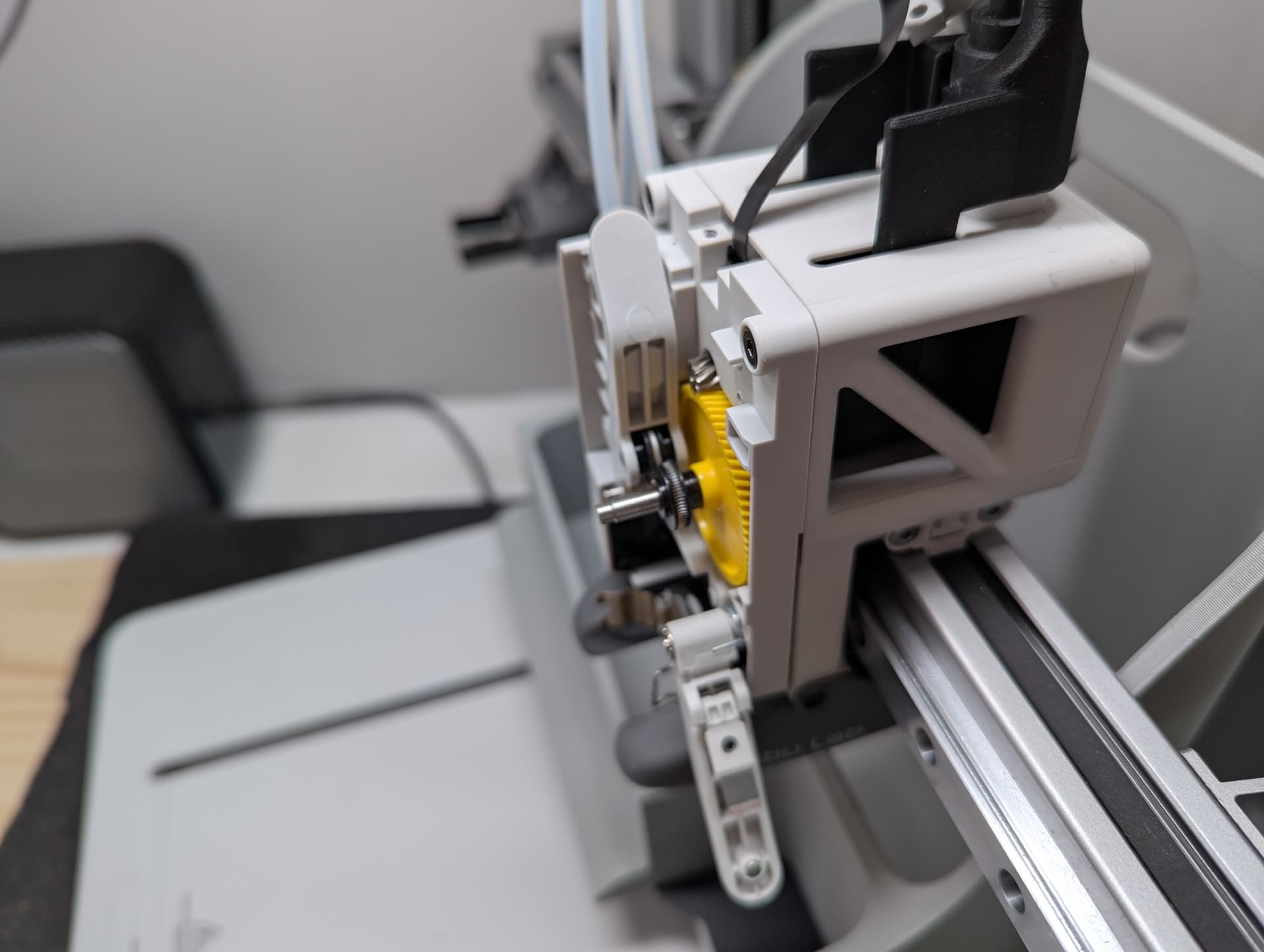

I have 2x 0.2mm nozzle for my A1, one old, one new. I wanted to use my used one. It jammed at some point and was unable to extrude. I thought it was a clog or something, tried a calibration flow, work fine for plan white, but it clogged when switching to black PLA.
Thought it might be the nozzle being too old, I switched to the new nozzle. Started the calibration flow and it clogged exactly at the same place.
Now I am stuck with 2 clogged 0.2 nozzle, both seeming fine (not worn) and no grip to do cold pull or anything else. Any suggestions?

Since you experienced 2 clogs in a row during calibration, you may want to check if there is dust in the extruder gears that is travelling to the nozzle.

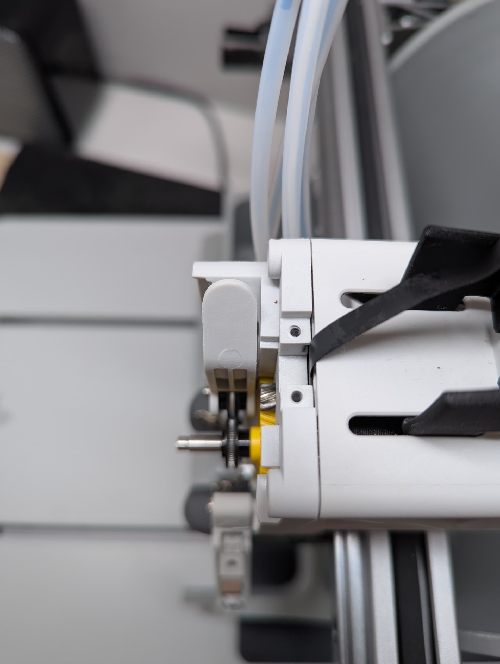

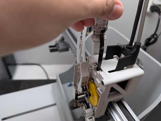

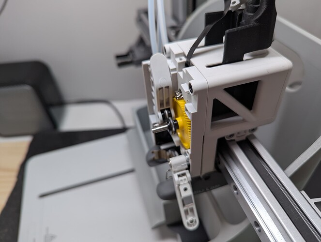

And following the disassembly of the extrusion module, nothing seems strange
So filament sensor it might be.
