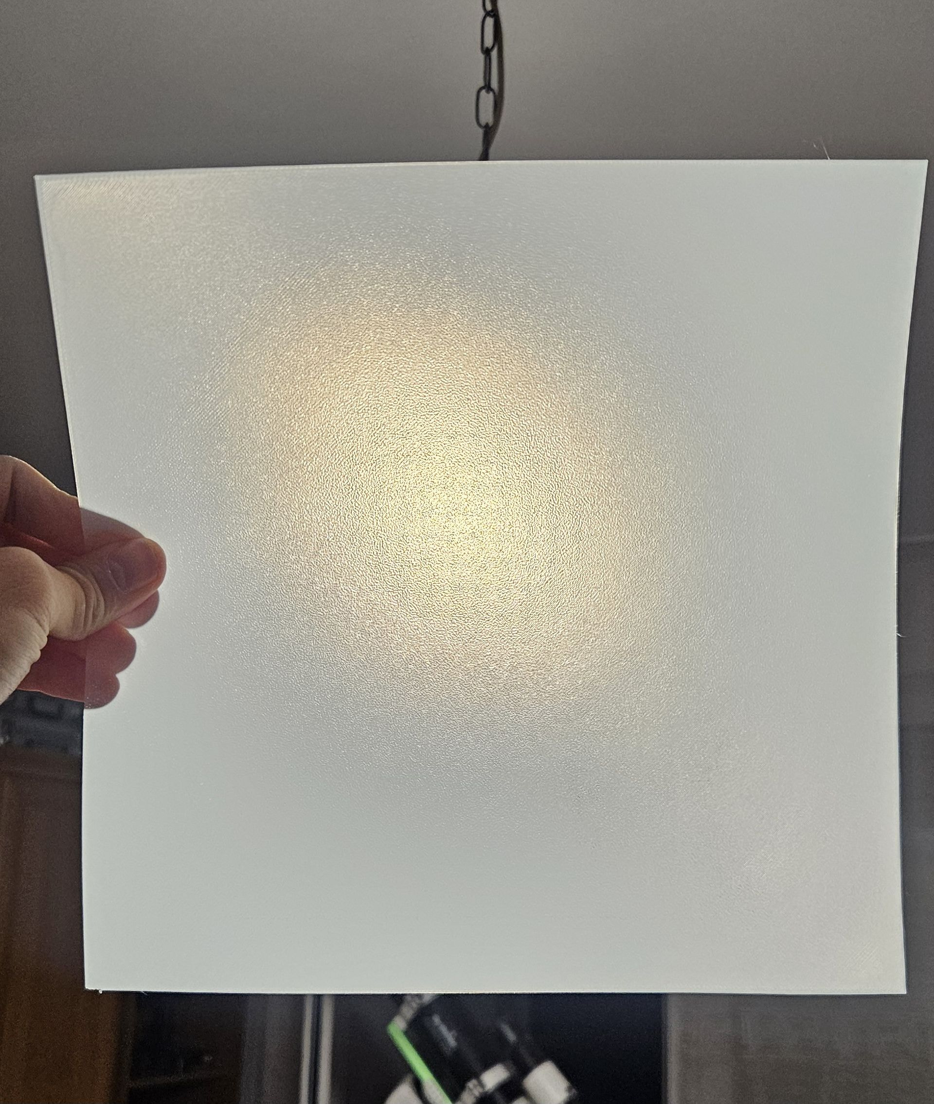

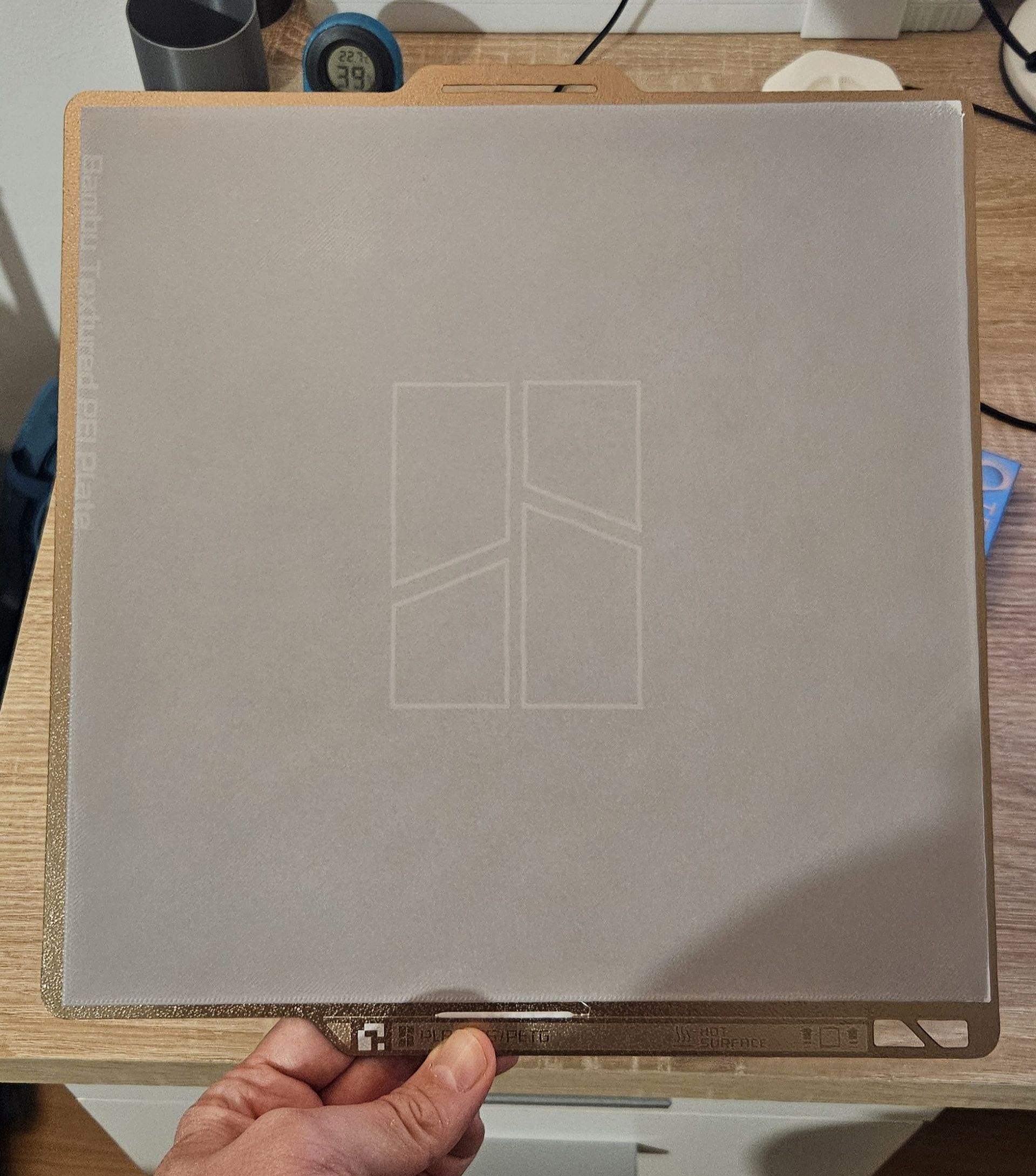

Here are the photos of the first layer test on my Bambu Textured PEI plate.
To answer your questions:
  • Filament calibration: Yes, by full calibration I meant I calibrated the filament as well (flow rate, flow dynamics). I am using Sunlu HS PETG, which I had already fully calibrated prior to the update. It was printing absolutely flawlessly with these exact same settings right before the firmware flash.
  • Why it’s obviously a low nozzle: If you look at the photo where the print is held up to the light, you can clearly see translucent, almost paper-thin patches in the center and on the left. The nozzle is physically plowing through the extruded PETG and squishing it so hard against the bed that it creates these transparent spots. Other causes like under-extrusion would leave gaps between lines, but here the lines are completely smashed together and overlapping due to the lack of vertical clearance.
  • The firmware connection: Interestingly, as you can see on the other photo, the thickness changes drastically towards the edges of the plate. It seems the mesh compensation or the bed leveling matrix got messed up or reset during the update process.
Even if the patch notes only mentioned TOS and time-lapse, it’s not uncommon for minor sensor thresholds or leveling algorithms to shift after a firmware flash.
What do you think looking at the photos?

I have to admit, I can’t make out anything in the photos except for the pattern of a textured printed plate. Maybe the photo is too strongly compressed.
I would try using the previous version of the firmware on the printer right now, doing exactly the same thing, and then take a photo of that as well. As a direct comparison. That’s probably the easiest and fastest way to solve the problem, as well as clear proof.

Thanks for checking GitHub, man! I really appreciate it.
You’re right about the photos—the compression must have eaten the details. In person, you can actually feel the texture difference with your fingers.

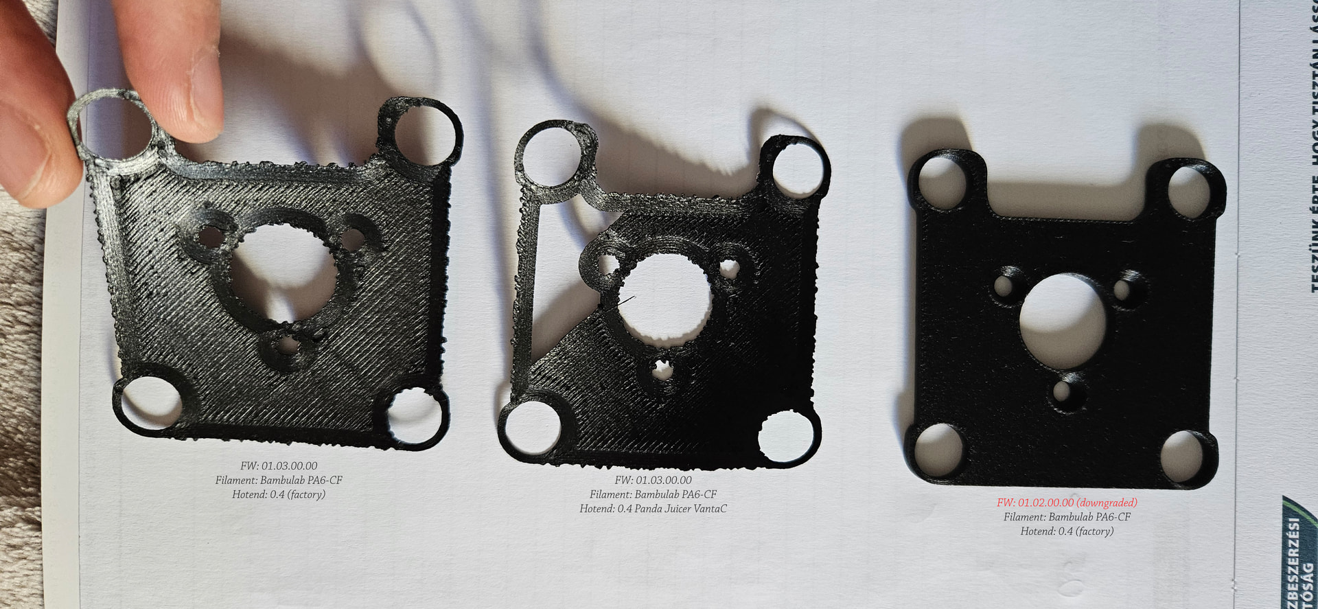

Hey man, just a quick update: over the weekend I tried printing a functional part with PA6-CF, and it turned out awesome after the downgrade!
As you can see in the photo, the one on the right (printed on the rolled-back firmware) is perfect, while the other two on the new firmware got totally ruined because the nozzle was riding way too low. The downgrade definitely fixed the bed leveling issue for me!
Honestly, I think the new FW is definitely buggy. It feels like they changed a lot more under the hood than what they actually listed in the changelog.
