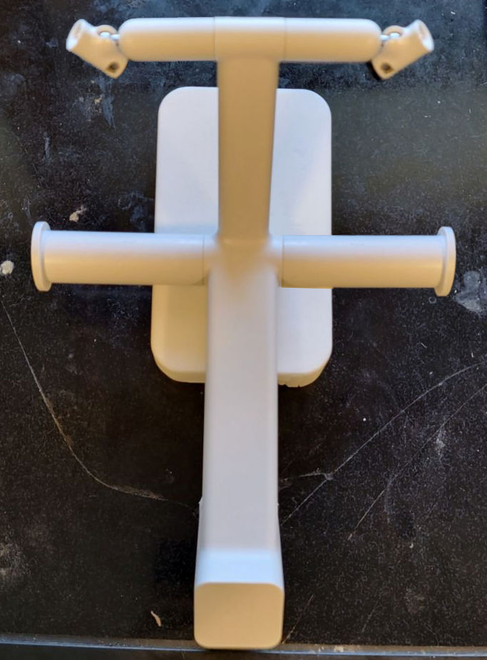

I made my own single-external into a dual and also use the AMS-lite. So I can get 6 colors without a lot of REEL swapping. Used parts from a 2nd arm that had broken and I received a replacement.
I then printed out a designer’s 6-into-1 nozzle top which allowed me to use the printhead without removing tubes, etc.
(EDIT: I have the A1 + AMS-lite)
